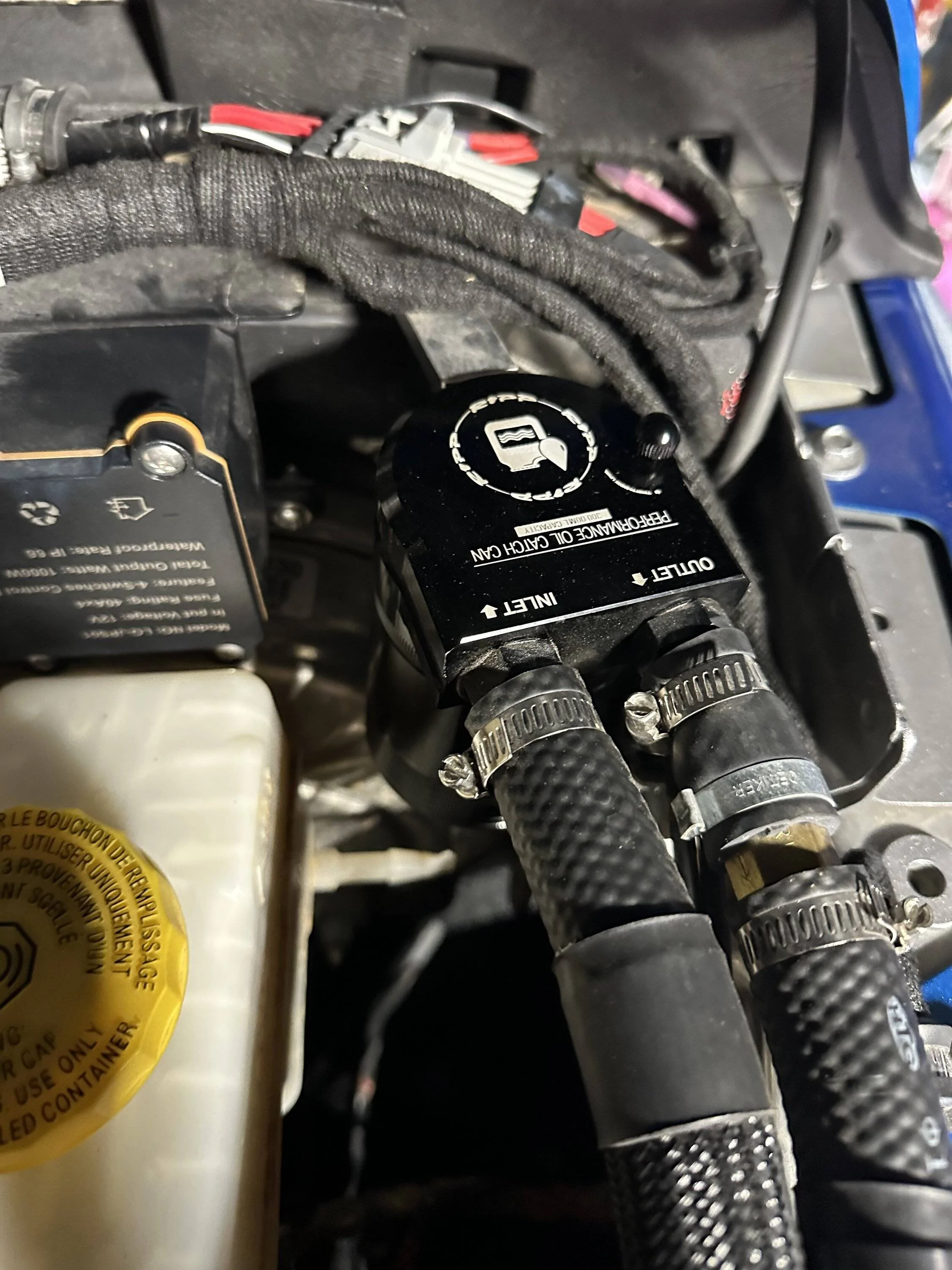

So what is it about the super charger that ups the oil capacity? Is it oil cooled?
It's not oil cooled. It's mainly because the pistons don't have a blower ring and the case pressure is much higher, so there's more blow-by and more being pushed out the PCV valve. The extra quart allows it to always have enough oil throughout the oil change cycle. The consumption isn't crazy or anything, but it is measurably more.
mgroeger
Feb 1, 2018
162
6,208
9,269
Southern UT
2021 JLUR 2.0T
Gonna run a catch can again?
