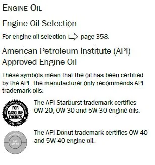

According to the owner's manual, 0W-20 is only "recommended." 0W-20 "can" be used if it is API Starburst certified.
From page 359
Jeep Wrangler JL 0W20 engine oil? 1751216294993-xr
Going to the reference page of 306, API Starburst certifies 0W-20, 0W-30, and 5W-30.
From page 308
Jeep Wrangler JL 0W20 engine oil? 1751216492097-cd
Sure sounds like using other than 0W-20 is not a problem, and deciding to do so should have have all the controversy or drama.
