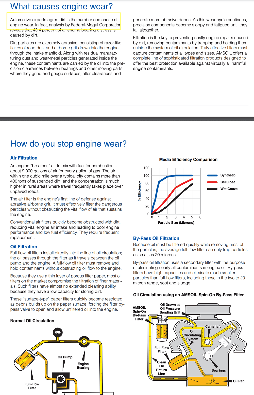

Not sure that I agree "most engine wear occurs at start up". I have read the "experts agree most engine wear occurs from dirt" i.e. contaminates. In the 3.6 that's looking more and more the cause of valve trouble with coolant contamination:
https://www.jlwranglerforums.com/forum/threads/unexplained-coolant-loss.119767/page-3#post-2631503

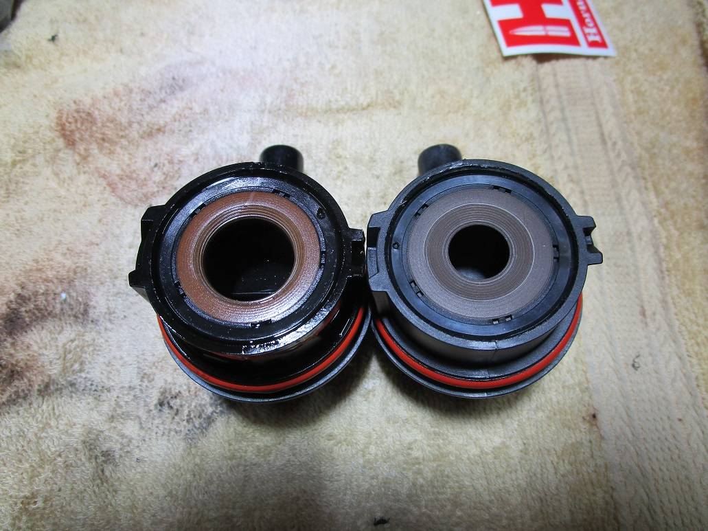

Two more things to consider ( can't remember if I told you about these )
About 4 months ago I installed the RPM Extreme JL fan controller. This is a game changer
It has lowered my coolant and oil temps about 25 to 30 degrees and reduced the amount of oil that my oil catch can collects
I used to see temps up HW80 to Lake Tahoe pushing 235 degrees
After fan controller same trip topped out at 212
With the fan controller average driving I am run about 188 to 195 degrees
I just installed the updated PCV valve and have another 500 miles to go before I drain and check to see if it reduced the amount of oil in my catch can ( see pictures. New one on right )
I will keep you updated
Did you ever come to any conclusions about the new PCV valve design? Trying to decide if I should upgrade mine.
Thanks.
Willys41
Larry
Nov 2, 2021
1,171
1,314
Pleasanton Ca.
2020 Jeep Willys
Thanks.
Changing out the PCV valve with the updated one made NO difference in the amount of oil that my oil catch can collected.
Before and after the switch oil that was collected was exactly the same.

Thanks! That saves me a minor headache as I was thinking of swapping it out.
