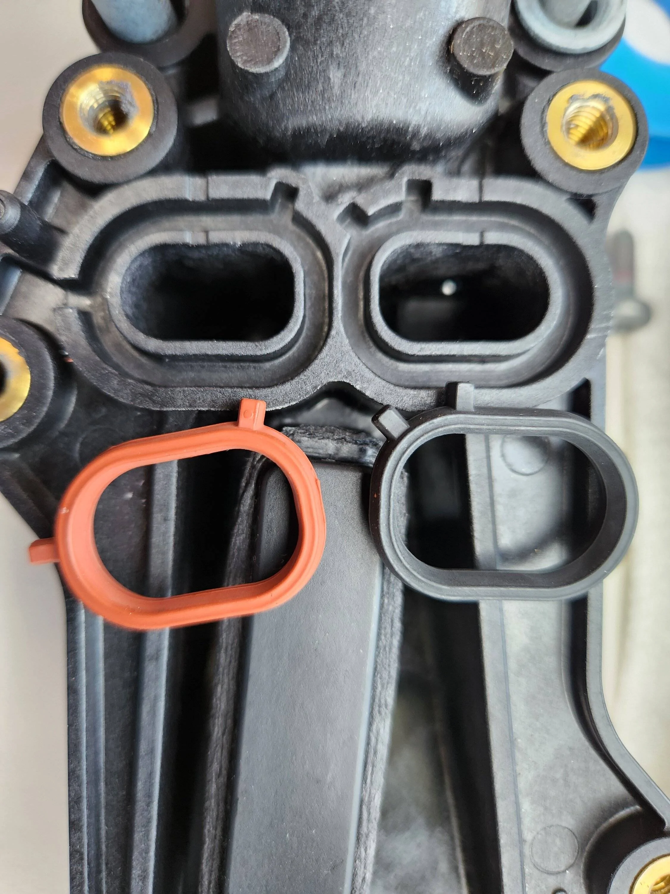

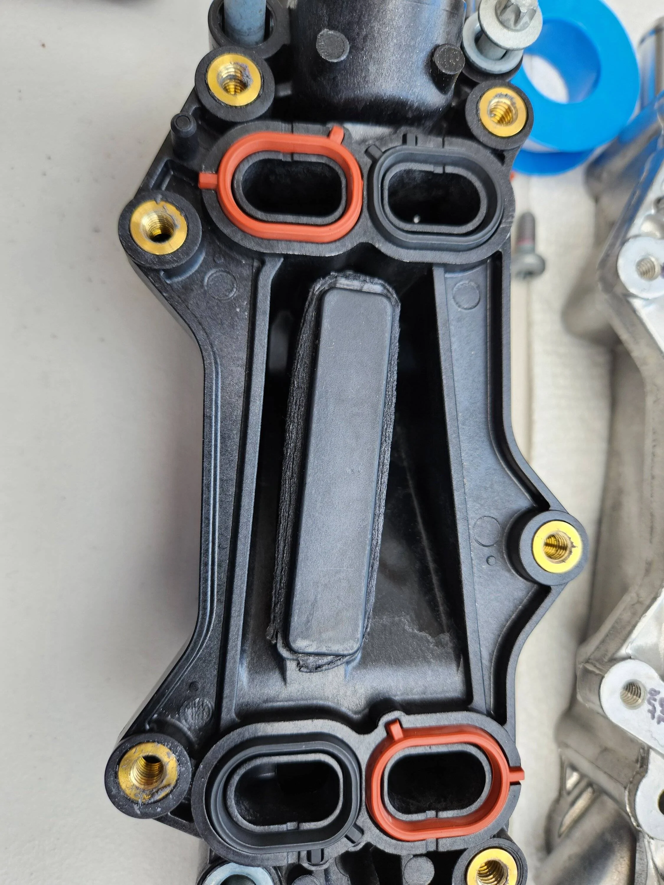

Brian,
I had several ways to go, including the Dorman aluminum housing. I ordered a new OEM oil filter housing (w/cooler) and was going to rob the cooler off of it along with the seals that seal the cooler to the housing. Upon removing the cooler from the housing, I found Mopar has revised the housing (again) and now it has a web between the oil and the coolant ports and separate seals instead of the one piece siamese figure 8 seals. So, I elected to go with the newest OEM 68596318AB housing/cooler assembly.
Assuming this fixes my problem (and that's still an "IF"), If this taught me anything about the 3.6L, it's that I'll do oil analysis religiously at every oil change. All you 3.6 folks should do the same.
This makes me wonder if oil dilution is behind the rocker/cam issues of the Pentastar, even after they redesigned these parts extensively.
Jeep Wrangler JL Unexplained Coolant Loss New 68596318AB cooler 1

Maverick909
Jan 15, 2019
50
5,249
7,384
I.E.
www.instagram.com
Brian,
Keep us posted. These are things I like to keep in mind with the 3.6. Eliminate problems in the future like the rock/cam issue
