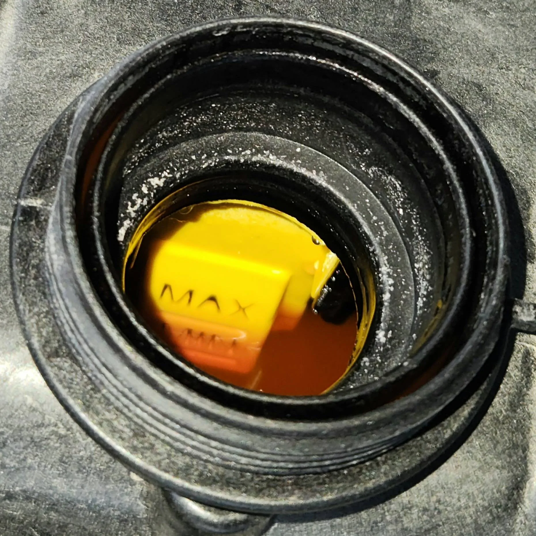

I see you have the 3.6, but just for reference some of us have experienced mysterious initial and ongoing coolant loss with the 2.0LT. It seems many need to add a significant amount after a few thousand miles, then the loss tapers off.
Mine seemed to stop losing coolant around 15K or so, but still continues to go down ever so slowly.
Our coolant reservoir is opaque, so it more of an issue for us unless ones checks it constantly (which sadly, I do now out of paranoia)
We 2.0'ers also have a catastrophic coolant loss issue tied to a couple factory mis-torqued bolts to add to our plight.
I'll be interested to hear how yours in doing in 6 months. Good luck.
