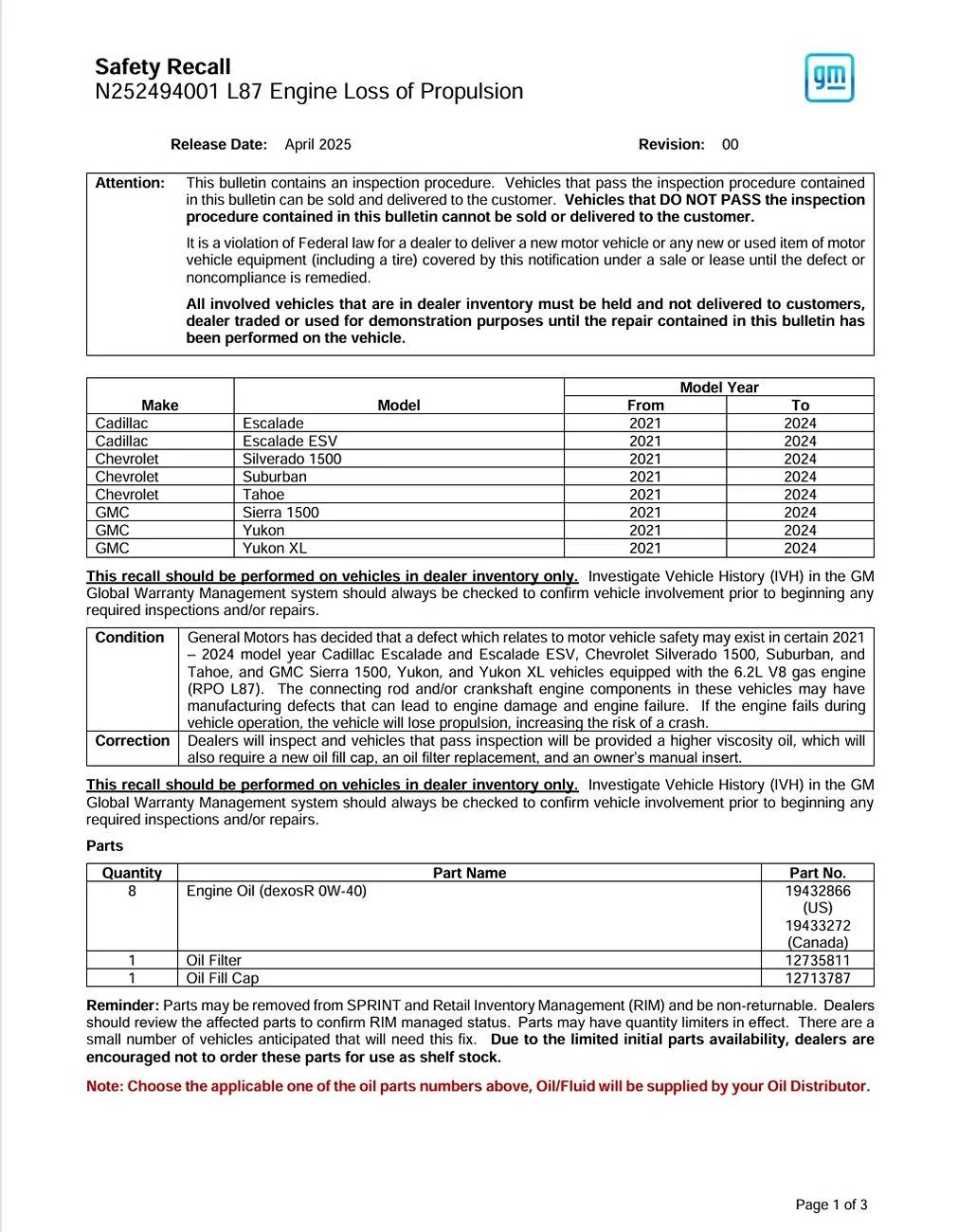

GM recalled their 6.2L. Dealers are instructed to check for engine issues and if none are present at inspection then they instruct the dealership to change the oil from 0w-20 to 0w-40 and put it back on the road. Hmm.

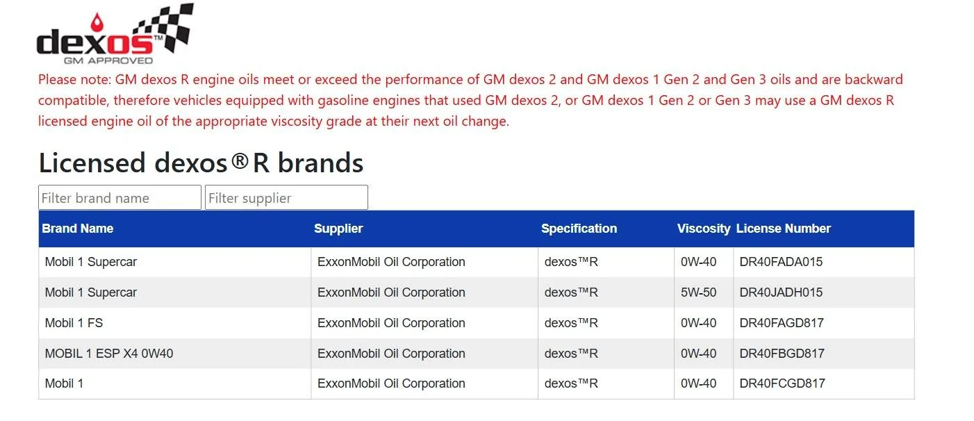

And the only oil spec'd is Dexos R which is in the list below. The M1 Supercar 0w40 I have in my 3.6L JL is on the list.
Jeep Wrangler JL 0W20 engine oil? GM 6.2L pg 1 of N252494001-Bulletin.pdf
Jeep Wrangler JL 0W20 engine oil? DexosR
Jeep Wrangler JL 0W20 engine oil? Supercar

What I find particularly hilarious regarding this newly announced recall/stop order for EVERY GM L87 6.2L gas engine (2021-2024), is that...
After passing the dealer inspection of said engines, the technical bulletin instructs the dealer tech to replace the oil cap with one that calls for 0W-40, (on an engine that previously required 0W-20)...
Could mean absolutely nothing for us, but really makes ya think 🤔 😉
