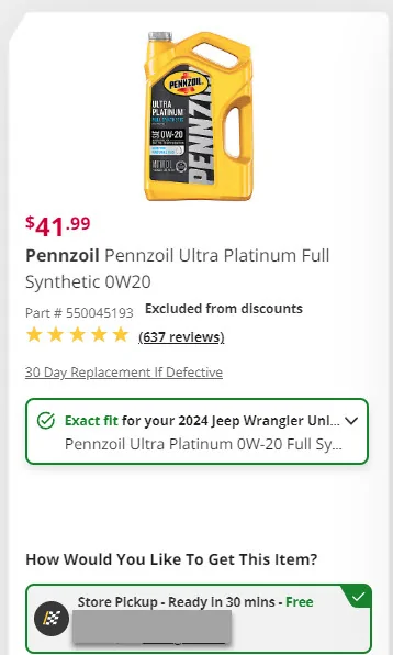

I get mine at advanced auto
Ahh good call. I just checked their website and it says they carry near me. Dummy me only checked Walmart, Pepboys, O'reillys, and Autozone. We have too many auto stores within 5 miles lol. Looks like Amazon is cheaper though. But good to know it's local. Thank you!

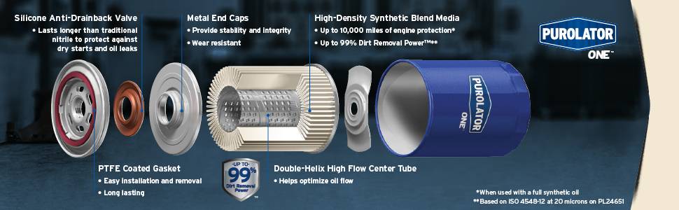

For you unbelievers in the Baxter adapter
Simple test
Let you jeep set over night
Remove the oil filter housing cap and pull the filter
What you will find is NO oil in the filter housing and NO oil dripping from the filter
All the oil from the filter housing / oil cooler has drained back to the oil pan
There is NO check valve in the factory filter housing
When starting your cold 3.6 you have to fill the filter housing AND push all that air through the oil galleys
The Baxter has a check valve and also the spin on oil filter has a anti drain back valve
This is not rocket science. Its gravity. Liquid will flow to its lowest point if allowed to do so
Here is a picture of a oil filter showing the anti drain back valve
Simple test
First off, I am not an unbeliever, just undecided and don't want to spend almost $350 on something if I don't need it.
Second, you and and @CarbonSteel all ready had this discussion, and you reported you found about an additional cup of oil after pulling the filter (we know the filter is dry, were talking about some trapped by the small O ring).
I was reading the comments on the Northridge video, found this:
"As soon as I heard the rocker/lifter tick on my 2013 JKUR, I stopped driving it and a few days later I did the work to replace all of them with the new "improved" rockers and lifters. Guess what? After sitting for several days, the rockers and cam shafts still had a coating of oil on them."
So again, I'm not against it, but why do I need it if there is oil on the rockers, there is at least some oil in the filter housing, and my engine puurs like a kitten on cold start?
Lastly, we know the oil cooler leaks are coming usually not from cracked housing but the seals drying out from repeated heat/cooling cycles and possibly from leverage when doing oil changes. Even being extra carful, it's almost impossible not to cause the cooler to move from side to side when removing the oil filter. Does the Baxter help that by making the filter easier to remove with less torque or is it hurting it by increasing the leverage on the OC?

You all can do what you want put common sense would say
A empty filter housing and oil cooler is not a good thing
I have changed thousands of oil filters in the last 50 years as a mechanic and 99.9% of the time oil will pour out of the filter when it is removed. Not so on the 3.6. It is empty. Completely empty
As far as the $350 cost. Drop it the bucket compared to my other mods
Bead locks and tires $6000
Gearing & 4.5 lift 2.5 shocks suspension part $9000
Drive shafts $1400
Delta brakes $2500
Bumpers winches recovery gear $2500
Inside and out side mods $4000
Just a few that I can remember
$350 to keep your oil filter full of oil. I can deal with that
