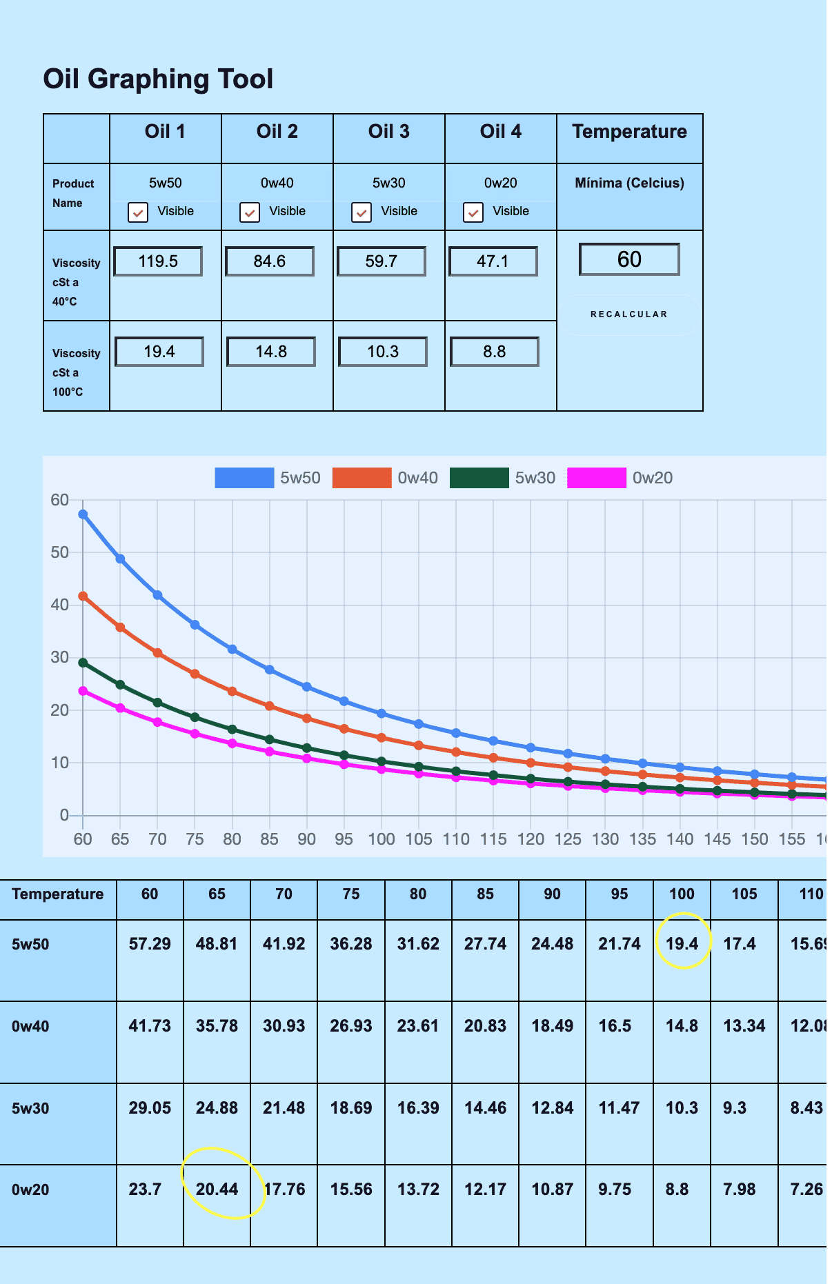

To answer your first question, I am a bit skeptical that most engine wear occurs on startup, except in specific situations. It would depend on so many factors. On a well maintained engine, perhaps that's true, in which case if the engine was well designed it would last hundreds of thousands of miles until the start up wear caught up with it. However, that's not always the case. Dirt, grime, fuel, heat and viscosity breaking down would be a bigger factor. So selection of what oil to run, oil grade, choice of oil and air filters, OCI and heat management I think would be far more significant factors.
Regarding oil grade, since viscosity is temperature dependent, any grade can be any viscosity given the correct temperature for that grade. The bottle of 5w50 can be thinner sitting in a very hot car than a bottle of 0w20 in the same car on a cold morning. So it all depends on temps.
If you examine the circled values in the first chart below, you will see that all four grades have about the same viscosity and the difference is the ambient temperature, in this case about 5C difference per grade.
Once the engine is warmed up, the higher grade will be at the same viscosity as the lower grade 10-15 degrees C lower. (Second chart).
