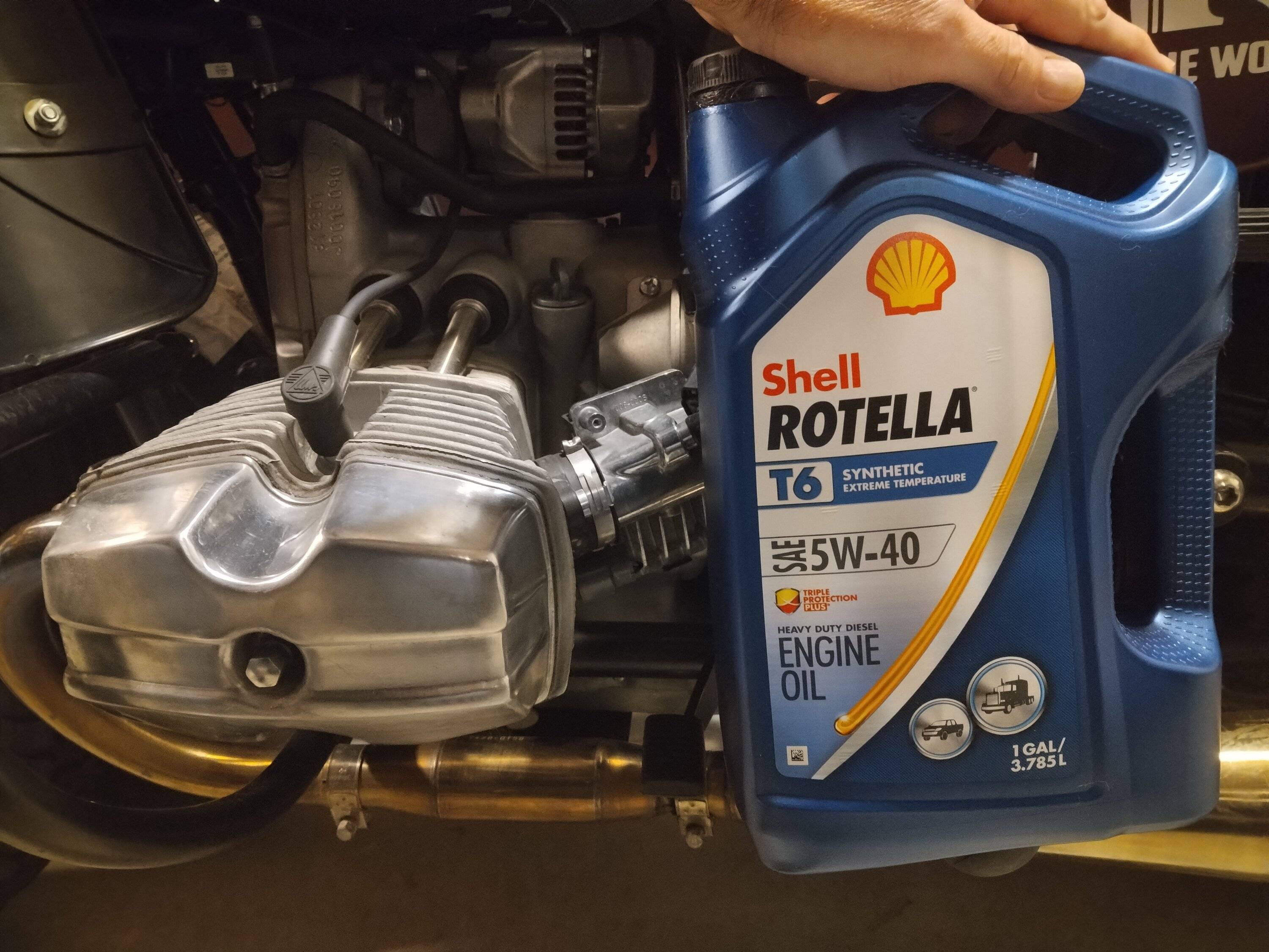

Anyone running Rotella 5W40? Wish it came in a 5 qt jug.
That's the winter weight oil specification for one of my motorcycles, for use only when the mercury doesn't rise above 50°F. It's sold in gallon and 2.5 gallon jugs at Advance Auto and elsewhere.
