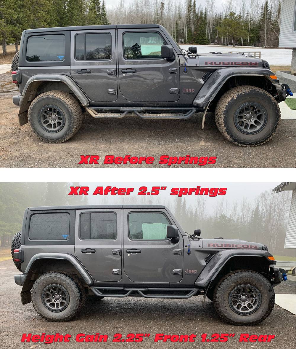

I got a set of MetalCloak DuroSpring bumpstops to put in tonight as well as 3.5” RK triple rate springs for the front to replace the 2.5”. That heavy ARB bumper brought the front down too much for the 2.5” springs.
Stay tuned.
I’m not sure if I posted this comparison here before but here are the measurements I got after putting the 2.5” Springs with a much lighter bumper and winch.
