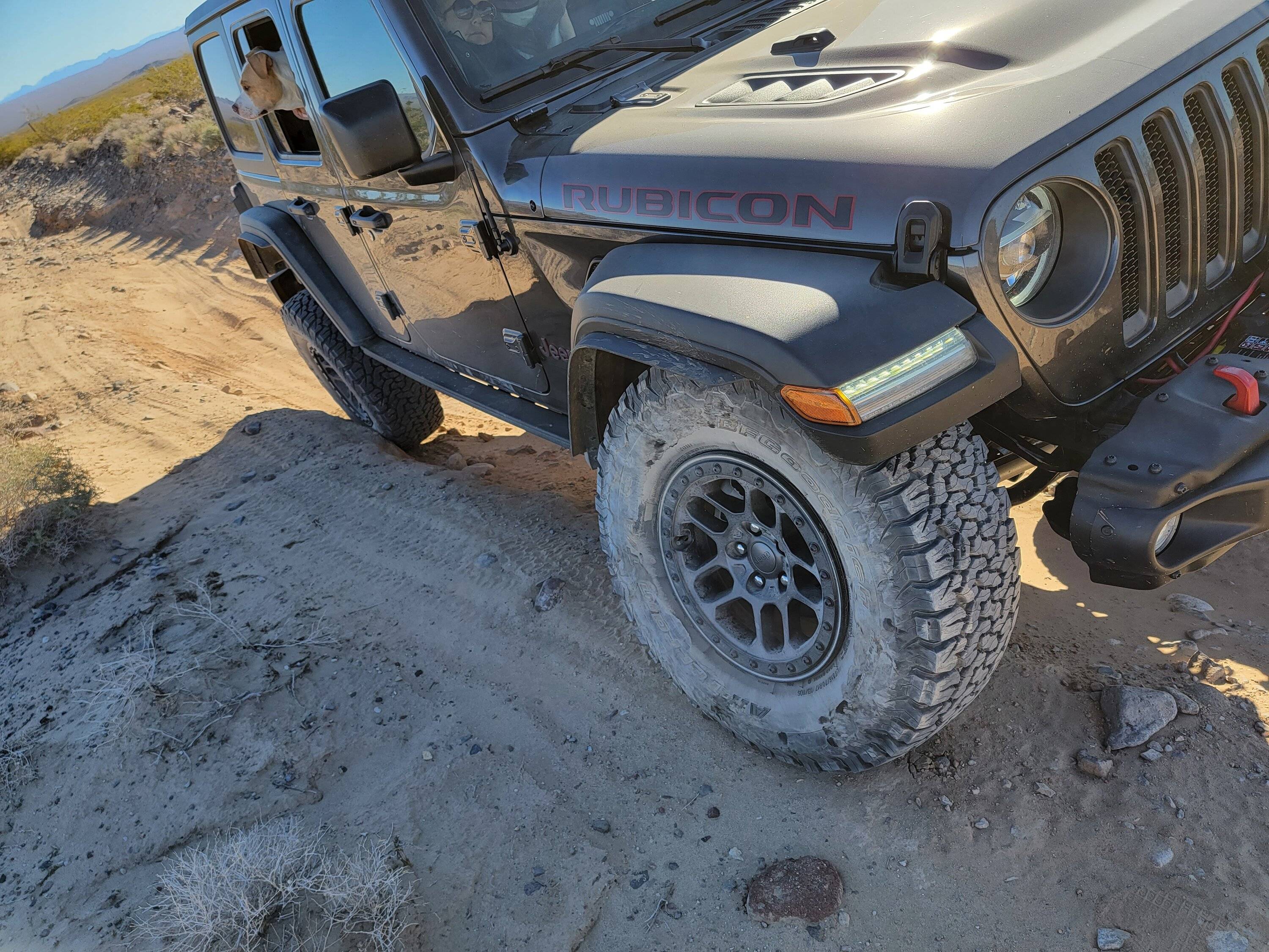

Correct, however the front bump towers are welded in. Removing the spacer in the rear is absolutely doable. The front would require cutting and either welding in new stock style bumps or swapping to hydraulic bumps. Adding a 1" spacer is the easiest way to gain uptravel. As far as shocks, in my opinion the stock ones are already too short, adding a spacer only further limits down travel. Aftermarket shocks and a 1-2" spacer are the easiest way to get the suspension really working on an XR. $600 in parts and now she flexes.

Yes, you could shorten the bumpstop to get more uptravel. The next step is making sure the shocks you have also have a short enough compressed length. The bumpstops also protect the shocks from bottoming out.
In the big picture if you put a longer shock on and increase the lift 1” you have effectively increased your uptravel by 1” from your new ride height and with longer shocks also increased your droop.
Your flex is ultimately limited by your shock travel.
