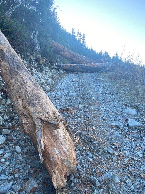

-Out on the farm and there's a big tree down? Hang on. I'll grab the jeep and pull it this way or that so we can get to it easier with the saw
I could have used your help the other day!

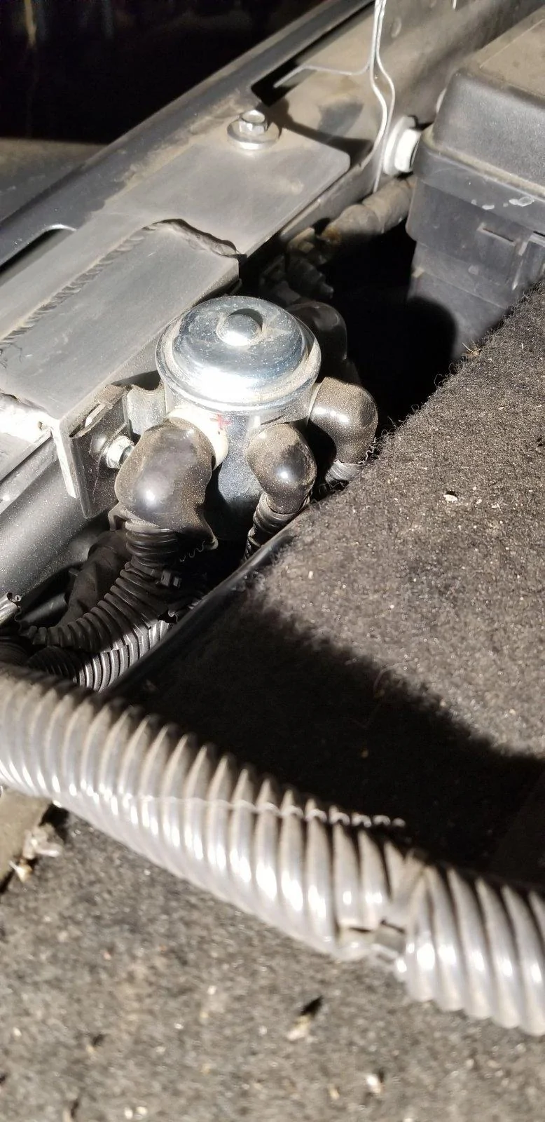

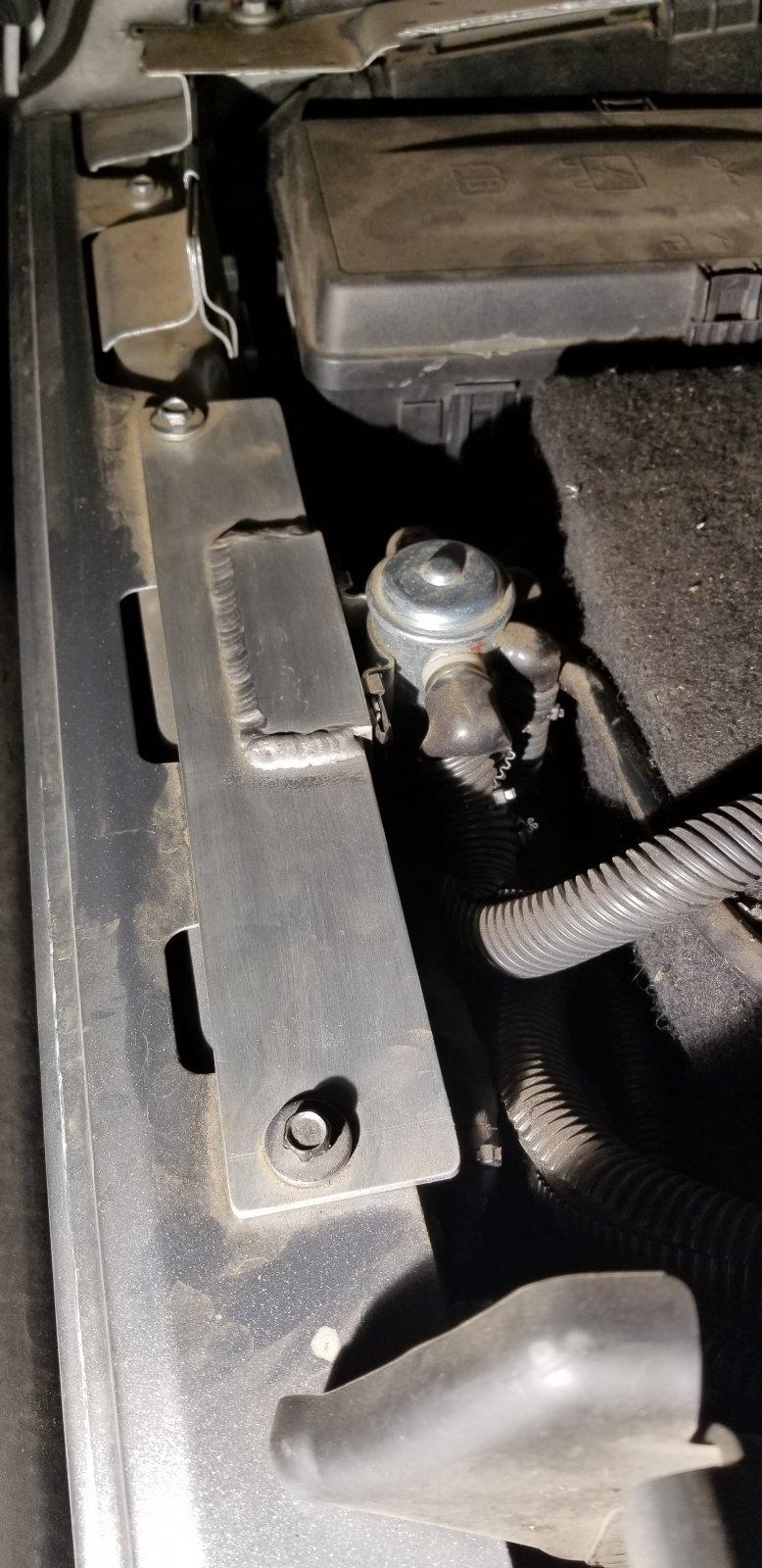

The warn solenoid kit its really easy to install. I just made a bracket to hang it on out of aluminum angle. The electrical hookup is a no brainier.
I have a Warn VR10S-Evo and Warn solenoid kit on the way. Can you post a photo or two of the aluminum bracket you made/mounted?
I didn't have any aluminum angle left that was long enough to fit between the two factory fender bolts, so I took that flat piece and welded the last chunk of angle to it. But if you went to home depot and got a 2 or 3 inch angle you should be able to do what I did without any welding ;-)
Jeep Wrangler JL Winch Winch Winch 20201125_152205
Jeep Wrangler JL Winch Winch Winch 20201125_152242
At some point I do want to move this setup and all my custom wiring to the back of the engine compartment. I have some terminal strips that I want to run the power to for my halos and HAM radio and so on. Basically everything that is connected to my accessory switches. The solenoid is where it is because it is connected to the factory accessory switch wiring which is bundled right below the solenoid. So I was lazy and put this there.
But there isn't a lot of room for other connections there, hence wanting to move it all to the back of engine compartment by the firewall.
