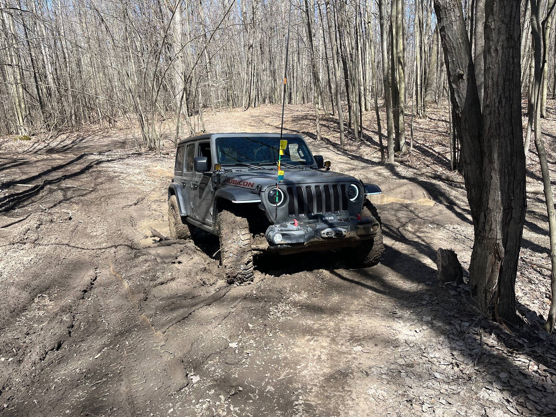

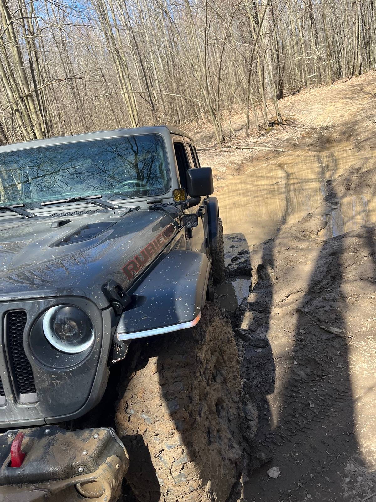

I’m running the badlands winch. I have had about 5 recoveries in the last year and it has done a great job.
Sunday it pulled me out of a mud hole that went half way up my doors. It was solid

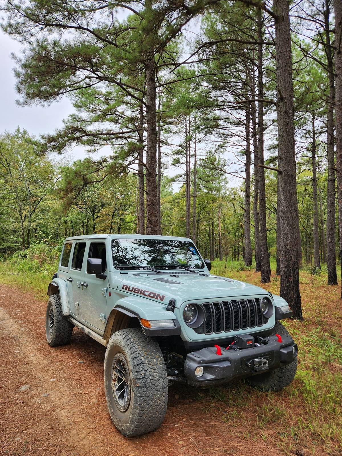

I use Openroad4x4 winches on everything. I have them on both Jeeps.
Jeep Wrangler JL Winch decision … 20240123_153524
Jeep Wrangler JL Winch decision … 20230912_154946
13k, wireless remote has great range and seems very reliable. You can get them for $369 when they have a sale which is often. The control box mount sucks but easy to modify up one.

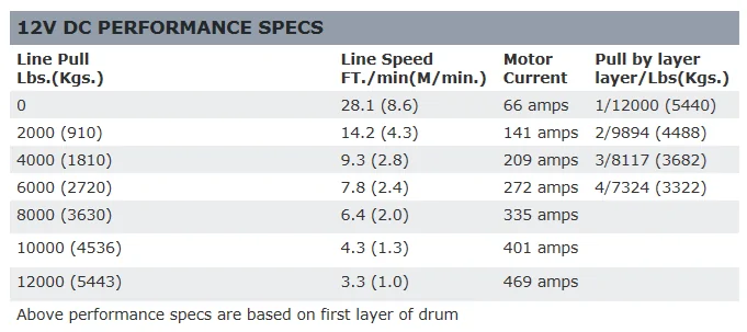

Hello everyone, i am pretty sure this has been asked before but what winches are out here to consider around $600 . I just got the Arcus front bumper installed and got to make my mind up on the Winch. I am all over the place Rugged Ridge , Badlands, Super Winch, Rough Country ect. And 10000 should be ok or 12000.
Thank you in advance!!!
One thing to consider: the pull rating is based on the first wrap of cable on the winch - basically with the whole cable extended. However, you lose about 1,200 - 1,500 per layer of cable staying on the drum. so if you want to winch someone at 20 feet from the obstacle, you may actually have only a fraction of the capacity. This is why I went with a 12,000lb Badland Apex. This is the chart for Warn Zeon 12S. As you can see, pulling drops to 7,324 lb when you have 4 layers of cable on the drum.
Jeep Wrangler JL Winch decision … 1712932149056-ra
