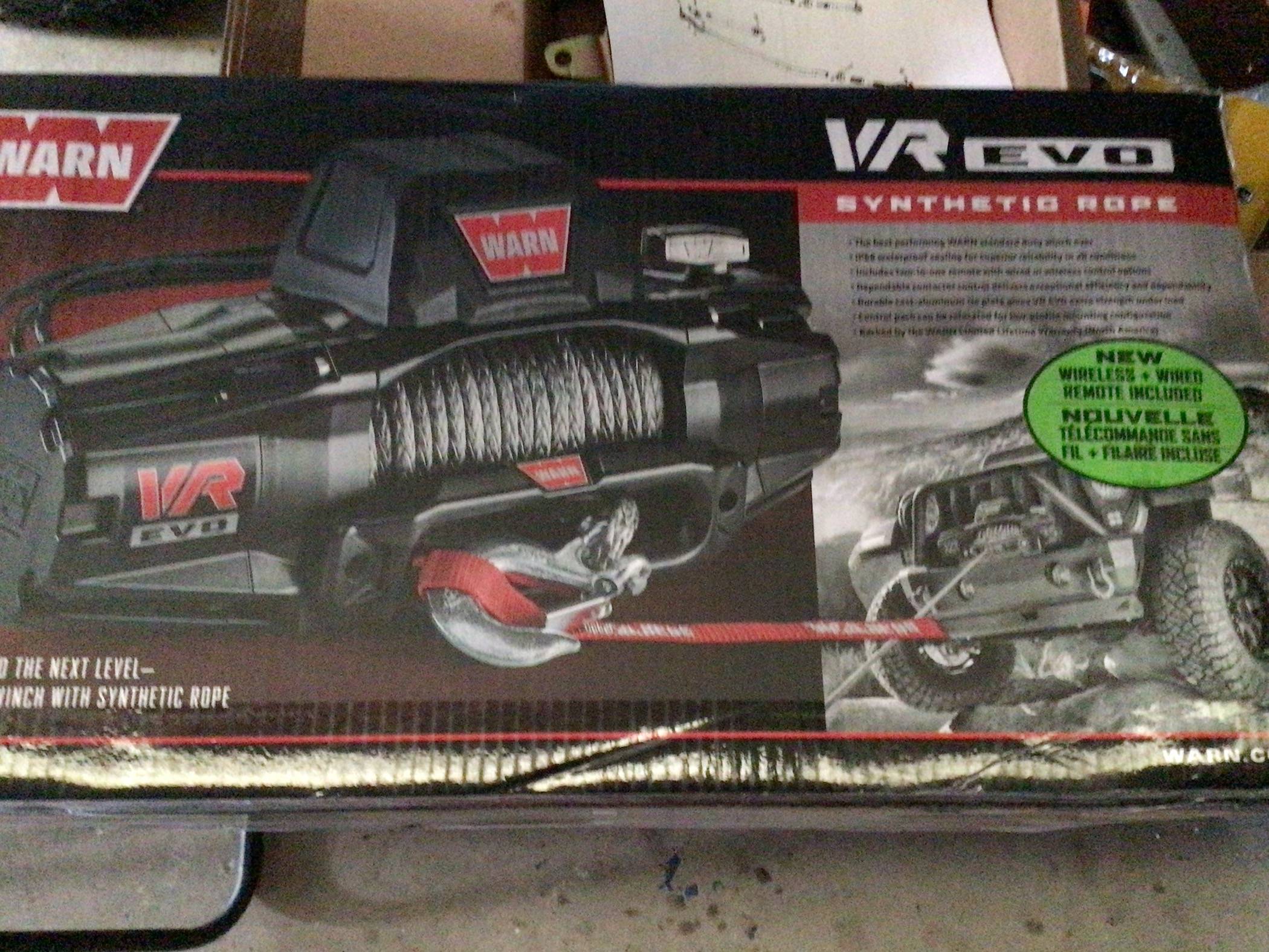

After standing at Harbor Freight two different times pondering the Badlands. I pulled the trigger on the Warn Evo 10, delivered today from JJs 4 wheel drive. Caught a store sale and the warn rebate. Price down in your range, also, surprise, warn evo has wireless and wired option now.
why warn? Because we abused these in the mud on atvs, with my son during his teenage years. Just clean the contacts, and keep using.

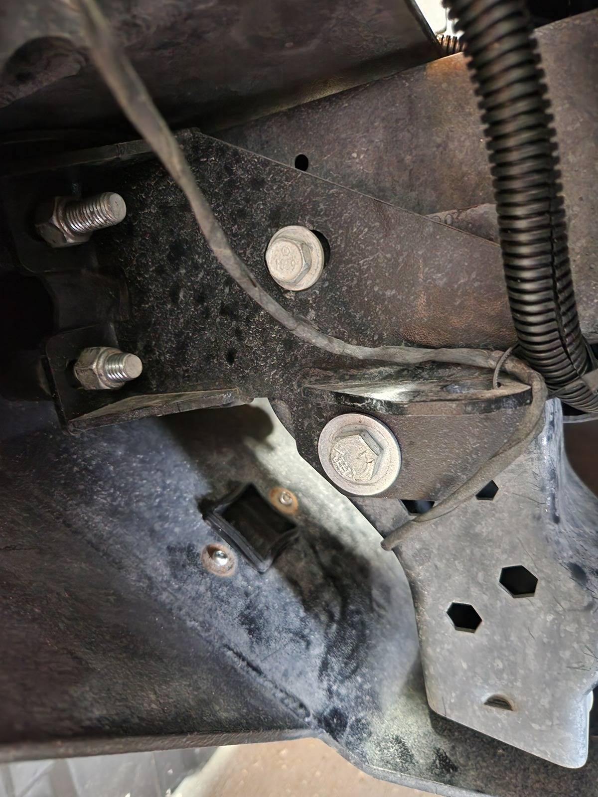

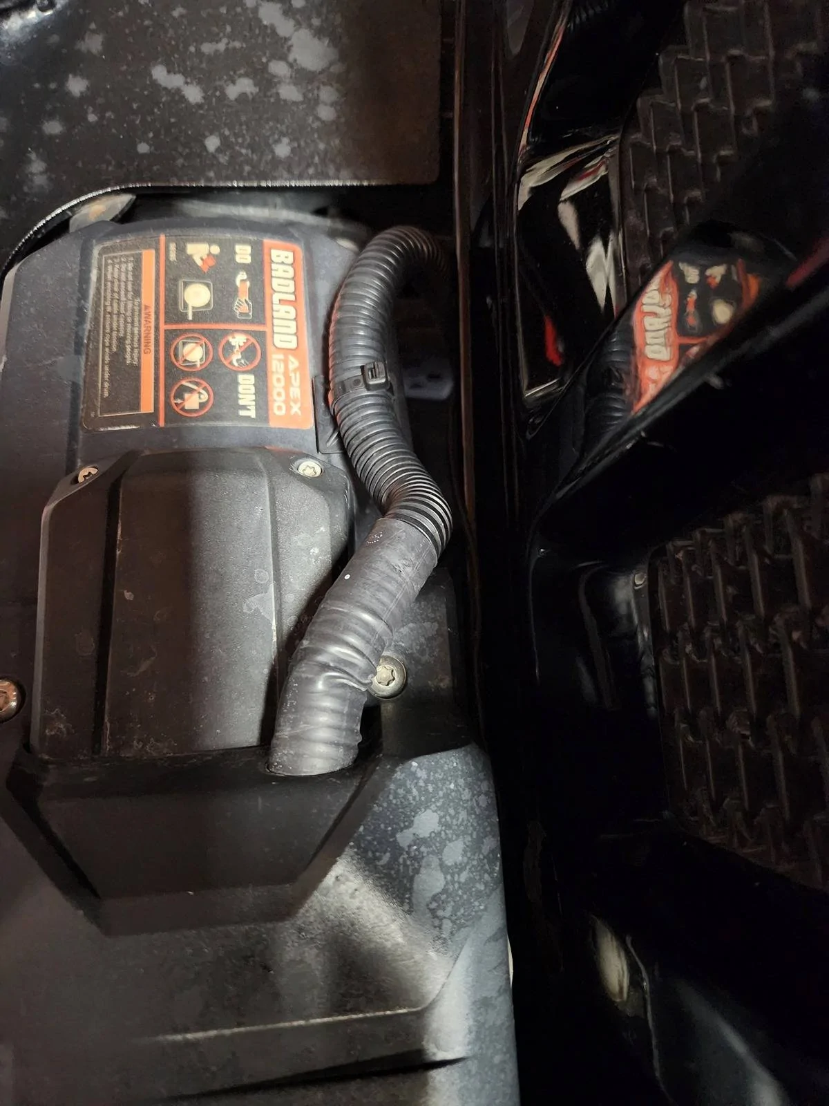

When installing the Badlands winch make sure you do both of the mods first. It may be the bumper I have (Rockhard 4x4) but there was no room for the cables that came straight out of the back. I cut a round hole in my grill. It worked but now I'm screwed if I need to remove the grill.
So I rerouted the thick cables from the rear to the side. That solved one problem. However now I still could not remove the grill. So onto mod number two.
I loosed the bumper bolts and slid the entire bumper and winch towards the front. I removed the grill. There are 6 tabs with clips at the bottom of the grill. I cut off the four center tabs and clips. Now the grill can be easily removed.
While you're at it add the outer thicker tie in plate. Thicker steel and one more bolt into the frame.
