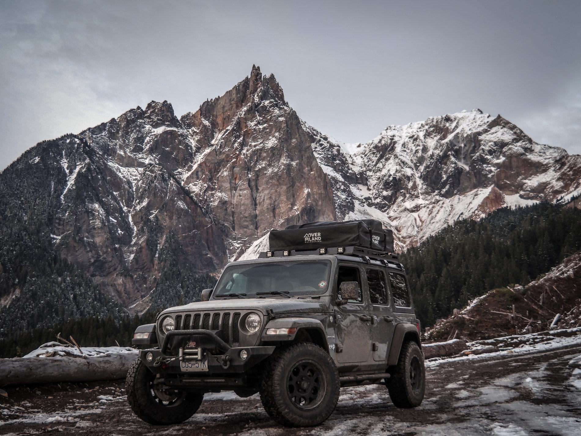

We run a smittybilt winch on our JL. Used it to get off a log and on a second occasion to pull a truck out of the mud. After recently moving to the city for work we still wheel on the weekends and it’s worth the 500$ if you don’t want to spend hours digging. When we go out alone we only drive over big obstacles if there are winch anchors around like trees. Obviously this is personal preference, but getting stuck does happen and it’s nice to have that extra tool to help yourself or someone that’s having a bad day. We live in BC Canada and the terrain varies, 2 days ago I encountered mud (used the winch) snow, ice and water, all in one day. I’d consider what terrain you’re driving on and like others have mentioned you should consider the frequency of use. Ours winch is for emergencies and a 500$ winch with a cover does the trick. If you’re planning on doing more then maybe a better quality Warn winch with synthetic rope and all the fancy stuff is better. We are pretty new to the Jeep world so this is all beginner info I’ve acquired over the past 2 years. Hope it helps.

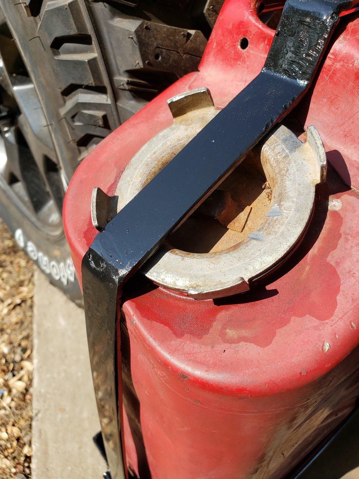

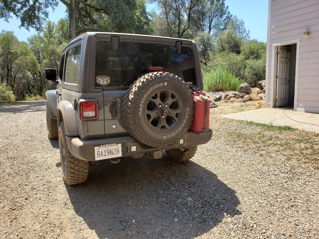

I also wanted to take an extra few gallons of fuel with me, but didn't want to mount the can(s) on the spare tire. I couldn't find anyone who sold the type of fuel carrier I wanted - so I made my own. The tail gate fully opens without hitting the tail light.
I also wanted to ensure that no one could syphon from my can, so I built the securing member to angle around the fill cap and it's lockable.
The extra fuel carrier mounts to the same mounting space as the original hinges - I did need to replace the factory bolts with longer ones due to the extra length of the carrier bracket. I found the harden steel bolts at Home Depot - the head of the bolt takes the same bit as supplied by Jeep, no extra tool or bit heads needed.

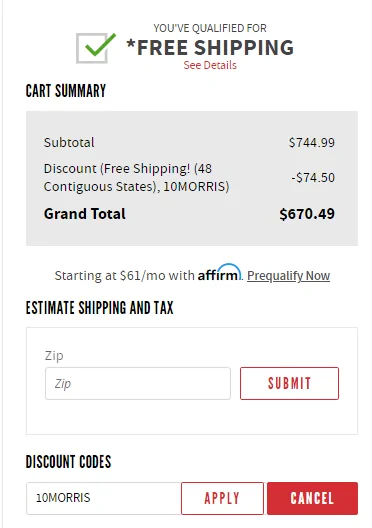

what site are you seeing the warn at that price?
Morris 4x4 with a discount (10%) received from the Green Jeep Only Facebook group. The same 10% off they were running a few days ago. Ryan Card is the sales rep to contact.
EDIT:
Actually, this code - 10MORRIS - is working right now.
