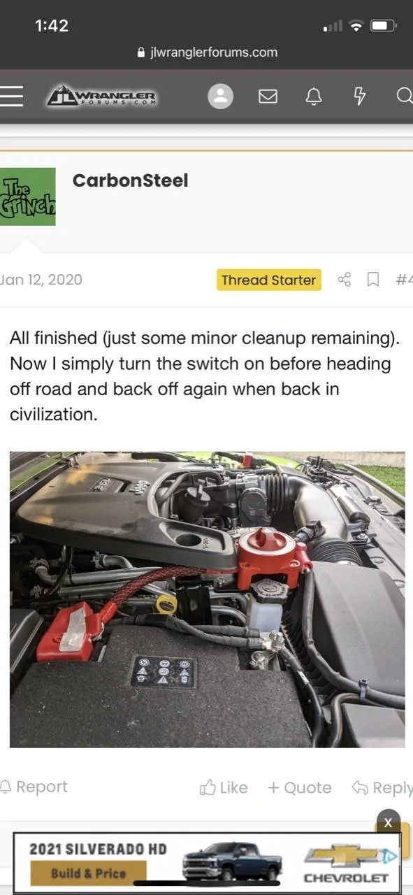

Did nobody really suggest a manual switch? I copied this idea:
Jeep Wrangler JL Winch Shutoff Switch at Battery IMG_2886
you can mount it on the fender like yawnie had at first on his 2020, just like the solenoids.
I like the simplicity. It’s always off unless I need it. I also have a big Anderson disconnect connected to the switch.
I have never had to use the winch to recover, but I connect my smittybilt compressor to the Anderson plug when I air up and turn the switch on.
Some people have said they just turn the switch on if they’re going out on the trail, but I don’t see any difference leaving it off until I need to air up or use a winch, and I’d rather have it off until needed.

Thanks for posting. I really like the location of the switch as I have all my lights wired up at the aux switch wires near the battery and there’s really no room there. Did you fab a mount or is there a pre-made mount? Hard to tell where and how it’s attached.

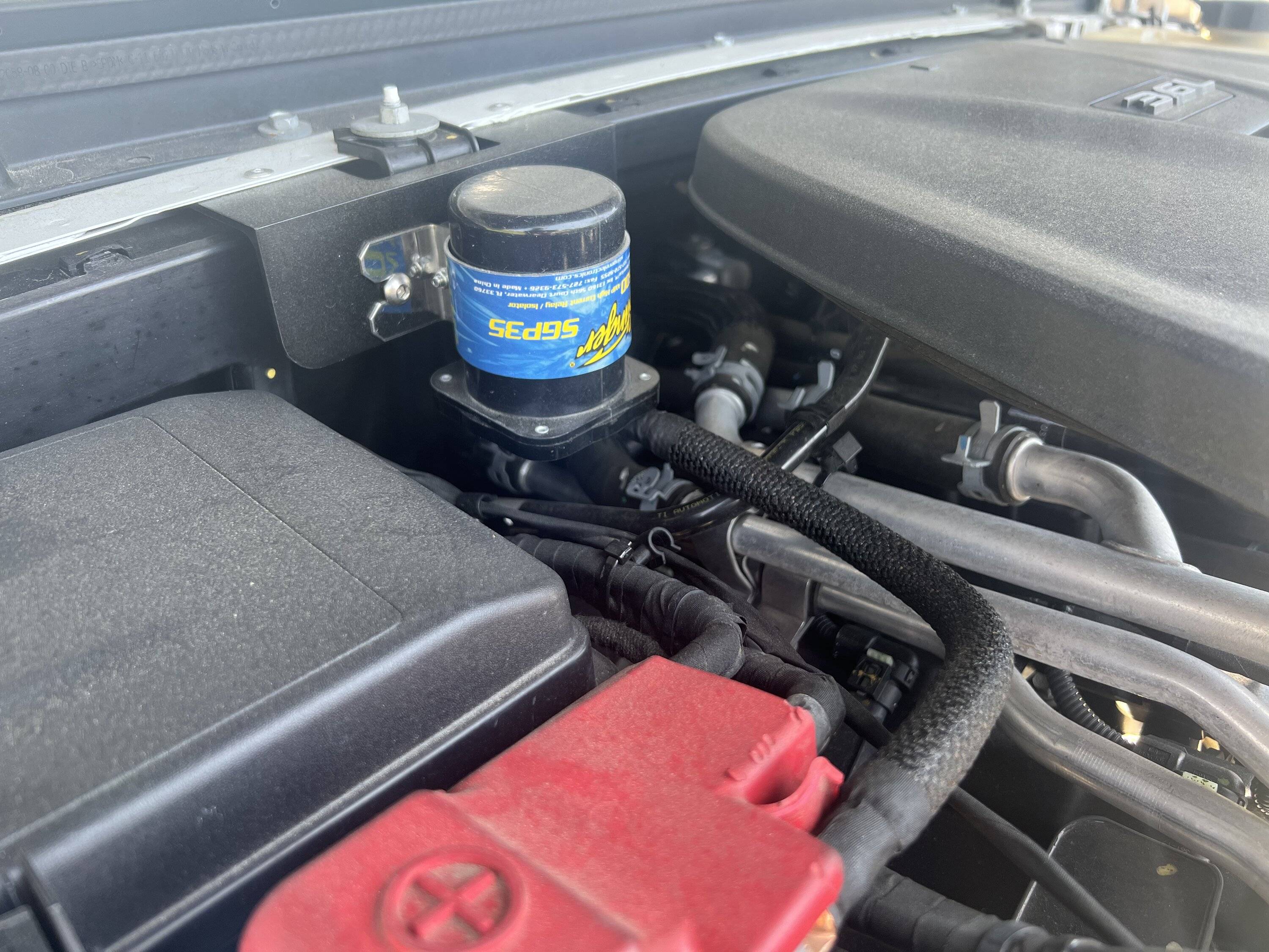

Very nice! Yes I have a switch, it came with the winch. I fabbed up a bracket to mount it. I'm going to add an individual fuse for it at the battery too.
I fab’d a simple bracket, same spot as him. Uses a bolt for the engine cover and I believe another one nearby, though they are not on the same plane/little uneven.
I would look up @CarbonSteel posts, I believe he used a flat piece of sturdier stock and leveled it with washers under one bolt… my solution was to bend up a couple sheets of sheet steel because that’s what I had handy and could work with. His method is cleaner.

I would assume so but wouldn't it be easier to add shut off switch or a wingnut at the battery and disconnect it. Note: there's a photo of this above your post. Keep in mind if someone is clever enough, generally jeep hoods are not locked.
