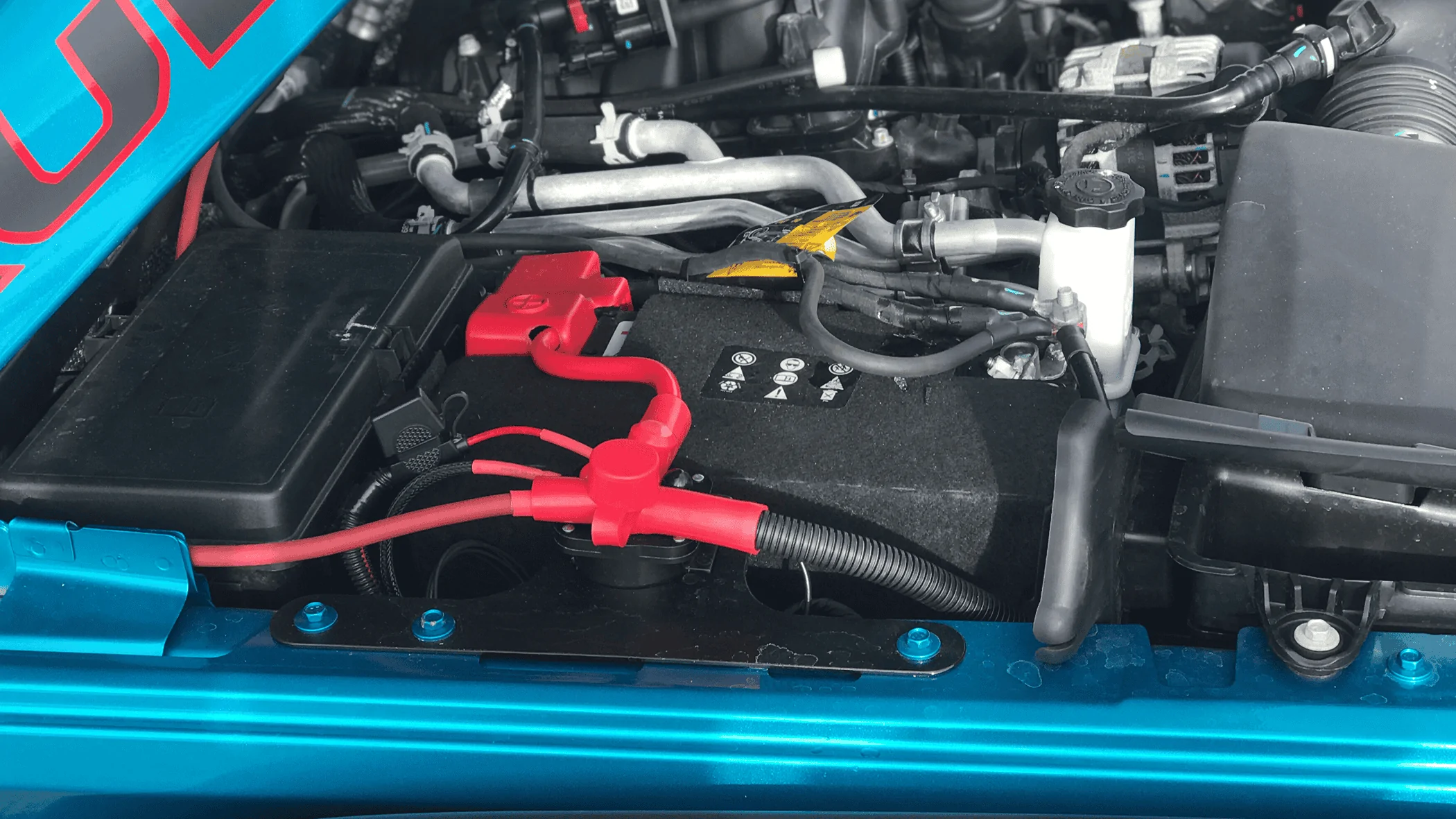

I used the Stinger 500 amp in all three of my Jeeps. They disconnect power to my winches and air compressors.
Jeep Wrangler JL WINCH CUT OFF SWITCH/SOLENOIDE 20962DF6-7036-4150-9764-E1AF2F417566
