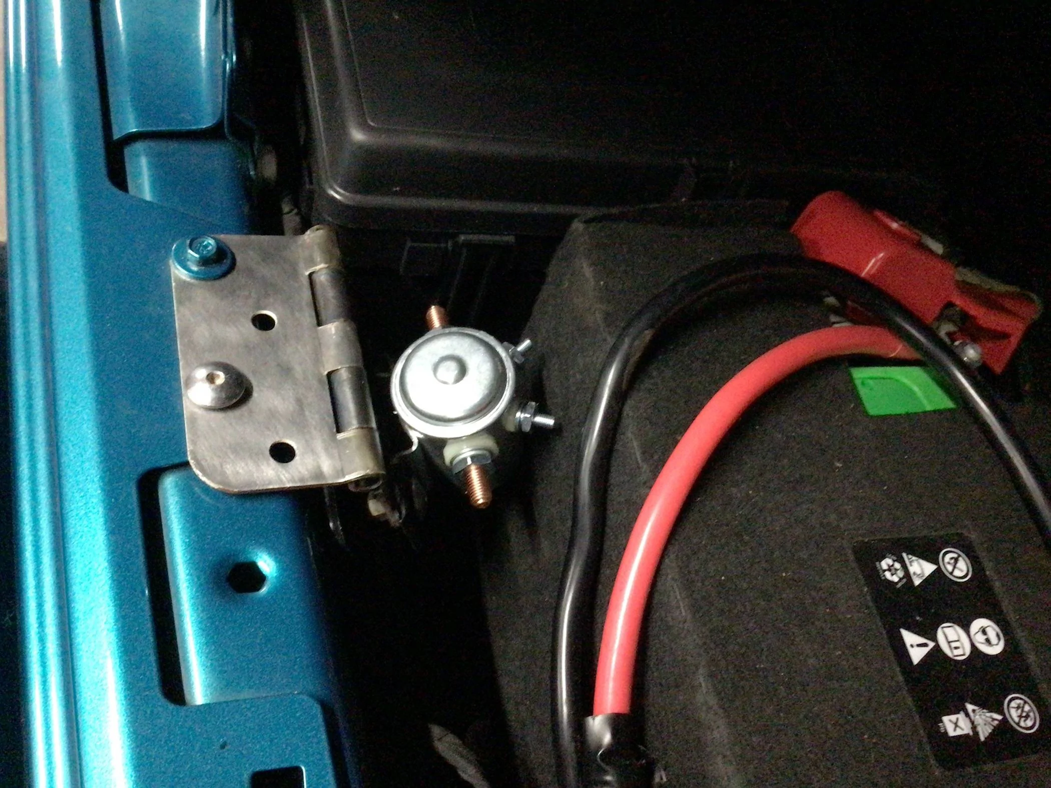

I opted for the warn solenoid kit, going to use one of my 20 amp auxiliary switches as power for solenoid, been working on this project this afternoon, so far this is what I have found on the left over in life’s to make it work. 1: rusty door hinge, I wire wheeled paint off, fixed welded the hinge on the other side, found a spot on the Jeep beside battery that hinge holes line up, plus solenoid matches holes on other side Of door hinge. 2: some chrome bolts leftover from a grizzly 700 floorboard refit. 3: might go buy matching paint tomorrow, might not.
