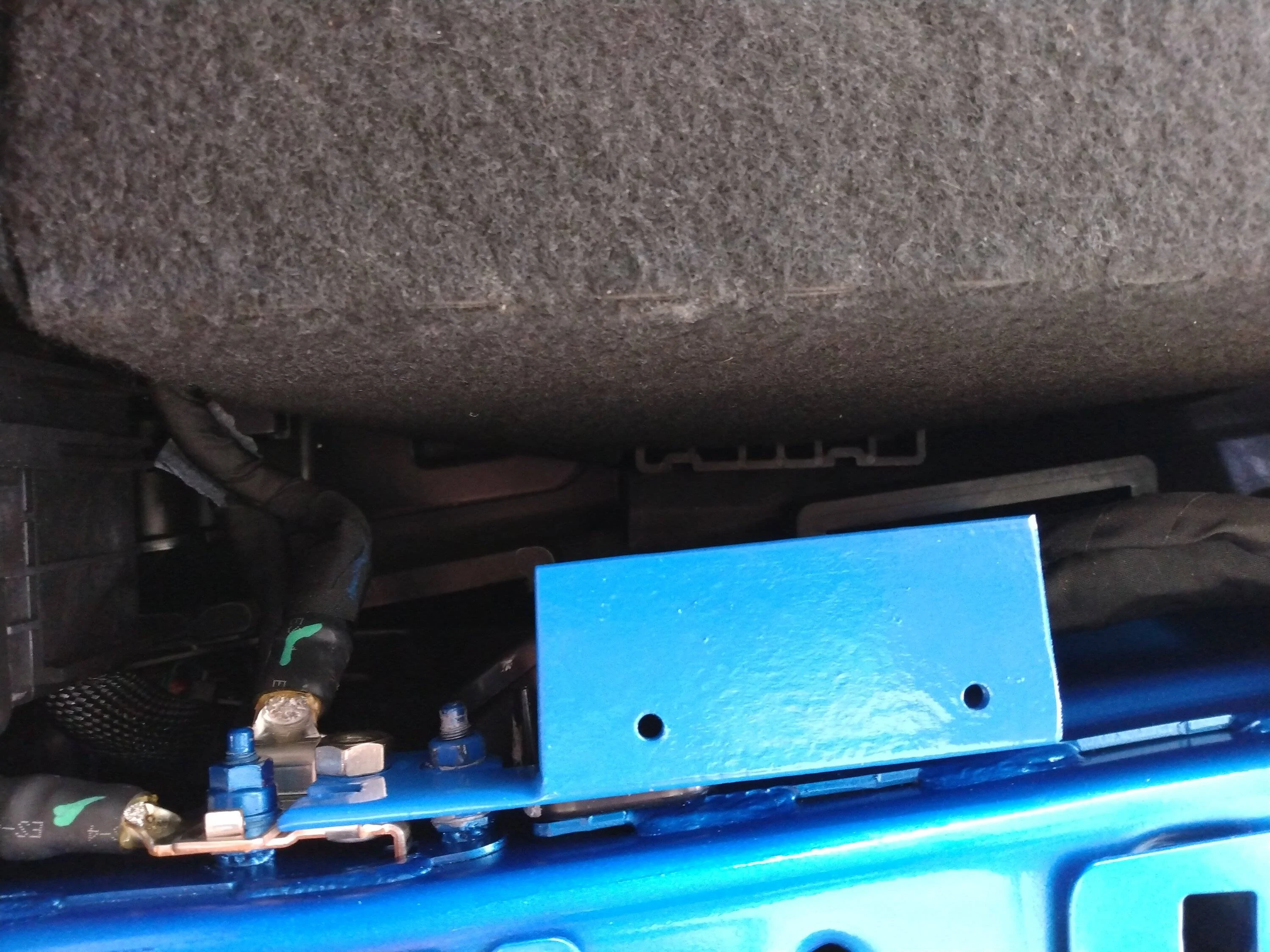

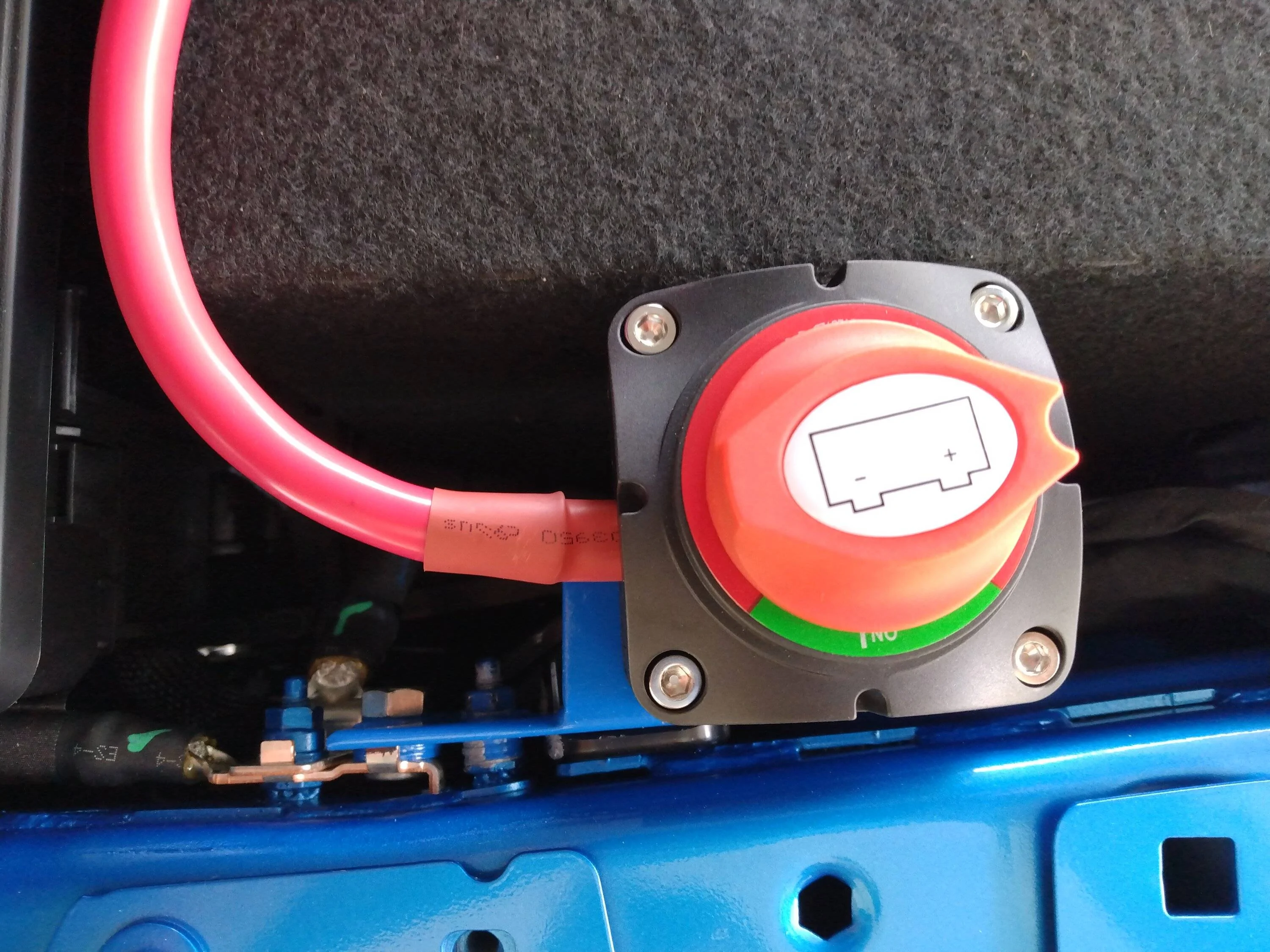

I used a scrap piece of 1/8" angle and I had a can of blue paint laying around. No trips to the hardware store is always a bonus in my book. I utilized the 2 factory bolts to mount it.

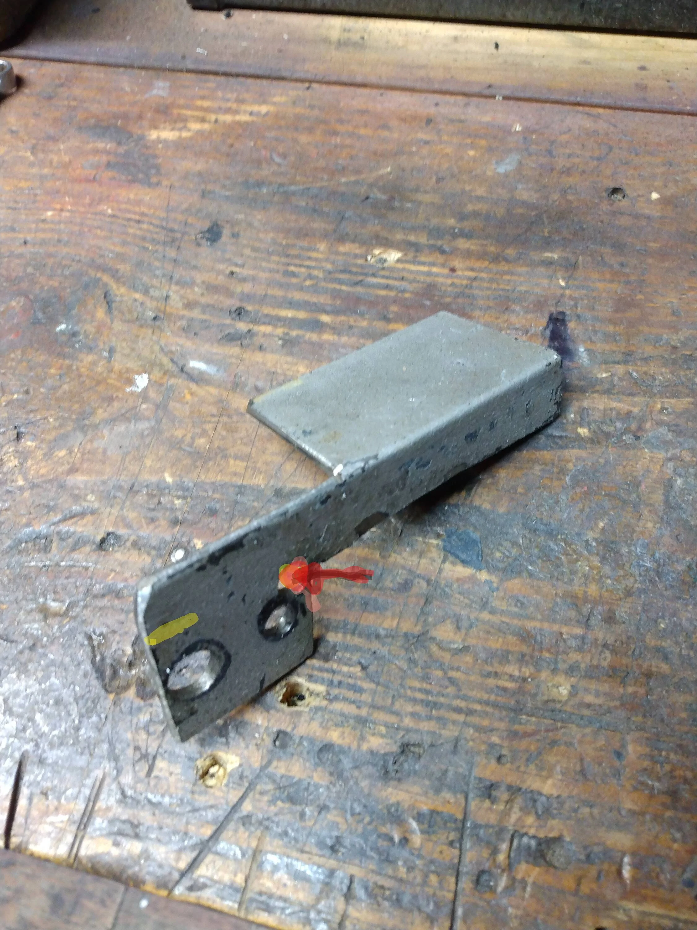

It was very easy. The key tool for me was an angle grinder.
Disregard the 3rd hole at the red arrow, and I made a small cut (yellow) so I didn't have to remove the little tang near the 2 bolts.
