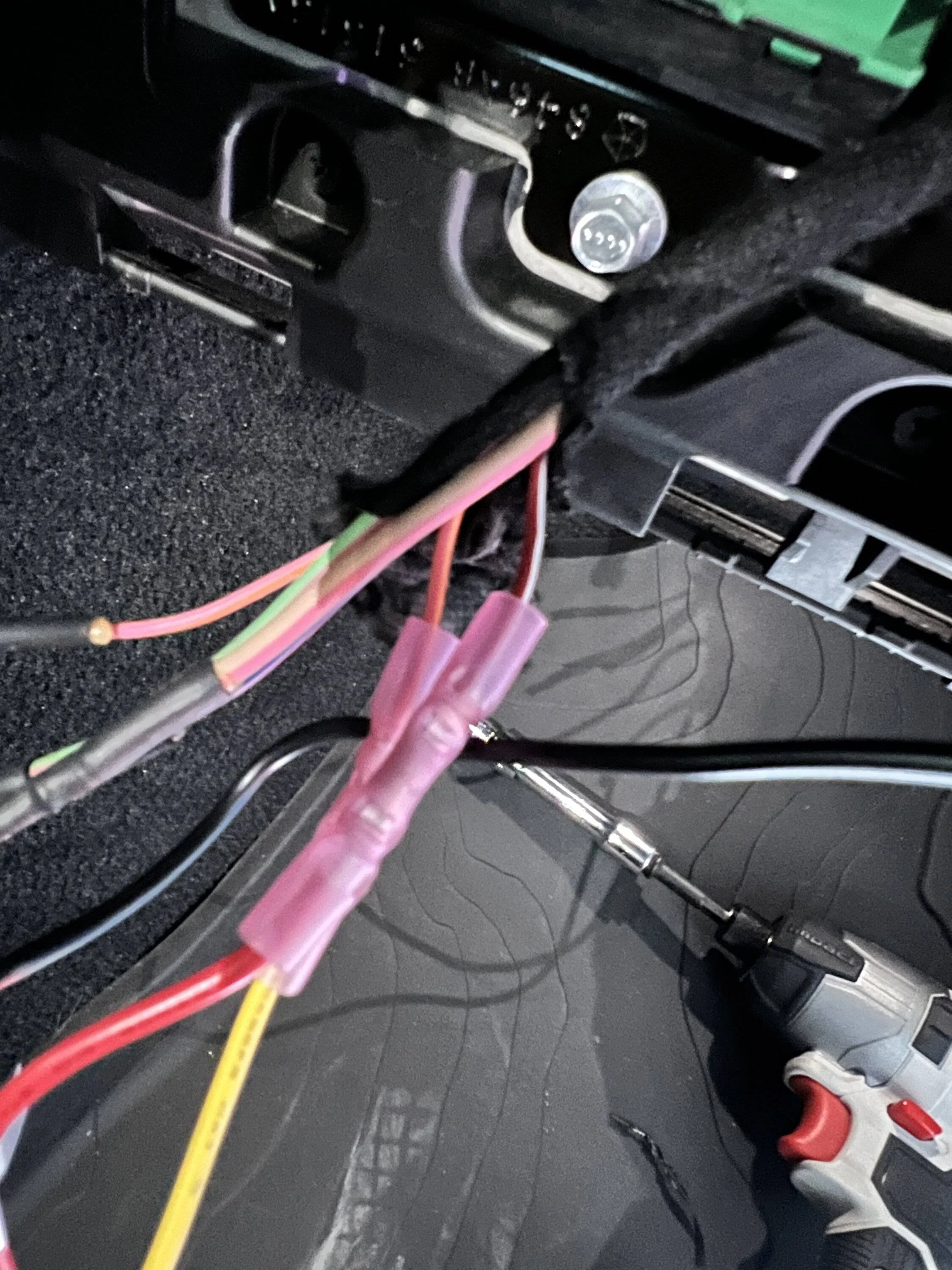

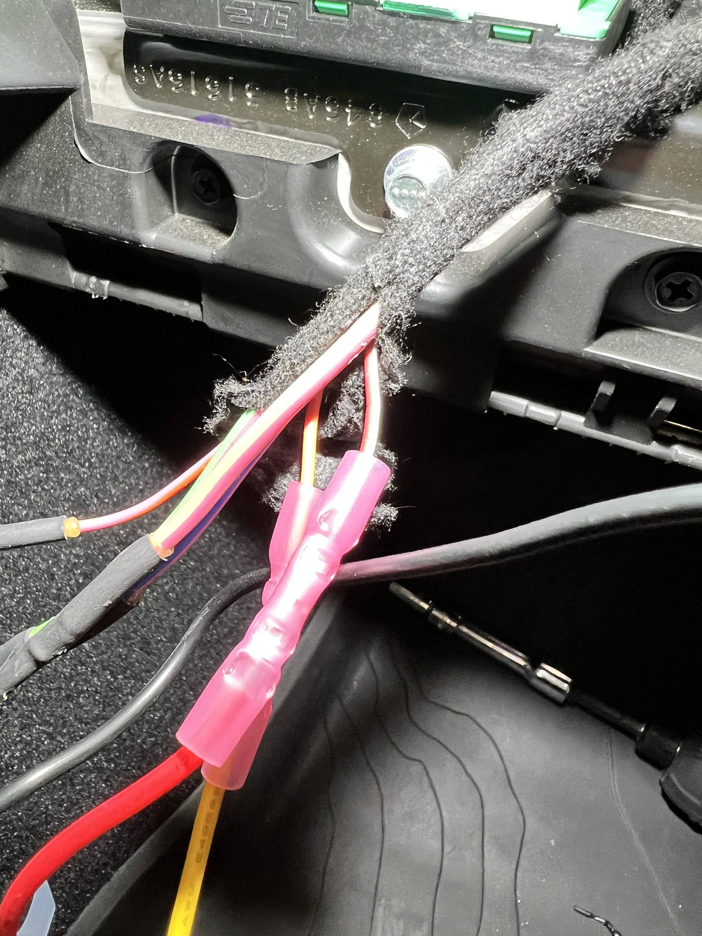

Received the new unit today and still nada. This is how it was connected. Maybe Ive gone retarded or something LOL. I tried taking two different images in case one worked better than the other. What are the odds that these wires have no power? I mean the Aux switches themselves work fine.
Since you dont have a multimeter, test it with a 12v cigarette lighter plug (or whatever 12v accessory you have laying around) instead to see if it powers that device you're testing.
Center pin on the male cigarette plug is positive, the 2 strips of metal on the outside of the plug is ground.
