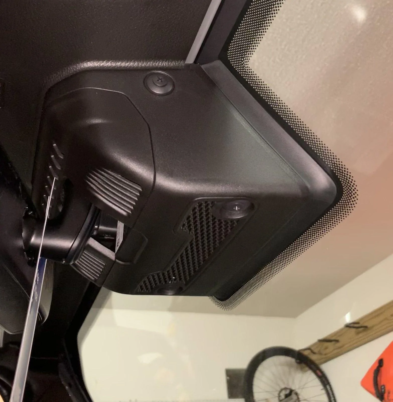

I purchased a front and rear cams and installed the rear small can in the front and larger front cam with a screen on the rear. I still have to hard wire to the rear power adapter and hide the wiring with oem headliner.

@tatarin did i understand correctly that you already hardwired the front cam? Appreciate if you could write up how you did your wiring. Thanks.

With this camera system you power up the larger camera with your standard 12v power plug and the little camera gets its power from the large camera. For cleaner install I flipped it from how it was intended. So the large camera is in the back getting the power from the rear outlet (which I will hardwire tsp into) and the little camera is behind the mirror. They provided long enough cable that I was able to route it up through the ACC and over to A-pillar down to the lower plastic and all the way back.
It’s not hardwired yet, currently it’s pluged in the back of the Jeep in that power outlet.
