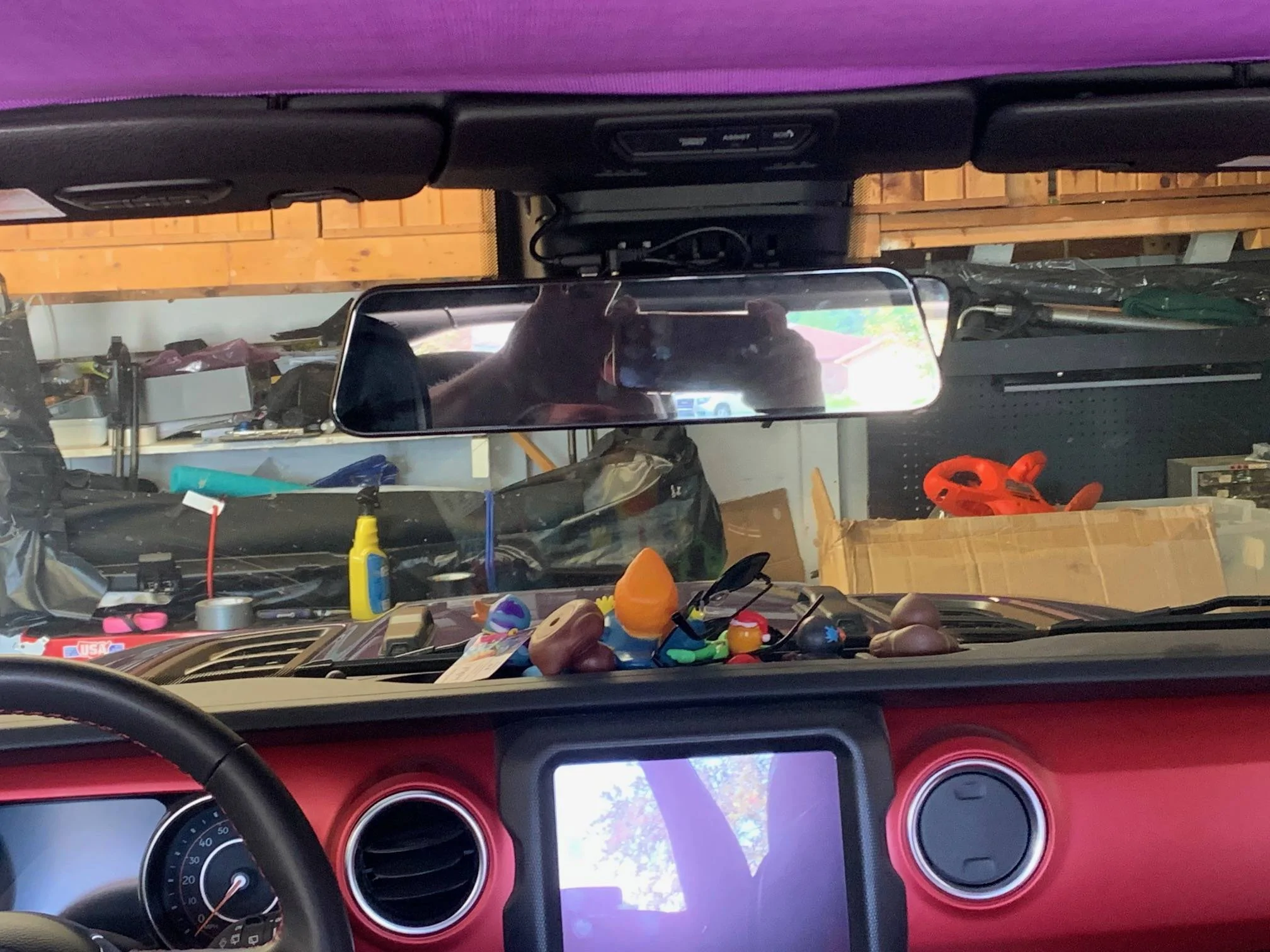

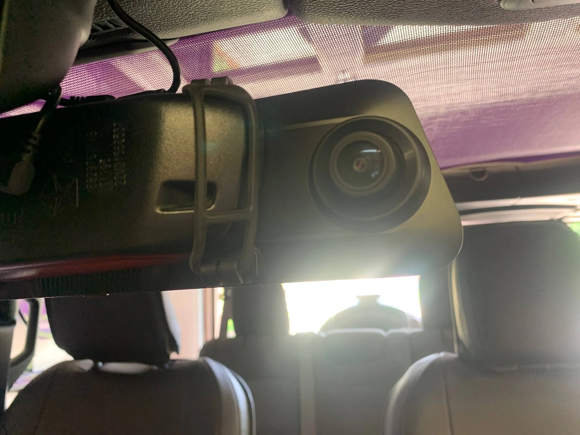

I use the Wolfbox G900 Dash Cam. I picked it because it has two rubber straps and it attaches to your rear-view mirror. It does not attach to the windshield, or your dashboard. It is not easy to see that you have the dashcam installed. I ran the cables through the different panels so you cannot see the cables. From outside the vehicle it just looks like a standard rear-view mirror. It does have to be off-set a little for the front facing camera to see around the sensor stuff behind the rear-view mirror.
I took a couple pictures, they are not really good pictures but they will give you an idea of what it looks like. If you look at the first picture, you can barely see the corner of the stock rear-view mirror. I leave mine up all the time and nobody has messed with it. You can see the cables on the top of the mirror, but they are not easy to see from the outside of the Jeep. The front facing camera is adjustable...

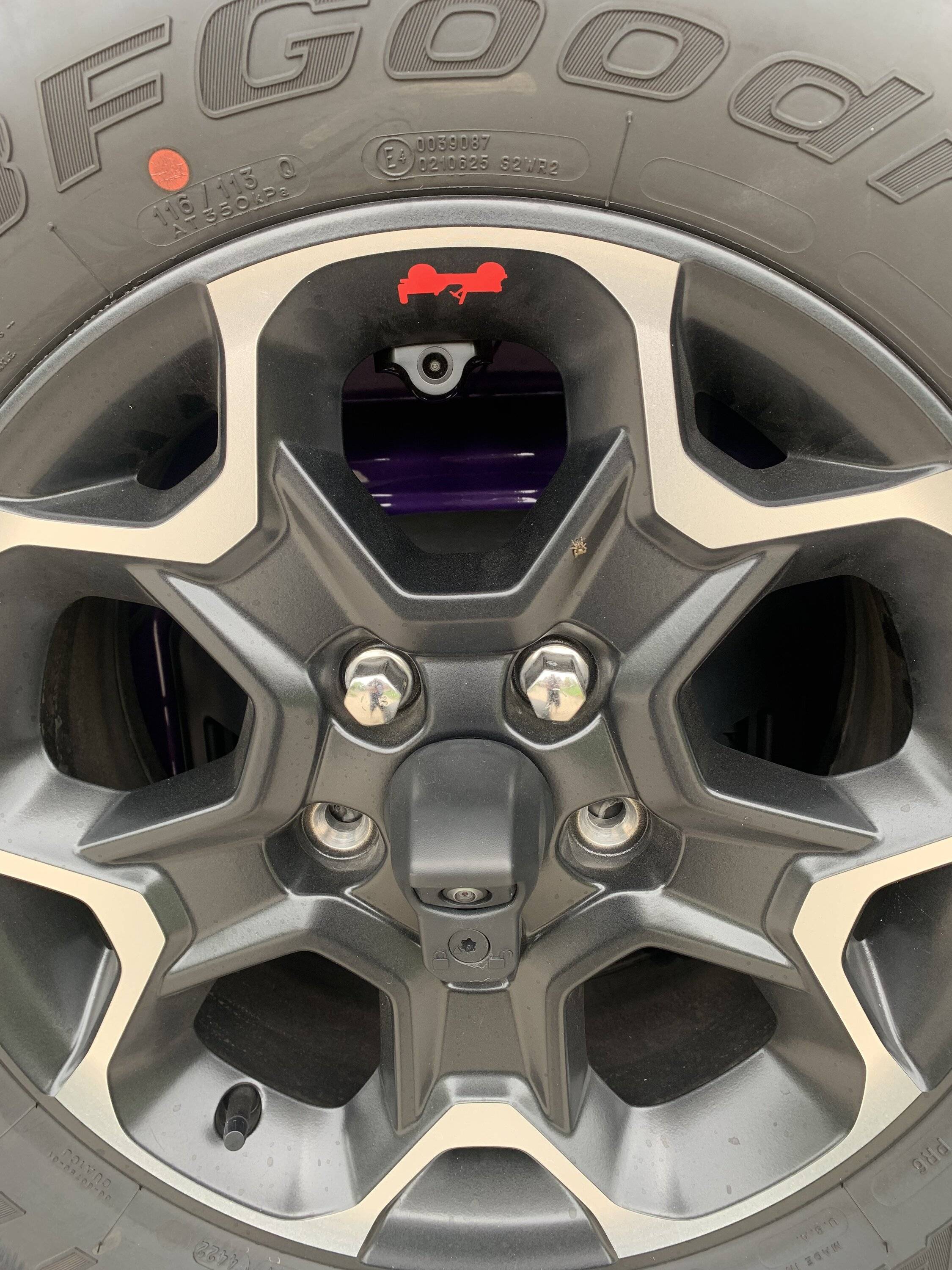

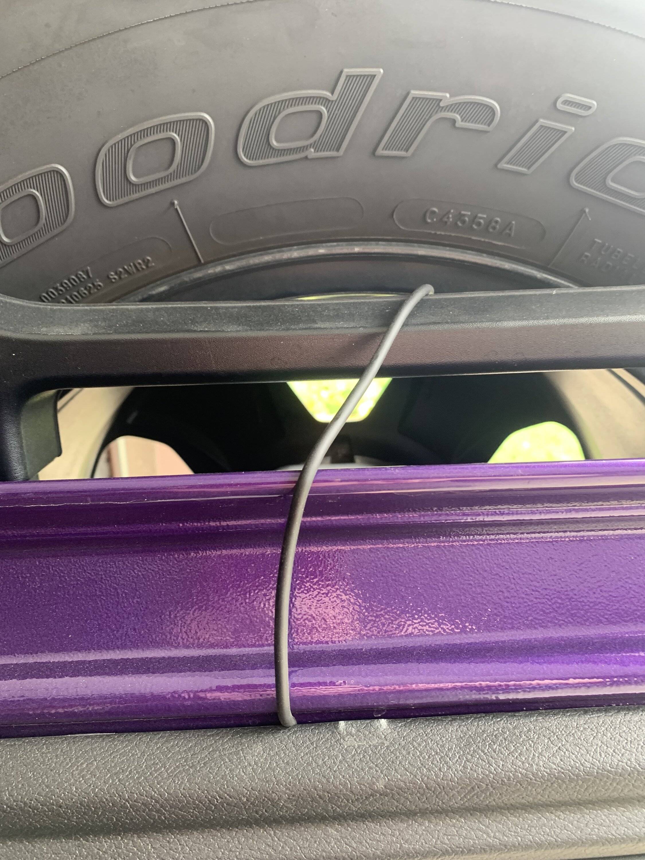

I bought the long wire kit for the kit. I ran it into the back door and have it mounted on the spare tire. I will post some pictures tomorrow when it is light out. I can be installed outside, in fact they recommend the back camera should be outside...

Maybe not a professional looking install job, but it works. I would like to clean it up a little. I got power to the rear camera from inside the tailgate by tapping into the rear brake light harness.

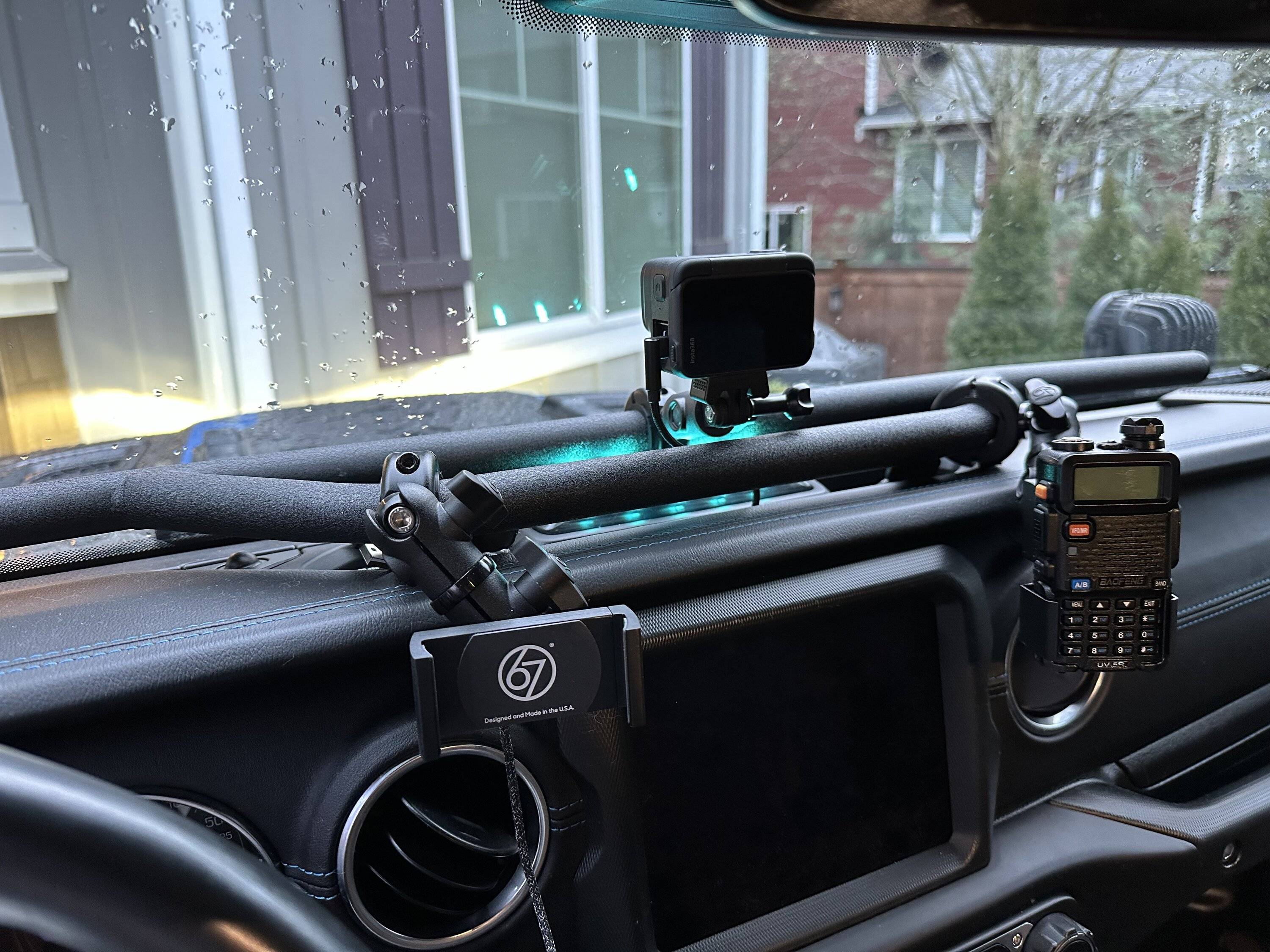

The new Insta360 Ace Pro has a dashcam feature. I use the action cam when I'm out, then clip it in for "dash cam mode." Win/Win. It turns on/off and records with the Jeep.
The footage is great, and there are so many options. I can record up to 8k with this thing.
