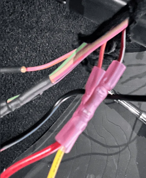

As requested.
I dont have factory aux switches so im not 100% on this, but in your photo, maybe the pink/orange is the cable on the far left and not the one you have currently connected to the yellow wire? Did you confirm that as well with your multimeter?
Otherwise, i'd just open up the black box on the hardwire kit and get some voltage readouts on the PCB board where the pos/neg for USB cable is soldered onto to confirm if you are getting 5v output.
I did not check the acc line also. I figured there was no need. Even without that connected the camera should have worked. I think next I’ll connect it back to and see if anything comes out the other end.

Yeah there is a pink with orange stripe and an orange with a pink stripe. That would not affect the hot and ground though. The first kit, after it didnt work, I twisted the red leads just to make sure it wasnt the butt connectors. No joy with that either. For what its worth I tried the cigarette lighter connection a min ago and got nothing.
The pictures you posted looked like they were right. I assume you checked both of the leads for ~12v and verified the ignition wire is the ignition and not aux. Did you double-check the ground is grounded by checking continuity to another known-good ground, such as the outside ring of the 12v outlet?
This definitely seems to be an outlier situation...
(EDIT) Yeah, looking at your photo closer, I would double check that you're not accidentally wired into the Aux3 instead of ignition (you can test by going to accessory mode and toggling aux3 on).
I checked where I grounded it to other points in the body. Still ohmed out so it’s good. I did not check the acc line when I checked the main power. Figured If that worked it still should have powered on. Very odd it isn’t unless nothing is passing through to the usb c plug.

@driventoadventure @nsfw_andy
Thank you both for help with the wiring. I went and checked the ACC line and sure enough, it was the wrong one. Even though on the site I read it was the correct one lol. Imagine if I would have broken down and got a MM 20+ years ago, I would have been done days ago lol. Its done now though.
