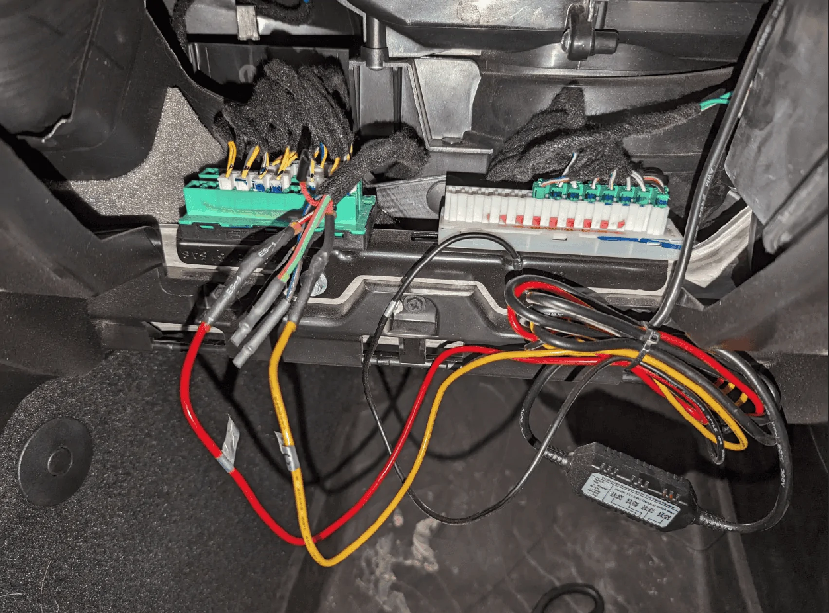

I was trying to avoid wiring it into the aux switches. I already have the bumper and A-pillar off road lights wired into the two smaller ones. Any where else I could wire it into?
The Aux switch bundle also has a permanent and ignition power lead, the two of which is what you want for the hardwire kit. They are not switch activated, just in the same bundle. Using those two just is a lot easier than wiring it into another lead.

I guess I am misunderstanding something? Are you saying there is a different place than under the hood to tap into them? I glanced under the glovebox and dont see any extra wires there.
Yeah, if you have the Aux switches, there is a bundle in the engine bay and a bundle under/behind the glove box. In each of those bundles there are six wires, one for each switch, one which has power when ignition is on, and one which has power all the time.
If you have them but can't find the bundle, look behind the carpet on both sides of the passenger footwell - many (including myself) have found the bundle stuffed in random places. It will be cloth wrapped and mine had tape covering the end from when they pulled it. I'll go get a quick picture of what it looks like.

If you don't have the aux switches then there are some other options in that area too, which I would have to dig around to find the suggestions.
