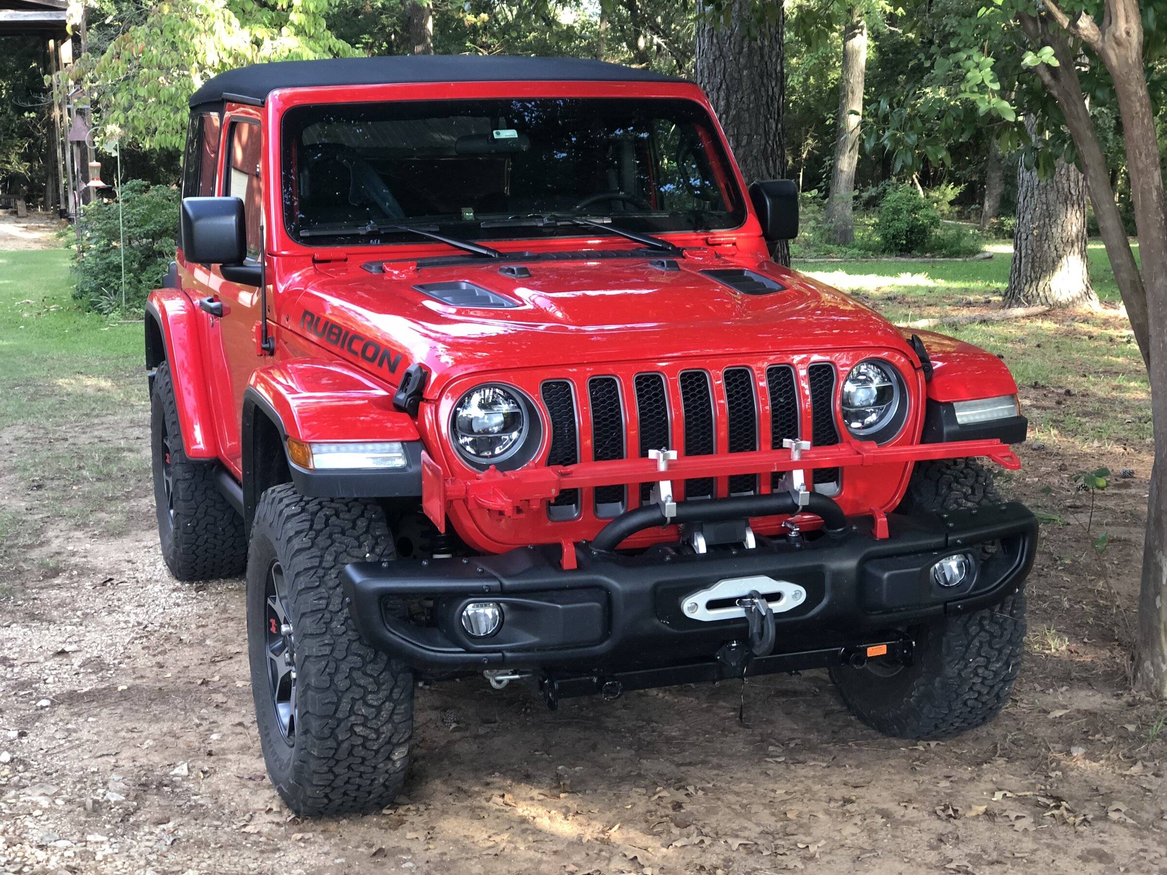

I’ve got a 10k Smitty. More than enough winch. I’d rather have more than needed than not enough. 8 k would certainly pull a JL with no issue though..
Me too. I have used for self recovery and assisting others numerous times.

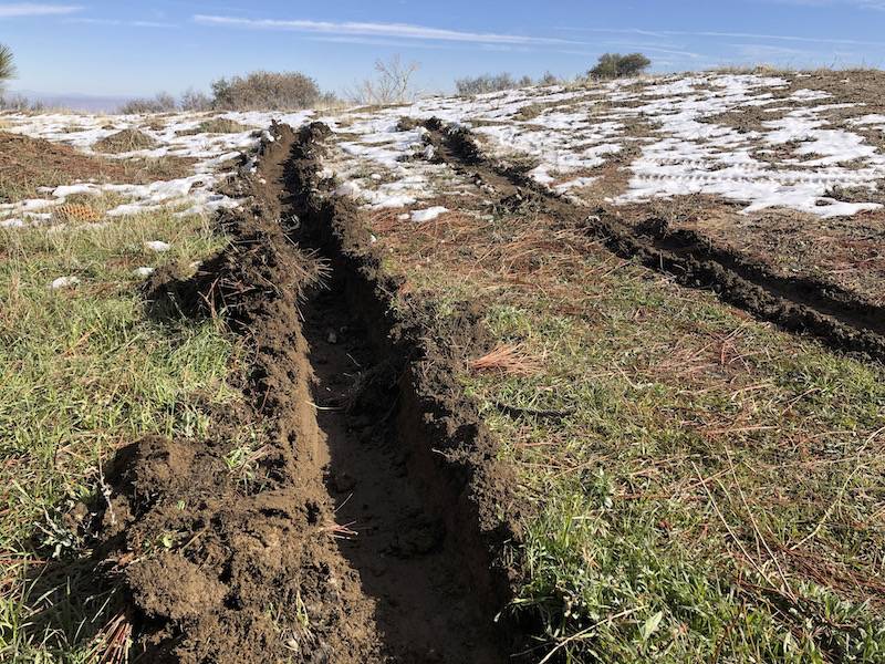

My very first use of the winch, of course, was just to pre-tension the line. I hooked up to a tree with a tree saver and then lightly (or so I thought) set the parking brake to offer some resistance. I was so busy watching how the line wrapped onto the drum that I failed to notice this is what was happening behind the Jeep. Boy did I feel stupid.
Same thing here, but on asphalt and from the transmission going into auto-park when the door was open. A Warn Zeon 10-S will apparently pull a JLR in park up a slight incline...
