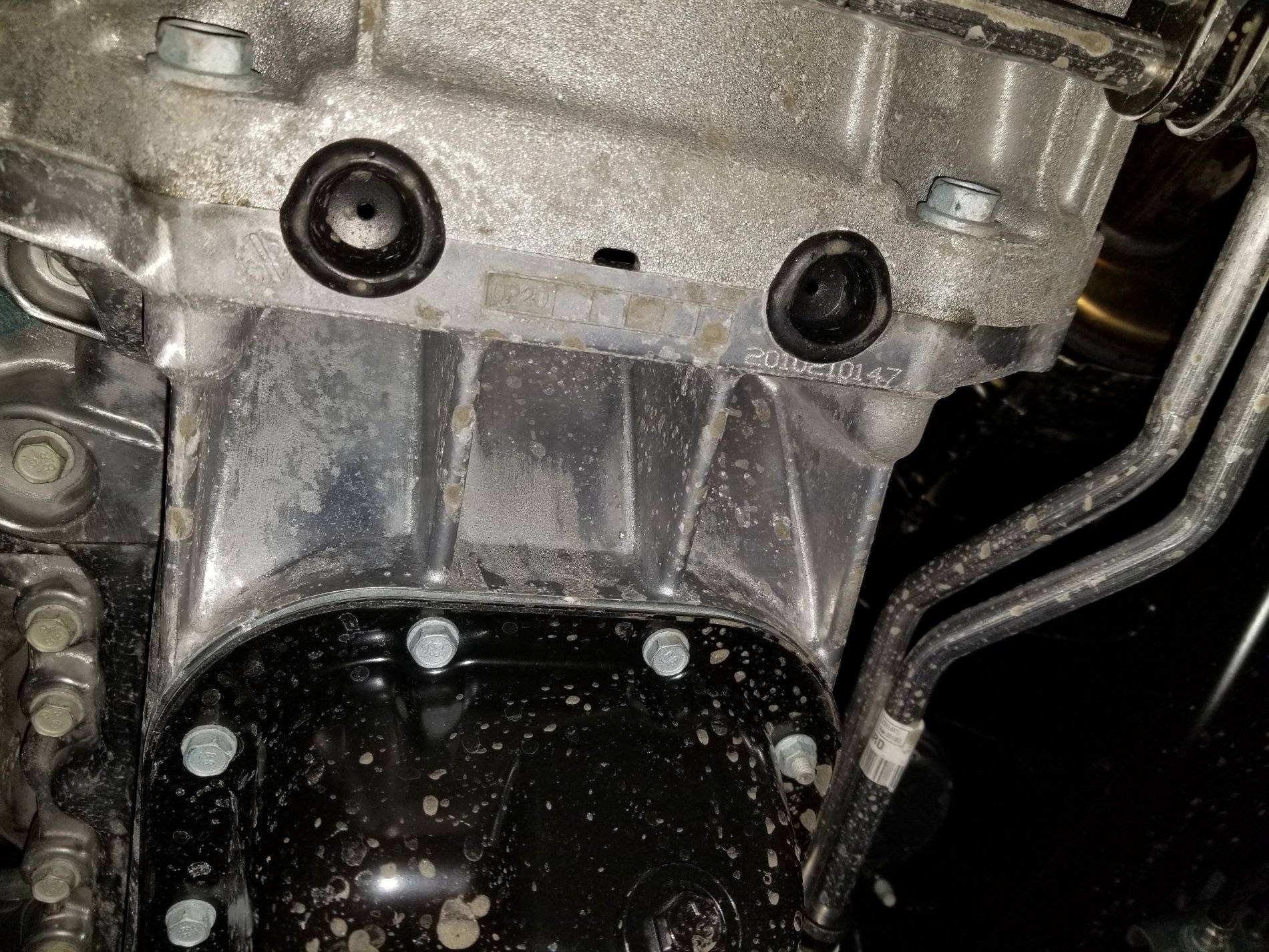

So:
What happens if you are not the type of person to look under your Jeep and you have these leaking (Rear main seal - i don't even know what that is lol) slowly over time?
What would happen to the Jeep eventually?
Nothing. As long as its the usual very slow leak (i.e. one or two drips per week on the driveway), the Jeep will go 200,000 miles without ever fixing it. In fact, it will get so gunked up from oil and road dirt it will form sort of a gasket and slow the leak down.
I kid you not. Ask any TJ owner. I had a TJ with 160K miles and a RMS leak its entire life. Ran like a champ. I never even missed the maybe 1/8 quart of oil I lost between oil changes.
Deleted member 53226
Guest
It gets worst and worst. At least for the 4.0, oil ends up on the exhaust and starts smoking. Large puddles of oil form under the engine wherever you park it. When you drive it drips and you constantly smell oil burning or you see a trail of it as you drive. And as you may guess, low (or no) oil in the engine isn't the best thing.
Darn, you and I had totally different 4.0 RMS oil leak experiences! I guess it depends on how bad the leak. I just posted my TJ experience and I never fixed mine, and rode on for 100,000 miles with no issue!

Ok, basic question. Where exactly are those plugs located (I can't quite tell from the pic)? Are they on the side between the trans and engine, bottom same are, etc? On the 2.0, are they easiest to see by crawling under just behind the front tires, etc?:blush:
you should get comfortable crawling around under ther and explore it
then when the bear comes that is where you hide :)
Not sure on the 2.0 but sounds like the same place as the 3.6.
I'm not sure about the 2.0. On the 3.6L, if you crawl underneath the jeep, they are where the transmission gets mated to the engine. It's kind of right behind the oil drain pan (towards the back of the jeep). On the 4.0, they're in the same area, but there's no inspection holes.
I would guess the 2.0 is similar, since pretty much every vehicle has this. :)
I'm attaching a picture of mine. You can see the oil pan (in black), then the drain plug for the oil pan, then right behind that are those plugs.

I had oil there and was beginning to pool inside, turned out to be rear upper oil pan gasket leak. 2021 3.6 etorque.

Took delivery of Jeep on Thursday, Dec. 10th. Noticed leak on Saturday, returned to dealership Monday Dec. 14th. They repaired it and I got the Jeep back Monday afternoon.
