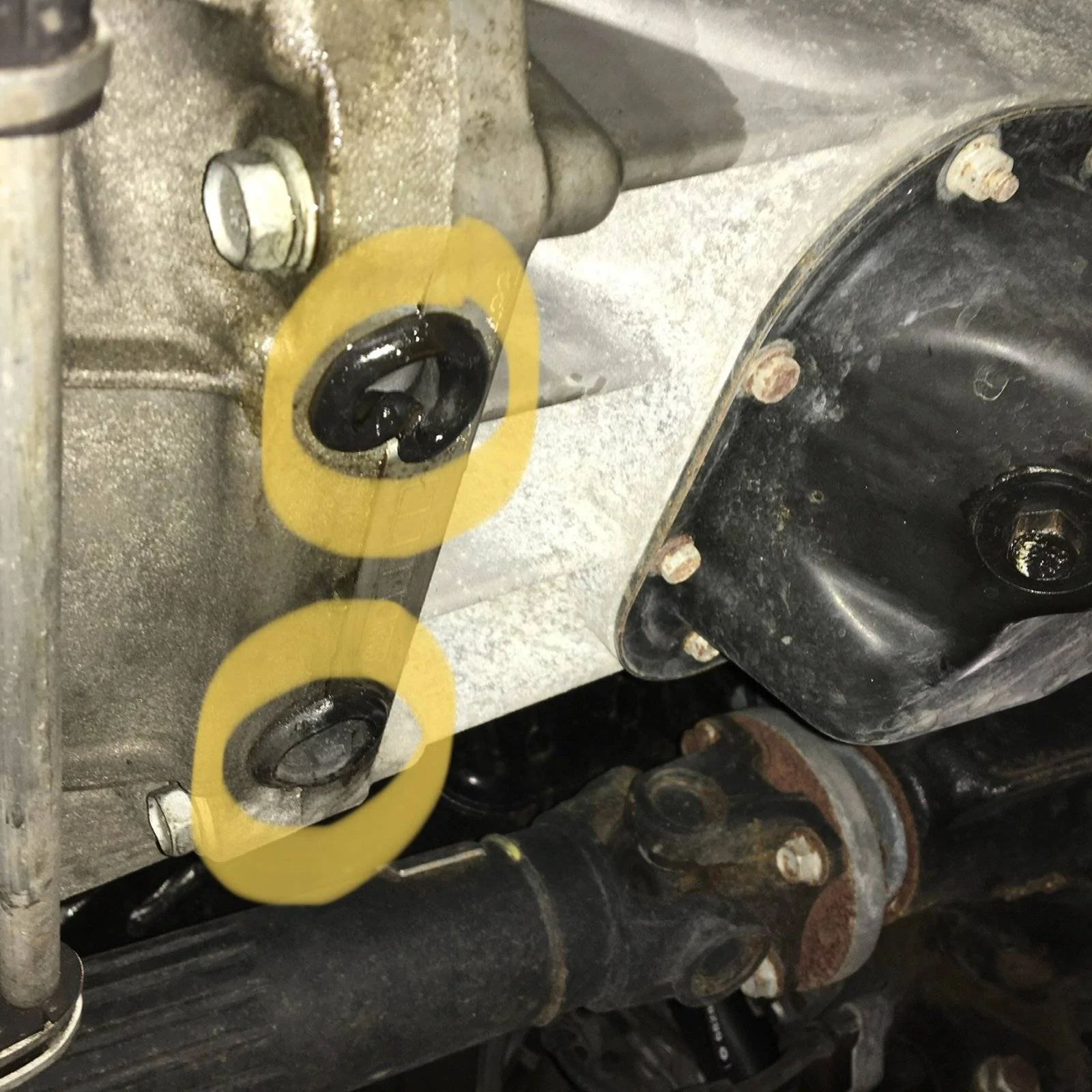

What are these and should they be leaking a couple of drops? Thanks.
Those are called "Regret Holes". They cause instant regret at paying $50K plus for a Jeep. They also serve to remind some of us old-timers that Jeep never fixed the rear main seal issue that has plagued Wranglers since at least the 90's. Yep, 30+ years of engineering evolution and this one still leaks. Jeep used to use a two piece rubber seal which inevitably leaked. The only upside it was relatively easy to change out once you dropped the bottom engine case oil pan. I haven't checked but I would bet they still use the same two piece seal to this day.
Jeep put the new Regret Holes onto the newer JL's so you can have a more convenient way to monitor your rear main seal leak. Used to be the rear main seal leak on older jeeps could be monitored by getting your flashlight and looking up at the gap between trans and engine. It would get all oily and gunky up there.
RMS never leaks a ton. Just a slow drip that sometimes never makes it onto ground.

Thanks man that sucks . 27,000 miles.
its a couple day fix. mine went out at 5K. dealer was able to get the new part within a couple days and i have not had any issue since. 16K now

What happens if you are not the type of person to look under your Jeep and you have these leaking (Rear main seal - i don't even know what that is lol) slowly over time?
What would happen to the Jeep eventually?

It gets worst and worst. At least for the 4.0, oil ends up on the exhaust and starts smoking. Large puddles of oil form under the engine wherever you park it. When you drive it drips and you constantly smell oil burning or you see a trail of it as you drive. And as you may guess, low (or no) oil in the engine isn't the best thing.
I had oil there and was beginning to pool inside, turned out to be rear upper oil pan gasket leak. 2021 3.6 etorque.

Those are inspection hole plugs, and like stated above ^^^ they should be dry. Unfortunately, it is a sign of a possible rear mani seal leak. have it checked out.
Agree, looks like the seal is leaking. No idea what that crap is unless it's grease. Does it wipe off?
