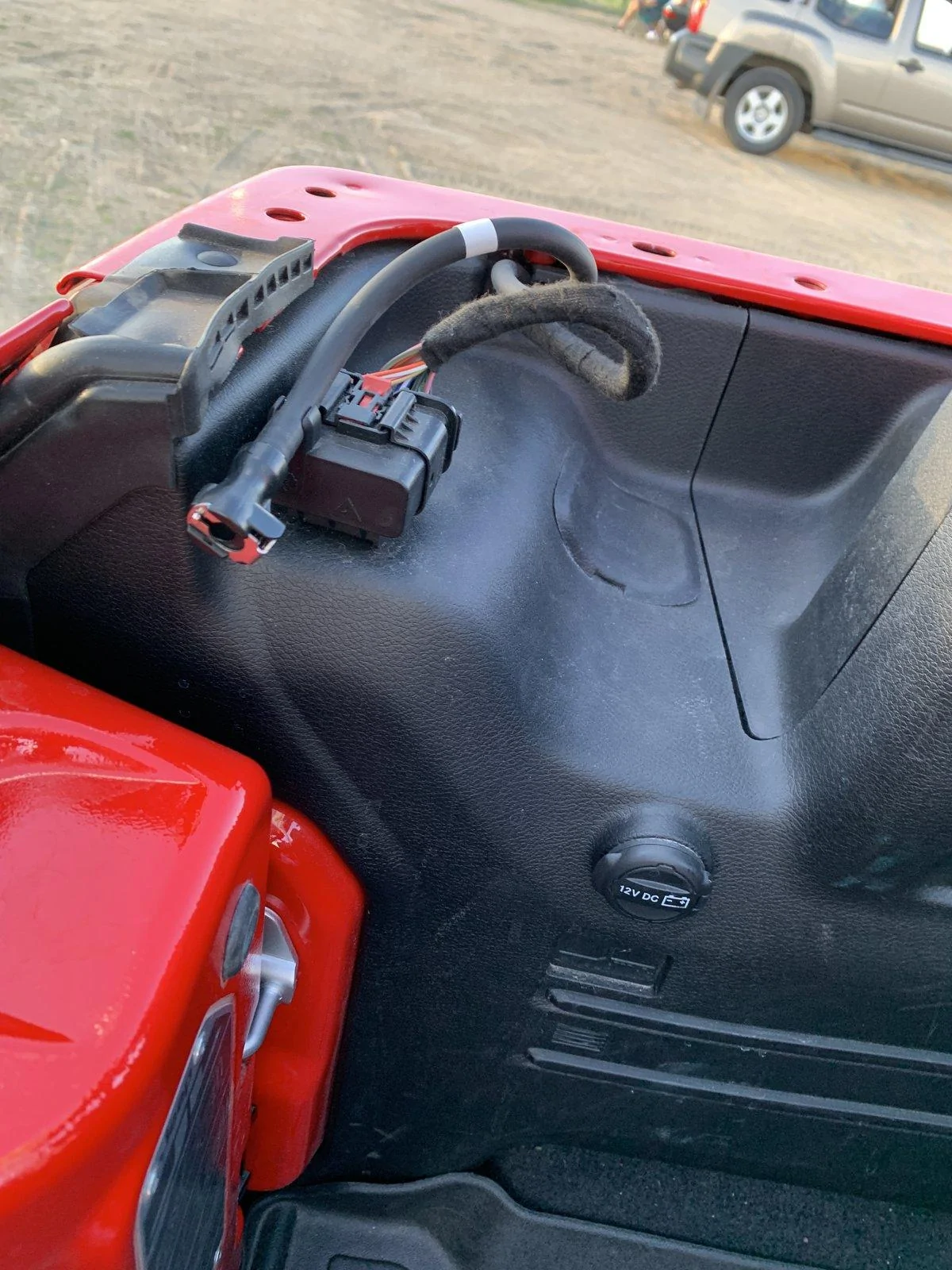

Took a picture of mine. I’m sure it was clear before, but this is it.
That makes total sense. I have been securing mine with a micro bungee using the square hole. Do you see a mopar part# on the bottom where it attaches to the molding?
I have a 2018 so it may not have been available for the first model year or at least the beginning.
Thank You! For the picture

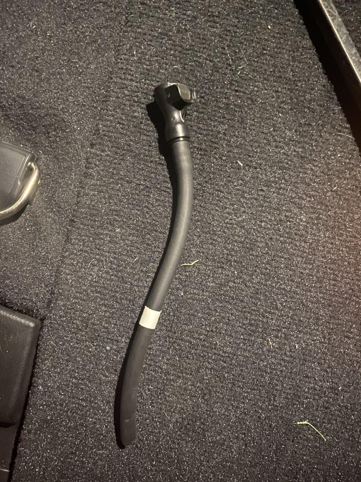

Any idea how to replace the rear washer fluid hose? Stupid dog bit it in half. Can’t find the part number and any clues how to replace it.

Use a barbed connector, no clamps need. Plastic washer hose repair, auto parts store
Thanks, I guess this is the way :) Just fixed it, had to shorten it by a couple of inches since the dog chewed on it, but it works.
