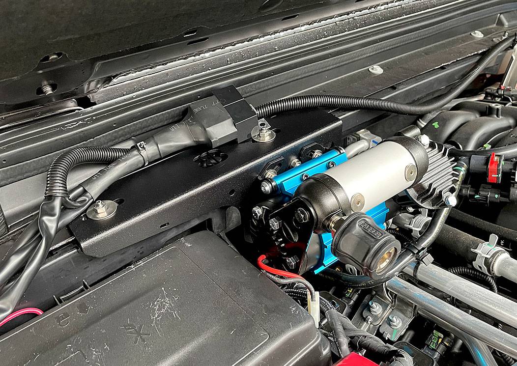

Most people are going with the dual compressor, but for those of us that are doing the single ARB compressor - where have you located it? I'm trying to put it under the hood but I have not found any mounts for the single ARB under the hood.
I do not want to do it in the wheel well - its not very accessible there and I don't like its proximity to catalytic converter and potential for dust and dirt.
Has anyone tried the JK mounts that are available? Can they be modded to work on the JL?

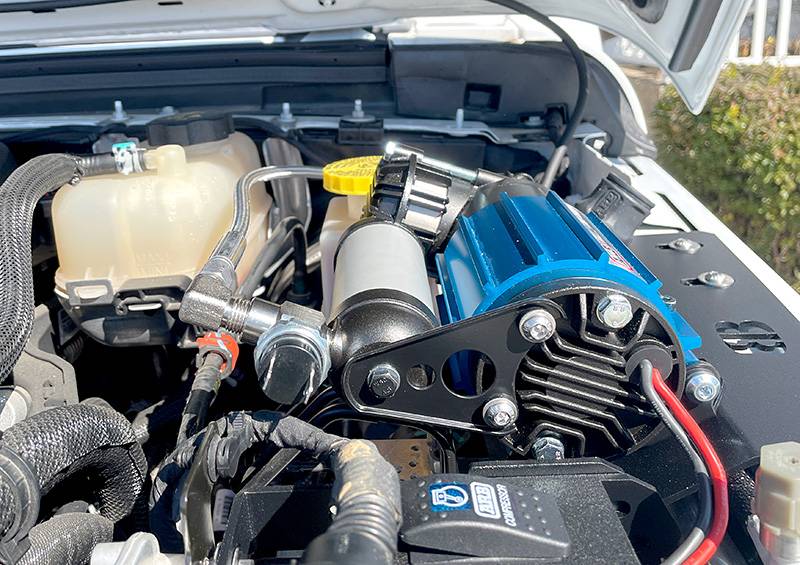

Here's the best I think I've seen for a single. I like a dual but this is tempting. And Jeep included the mount in the purchase price!

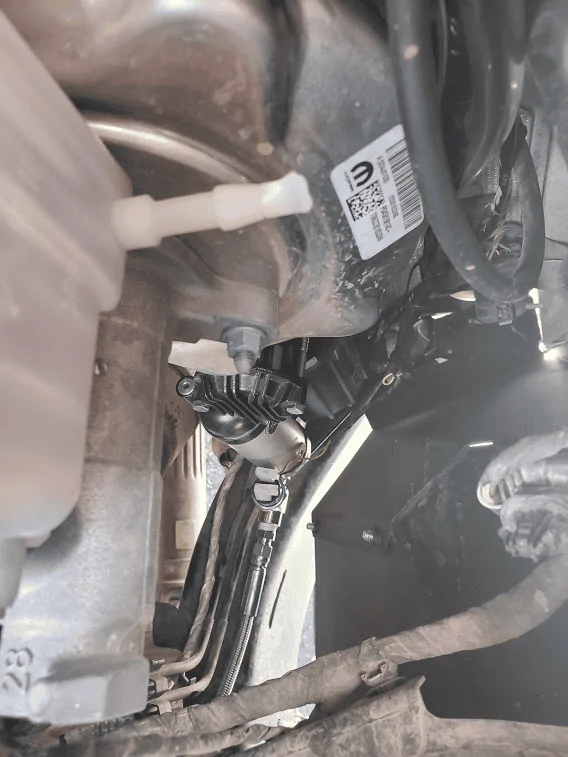

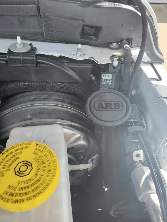

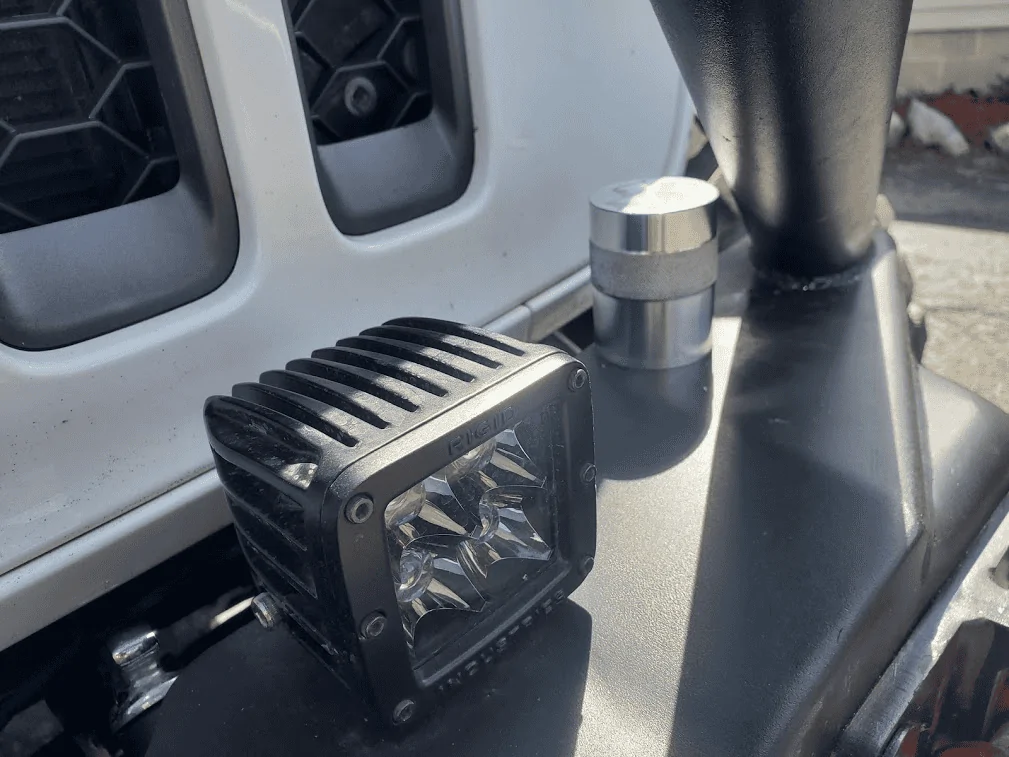

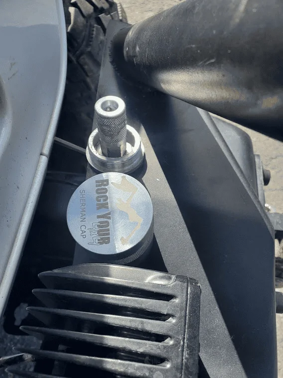

I have my single ARB pump mounted to the fire wall on the drivers side. I ran an air outlet to the front bumper. I have found that if I pump up six 37in tires from 8 psi to 28 psi, the pump will overheat..... if I leave the hood closed and engine running. The solution is easy, get my bum friends to get their own air compressor so that I am only airing up my tires, or open the hood.
I remote located the air intake for the pump to the top corner of the hood to get it away from the mud and dust. It has work great here. It is out of the way and it is quieter than mounting it inside of the Jeep. My wife will often chill in the air conditioning while I am airing up. If the compressor was inside of the Jeep, she would most likely not sit in the air. I like my girl happy and comfy.
It was a super easy install and with the remote air outlet, super easy to use.
Under the brake booster.
Jeep Wrangler JL Under-hood mount for single ARB compressor? 1598528901625
remote air outlet on the front bumper
Jeep Wrangler JL Under-hood mount for single ARB compressor? 1598528942046
Jeep Wrangler JL Under-hood mount for single ARB compressor? 1598528965281
the relocation of the air intake under the hood.
Jeep Wrangler JL Under-hood mount for single ARB compressor? 1598529000203
A pretty easy install, I did my JLUR and a friends JLUR in the same afternoon while caaually hanging out with my friend. I hooked it up to Aux 1 button. Running the wiring was very simple and easy to hide.

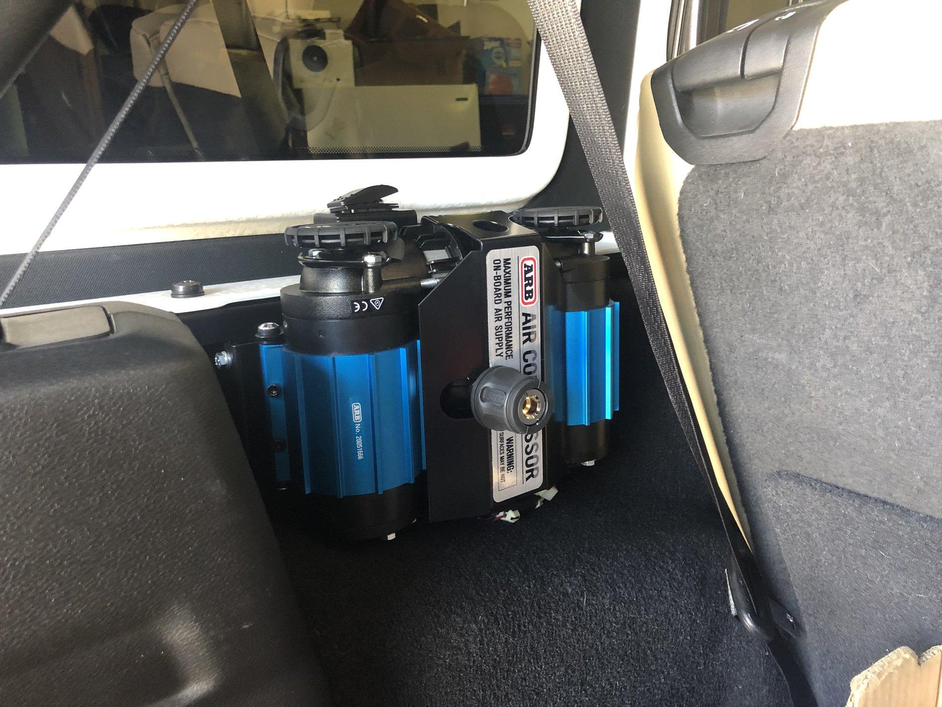

I ended up installing the compressor in the rear cargo area using the M.O.R.E. bracket. I also ordered a long power cable and ran a separate line to the switch's, I like this setup and ease of use.
