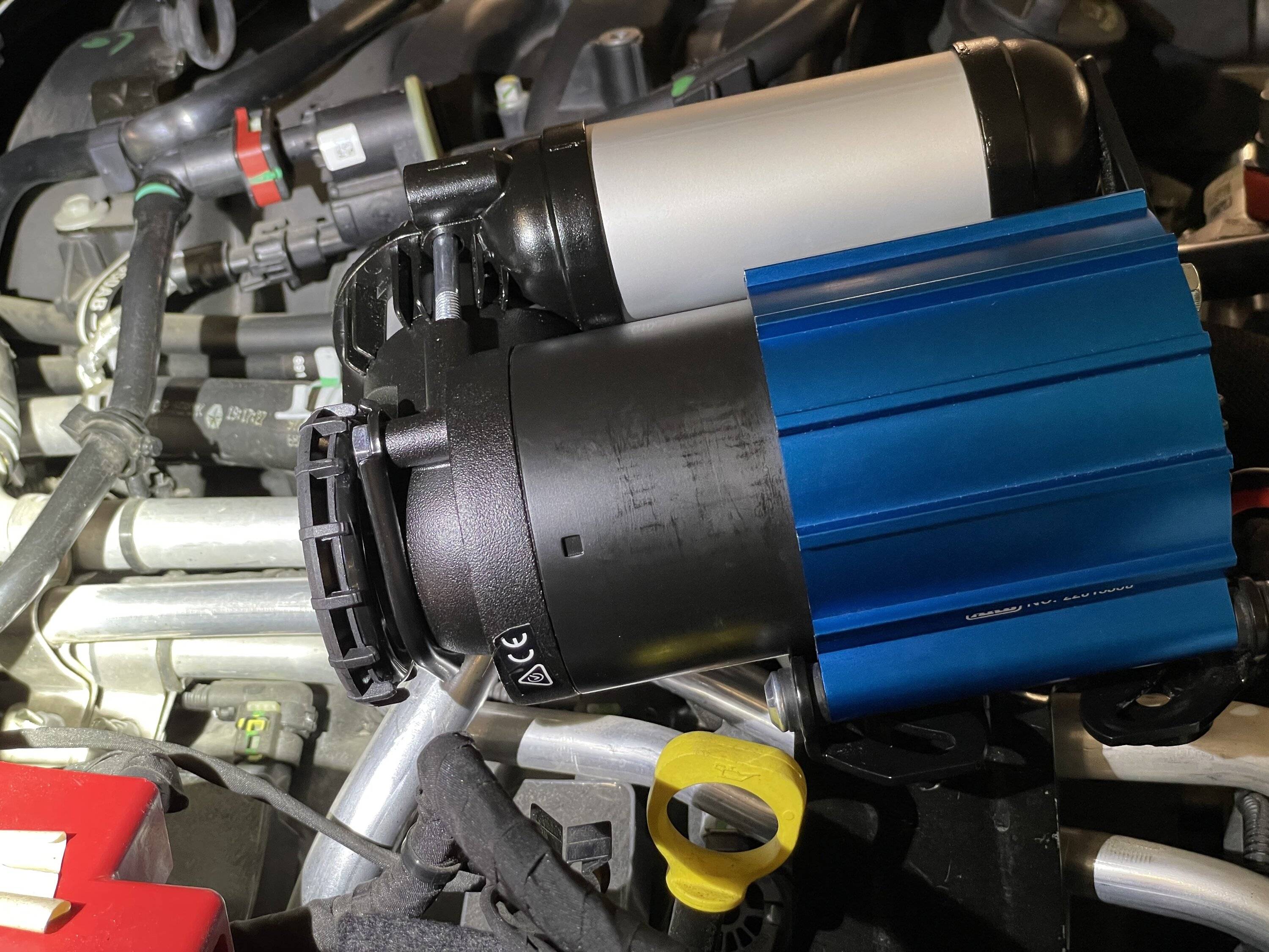

Hey guys, I saw this idea on YouTube, I forgot the channel. But basically you remove the engine beauty cover and that frees a bracket on the passenger side
Check these photos from my Jeep JLU 2021:
Main view:
Jeep Wrangler JL ARB Single compressor mount spot IMG_0695
Clears existing hoses:
Jeep Wrangler JL ARB Single compressor mount spot IMG_0696

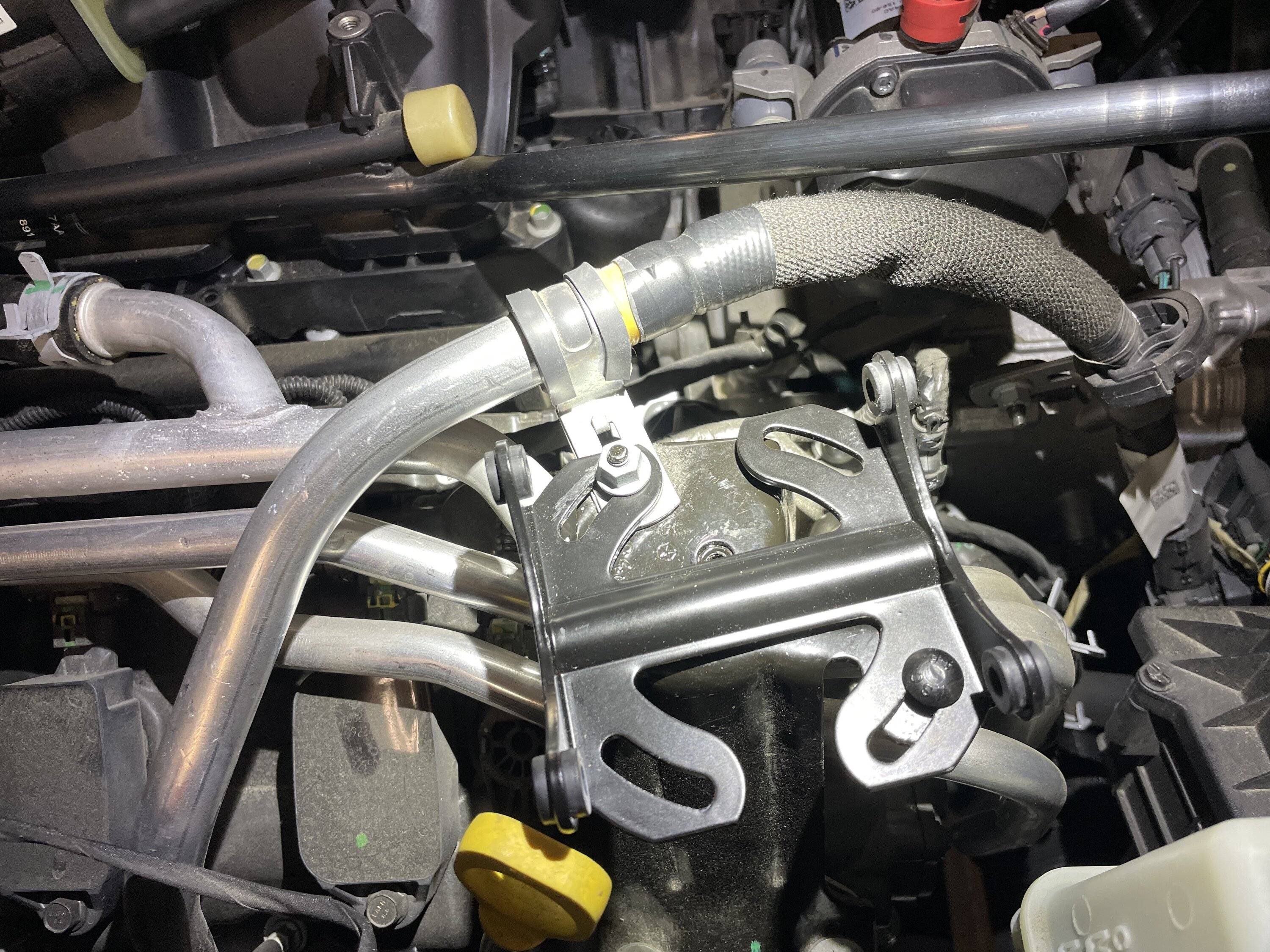

Clears oil stick:
Jeep Wrangler JL ARB Single compressor mount spot IMG_0697

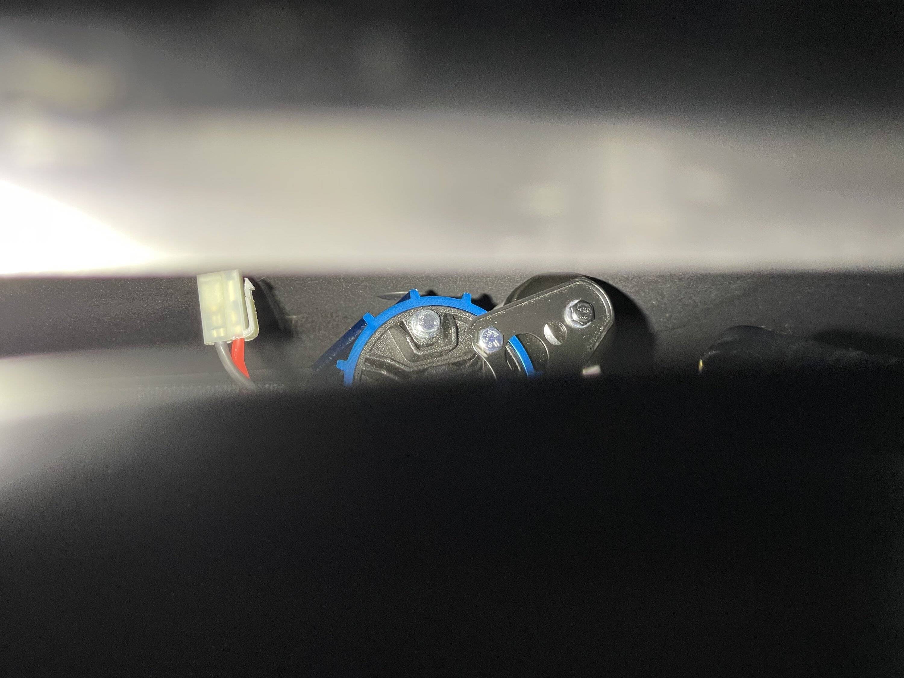

Clears the hood, very minimal rubbing agains the internal liner
Jeep Wrangler JL ARB Single compressor mount spot IMG_0698

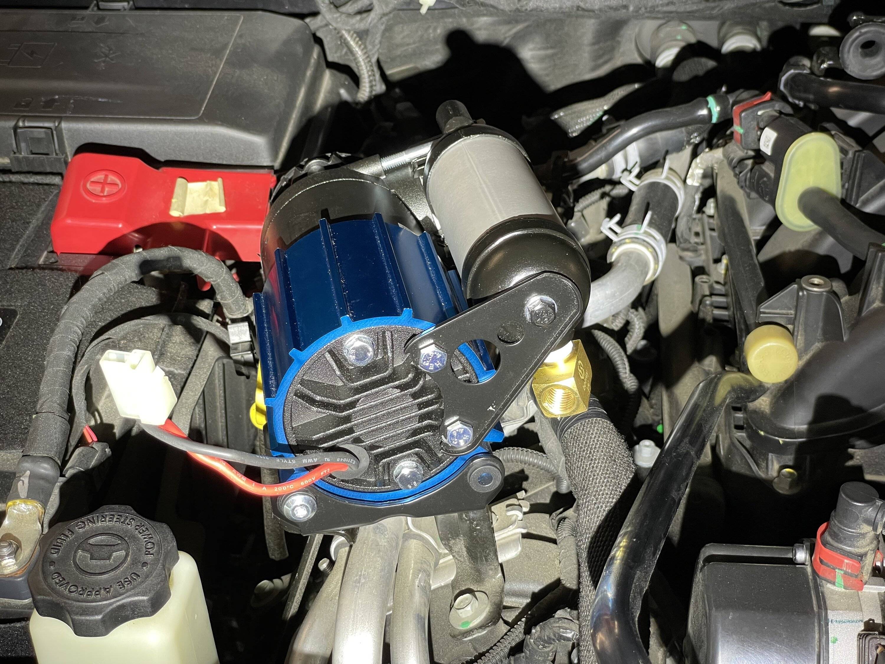

Has two attachment spots:
Jeep Wrangler JL ARB Single compressor mount spot IMG_0699
Bracket + arb mount view:
Jeep Wrangler JL ARB Single compressor mount spot IMG_0700
So what do you guys think ? YAY or NAY ?

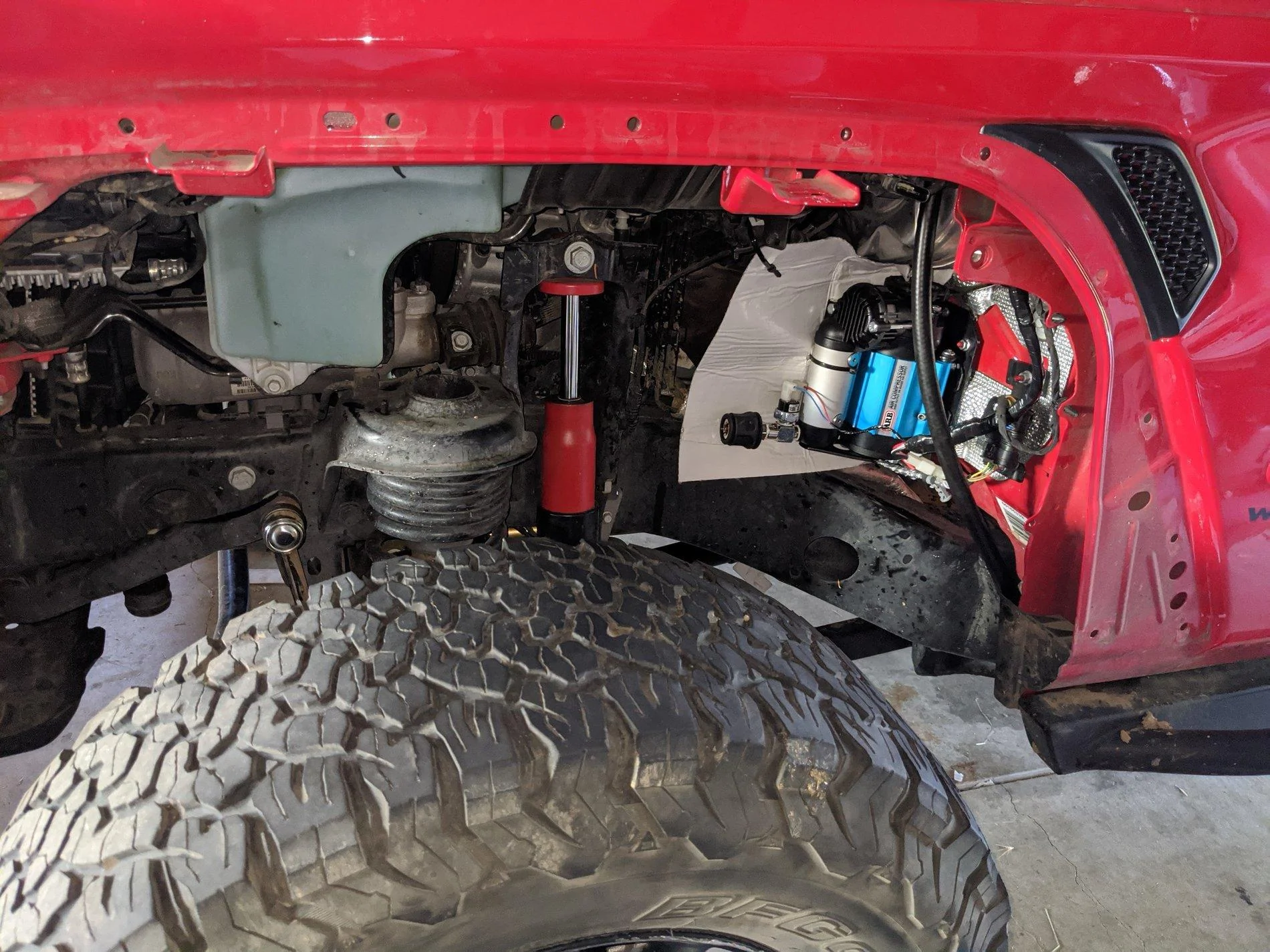

Nay! too much heat.
I mounted my ARB single on the drivers side firewall using a Way-a-life mount. Tho, that is also a hot spot, being next to a Cat, so some insulation is required. But, i can fill all 4 35's from 10 to 30 without stopping.
I picked up the ACM Mount and an ARB single. The install is pretty straight forward. My only problem with this spot is that it is near the exhaust cat. So, after installing it once, I went by my local auto parts store and picked up some heat shielding material, unmounted it, pinched the material between the compressor and mount on one side, and zip tied the material to the air reservoir (covering the zip tie with another piece of shielding) to cover and protect the compressor.
