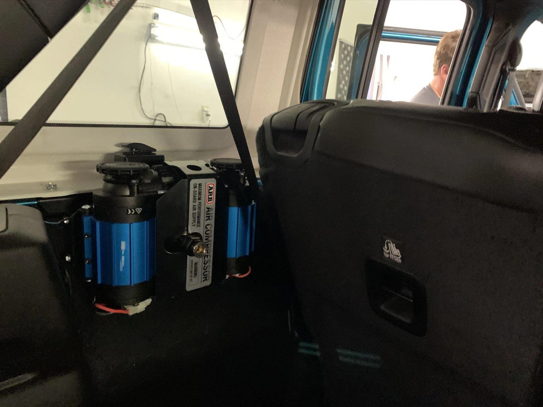

I chose the dual to have the 100% duty cycle. I also got it for 20% on a Black Friday Sale last year from Northridge 4X4. I have used it many times to fill my tires after off-roading and to fill others who had inexpensive air compressors that are more suited to airing up a regular car tire. I mounted it under the passenger seat so that it was less obvious to criminal types. Even with the doors off it is fairly innocuous as the black mounting plate hides the blue of the compressors and you can only see the quick air coupling.
