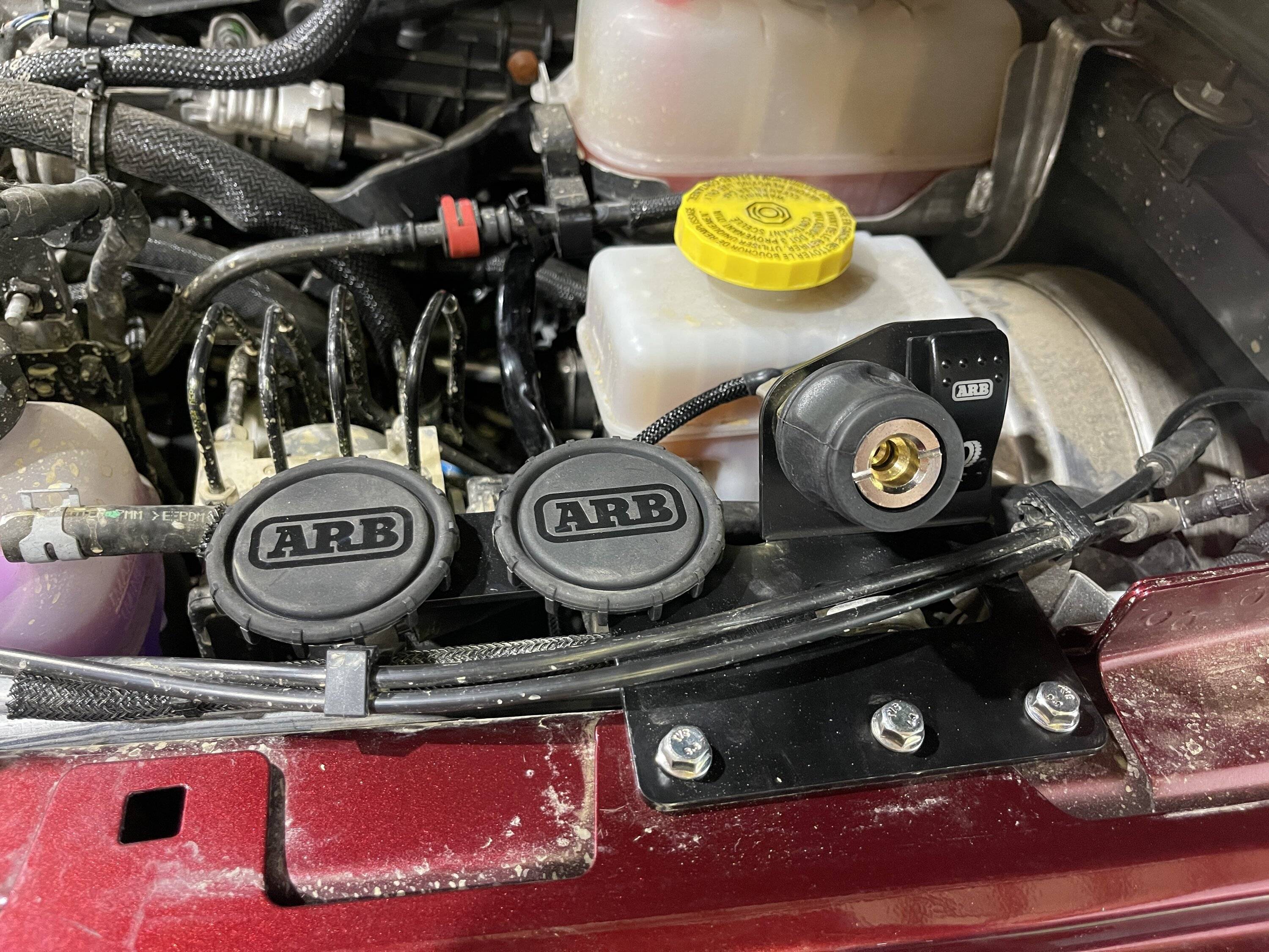

Thought I'd post this up here a buddy of mine who owns a shop in Northern California has came up with a solution to mount a dual ARB compressor underneath your hood and I think it's the best one yet. I've been searching for a underhood mount for a long time and I haven't found one that works for me. Here's a few pictures of how the install looks I also have a video on my Instagram @flexyjl.
The install basically breaks down like this:

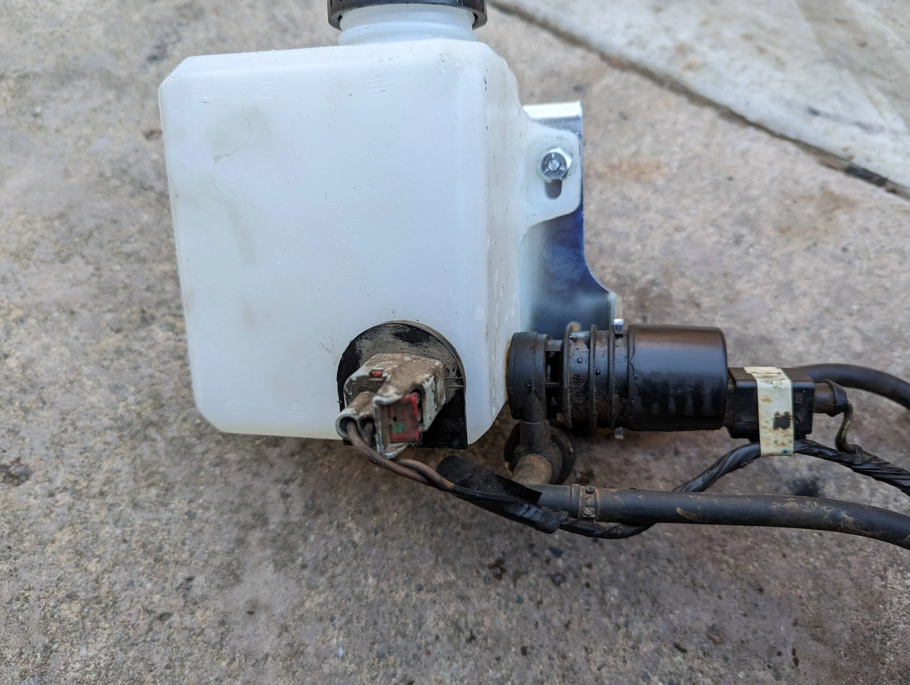

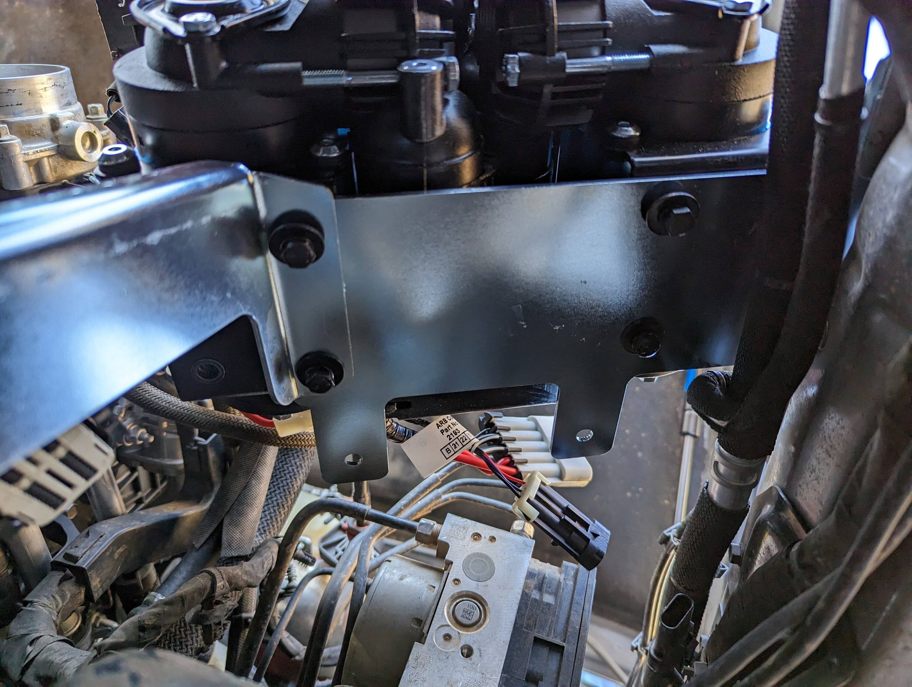

The PCM gets disconnected from the bracket as well as the stock windshield wiper tank. The new bracket mounts the PCM at an angle below the bracket for the dual compressor. Like in the pictures, the new washer fluid tank is about 20 or 22 oz and gets mounted on a bracket by the brake fluid reservoir, and uses the stock sending unit and low fluid sensor.

I'd like to see pics of the install completed. Looks like clearances near the A/C lines are tight. Especially after you get the compressor filters installed.
Clearances are fine like I said if you go to my Instagram I have a video up I tried to post it here but it was too big of a file. I've already used it a couple times and it's really nice to air up 40-in tires in about 10 to 12 minutes from 3 psi to 28 PSI. Just like on my JK I just moved the AC lines just a little bit so I have about an inch of clearance I also have a remote air check on mounted on my front bumper. Later on I'll take a picture of the clearances if you need me to....

Ah, so the kit includes the new replacement tank. Your photos only showed an old tank; I was wondering if it maybe the replacement needed to be junkyard sourced.
I never showed the old tank as far as I know that little white one is the new tank like I said I posted a video up on my Instagram but you could always go to his website and look at the pictures he has he has lots of them and actually I saw another post here that somebody already made that had just a couple pictures.
I think it was the new tank with the old pump installed.

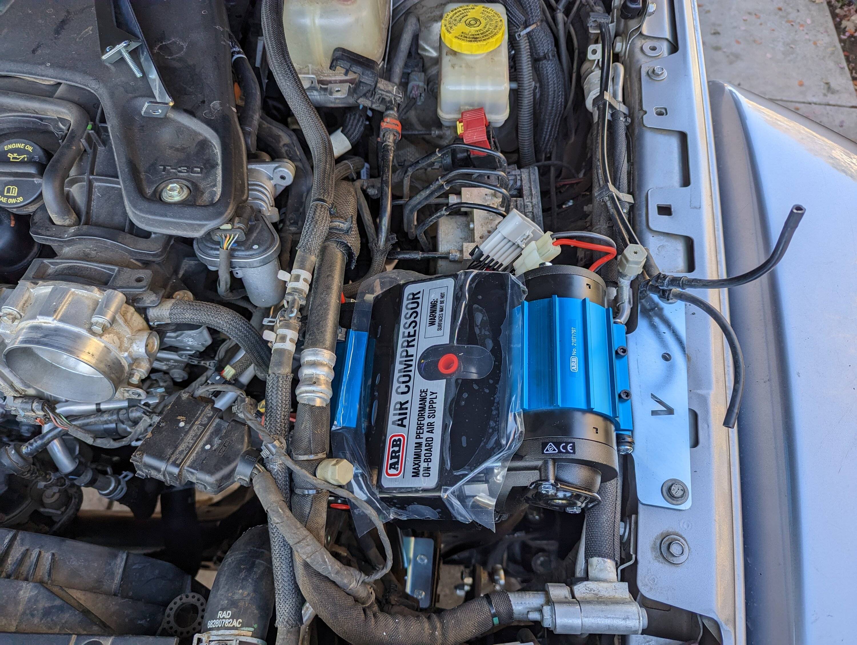

Here’s what the Grimm Mount looks like on my JLR 6 cylinder. It includes the switch. Very clean and an easy install. The compressor is behind the wheel well and has a heat shield.
