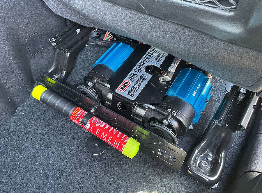

I used this mount for the regular seats. When I added the Armorlite flooring, I had to cut a little bit of the flooring out so I could mount it directly on the floor. No issues at all and a great kit.

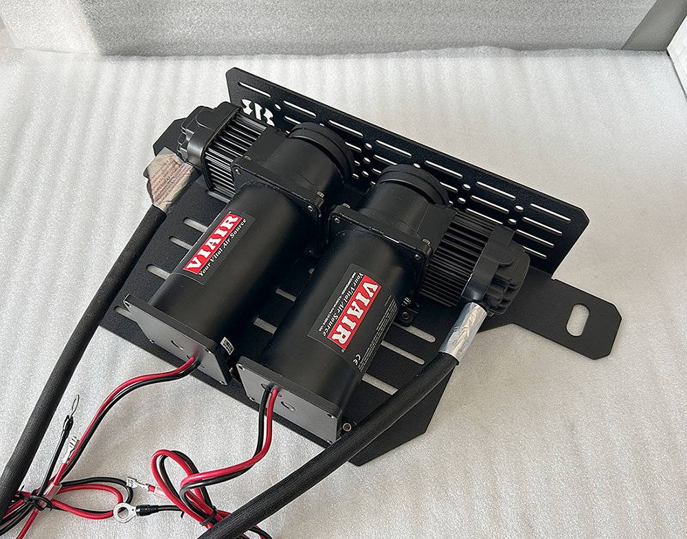

My Under Front Seat Mount will work with the power seats with no modifications needed. I made some adjustments to the mount last Fall for the power seats. I have the newest updated mounts in production now. I made a few tweaks for the new brushless compressors to fit. The mount will now hold the classic ARB twin and single as well and the new twin and single brushless on either driver or passenger side. It will also hold several of the ViAir compressors including the new ViAir VMS 400 dual setup. All in one mount :)
I should have the mounts from production within two weeks.
https://813fabrication.com/products/jeep-jl-gladiator-under-front-seat-compressor-mount
Let me know if I can answer any questions!
Jeep Wrangler JL arb dual compressor mounted under power seats UFS-0001-1-1
Jeep Wrangler JL arb dual compressor mounted under power seats UFS-0001-1-2
Jeep Wrangler JL arb dual compressor mounted under power seats UFS-0001-1-3
Jeep Wrangler JL arb dual compressor mounted under power seats UFS-0001-1-4
