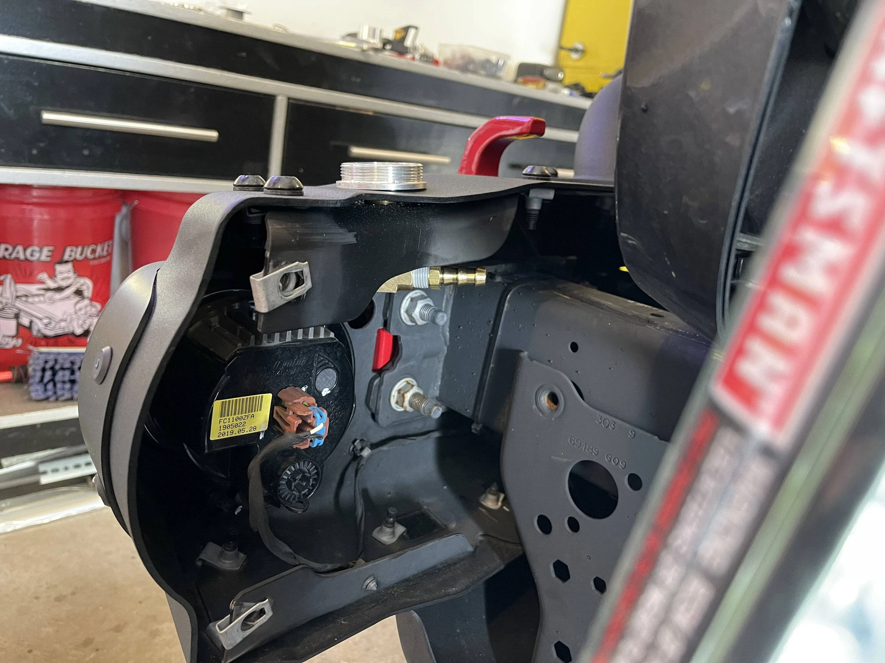

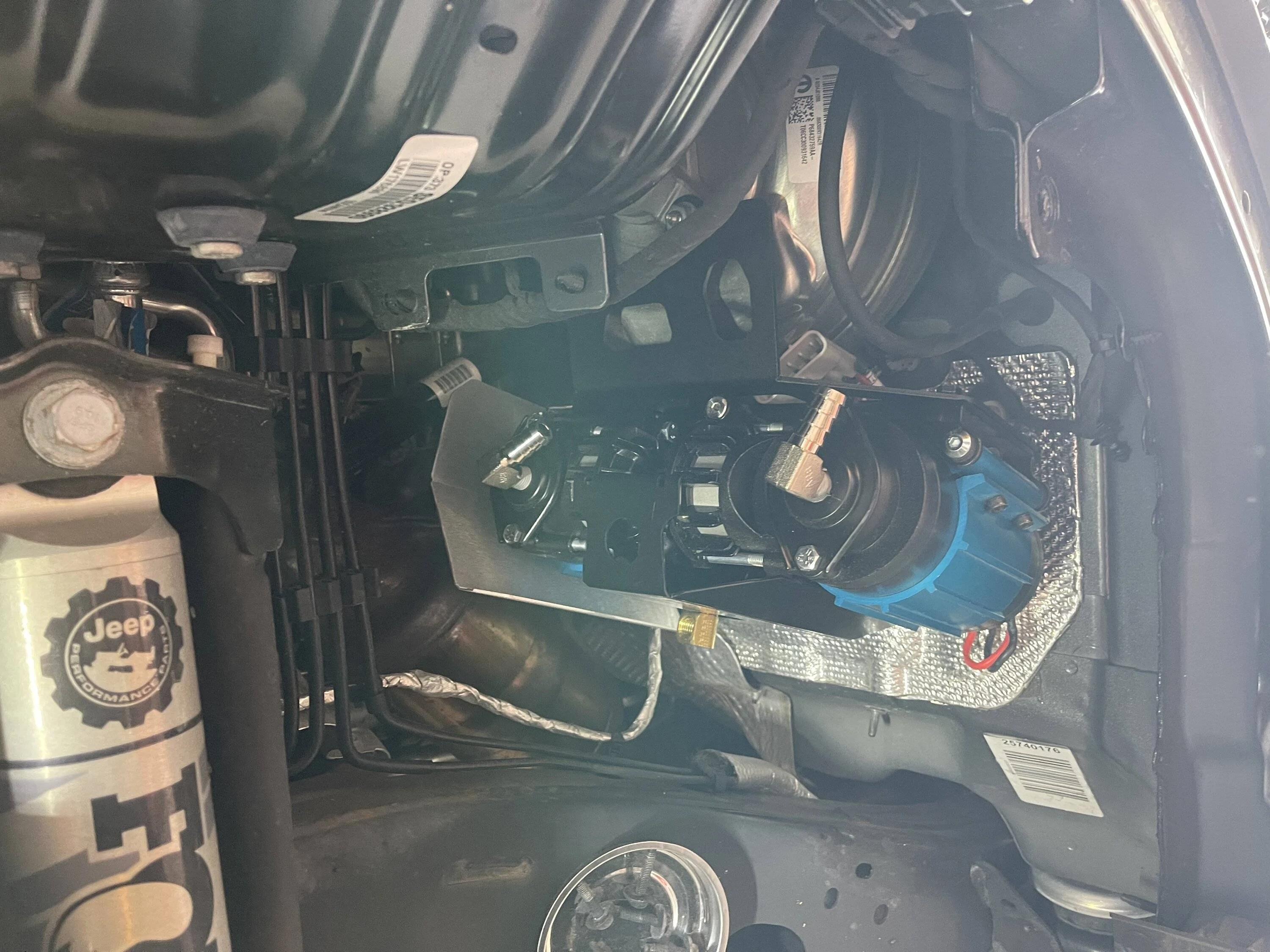

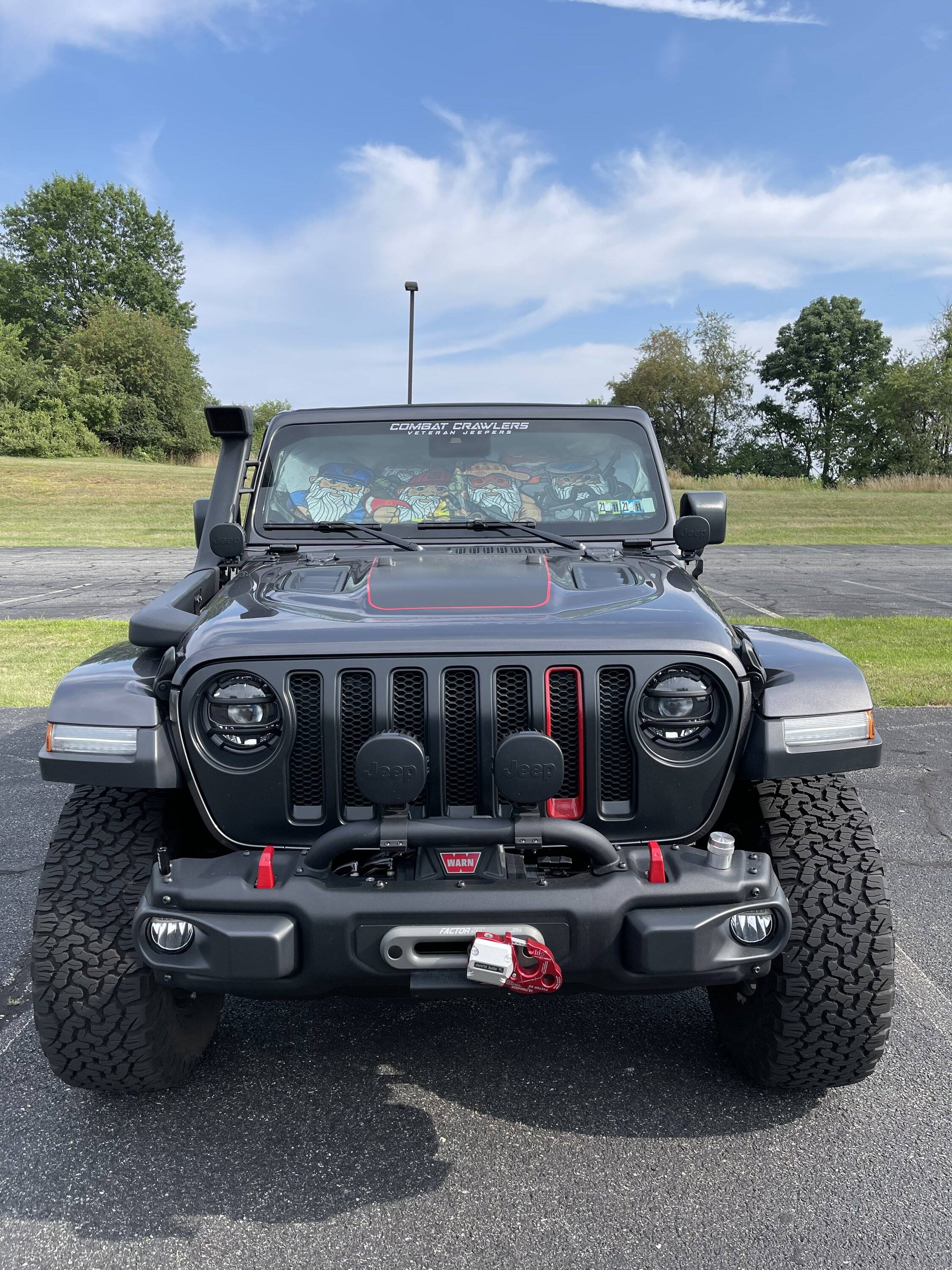

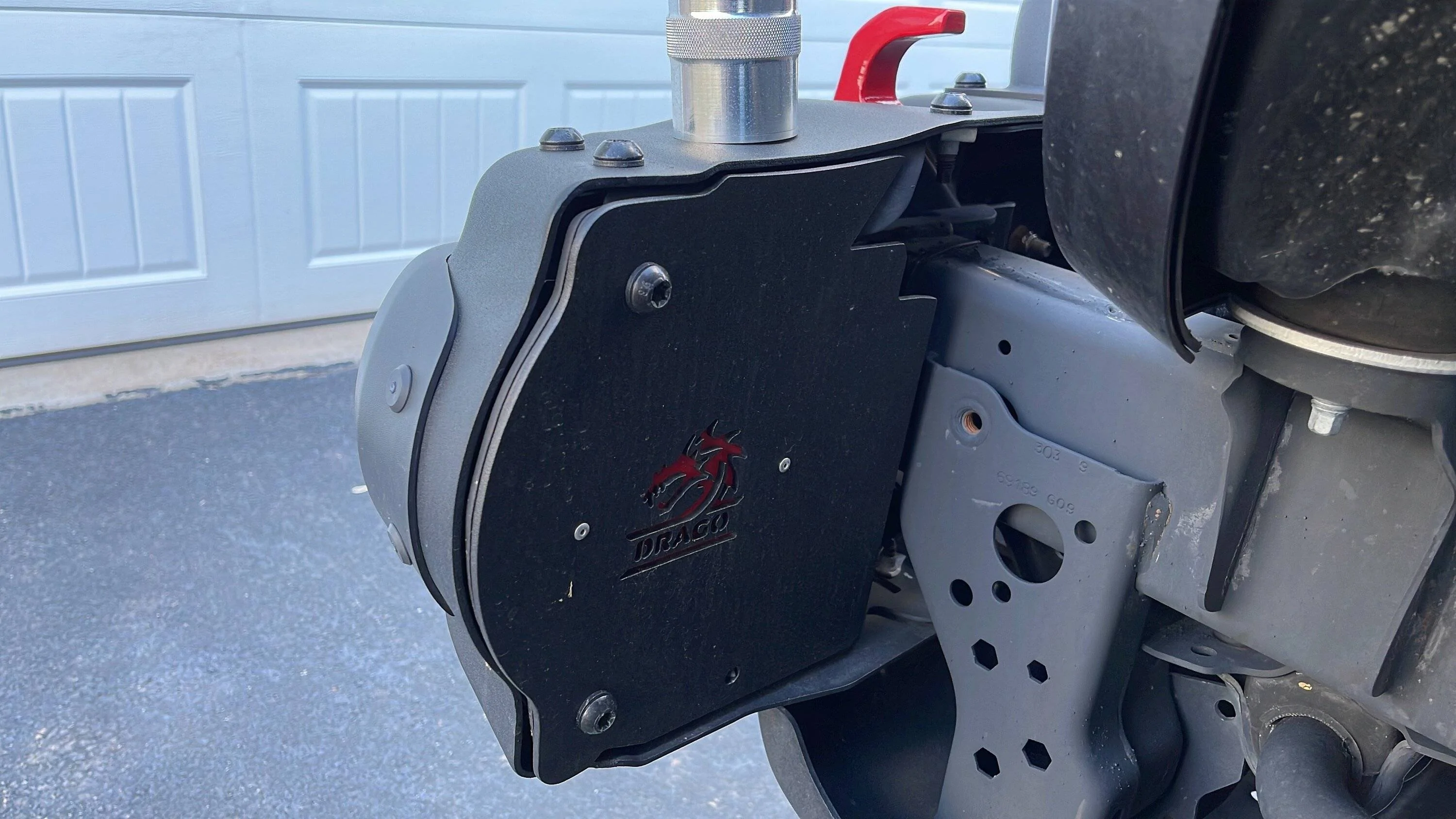

So I been looking for a good kit to Mount the ARB dual compressor and highly recommend the Grimm fender kit. However I didn’t want to have to lift the hood so ran switch wire to aux switch and used the switch for kit to run under hood lights. I also ran the hose to the front bumper and installed a Sherman cap to keep dirt out of air chuck. I also placed a cover on back of front bumper to protect and keep everything looking clean. It came out pretty good I think. Liked the heat shield and the remote air filters on the Grimm kit. Highly recommend

2021 Jeep JLUR
