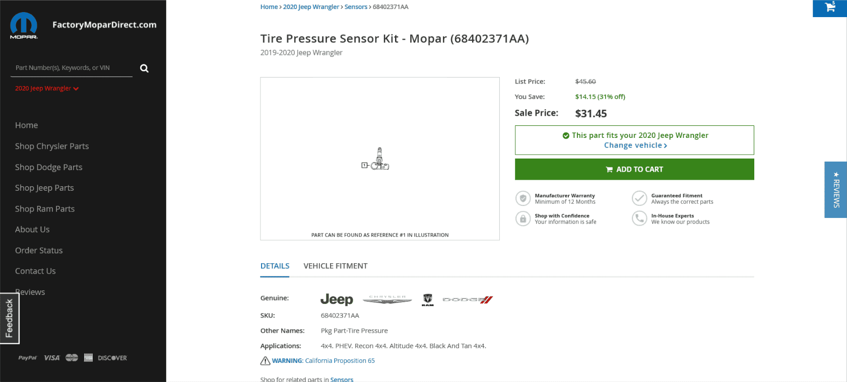

Hate to beat a dead horse but...
Looking to order Mopar sensors. Looked up parts by VIN and this is what came up. Neither the part number nor the price is familiar. Can anyone confirm this is the sensor that currently comes on the 2020 JLUR? In addition, has anyone ordered from this specific website?

I called my local dealer and verified that my 2020 JLUR has a new part # for the TPMS, they are about 1/2 the price as the older JLs. Similar for the 2020 JT. It is a different part number and cheaper.
here is the Part number I was told matched my 2020:
68402371AA
I have a set of 5 on order (they were not in stock).
