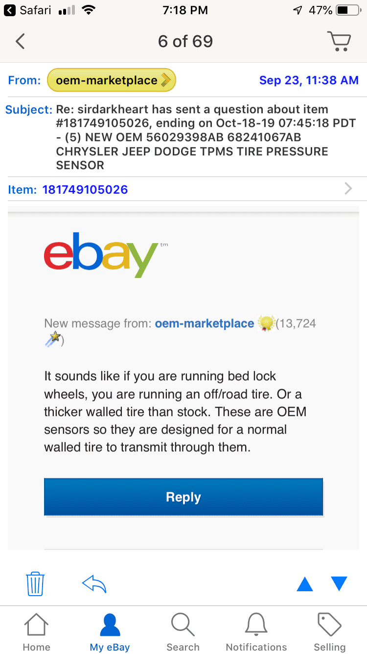

Just to prevent others from the same issue I bought these for my 35” cooper stt pros and had no problem. Then bought 37” cooper stt pros with method beadlocks 3.5” and they don’t work properly. Only the front two will pick up and sometimes the front right will drop out. I’ve had them on for weeks now.
The eBay seller even said it’s bc of the thicker tires. See screenshots for proof.

Funny that you mention the Method wheels. I have put over 10 sets of these in various aftermarket wheels/beadlocks and the only time I had an issue was with a set of Method wheels. I noticed when looking at the placement/angle of the sensors in the Method wheels they seemed different than others I've put the same sensors in.
I also had 37x13.5 coopers on 17" KMC's with no issues
