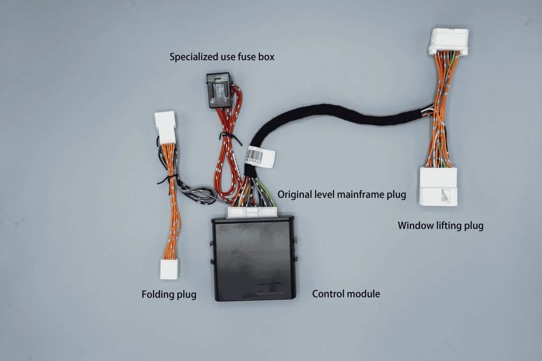

Not sure if it's possible, but my MINI will roll the windows up / down with the key fob when I press, then press and hold the lock / unlock button on my fob.
Can’t be done. The JL window controls are not tied into/integrated with the rest of the vehicle. They are independent of the body control module and the CANBUS. There's no way of "programming" the power window system.
I used to use JSCAN and within it, there are options to enable express down for passenger and rear windows. It doesn’t work.
