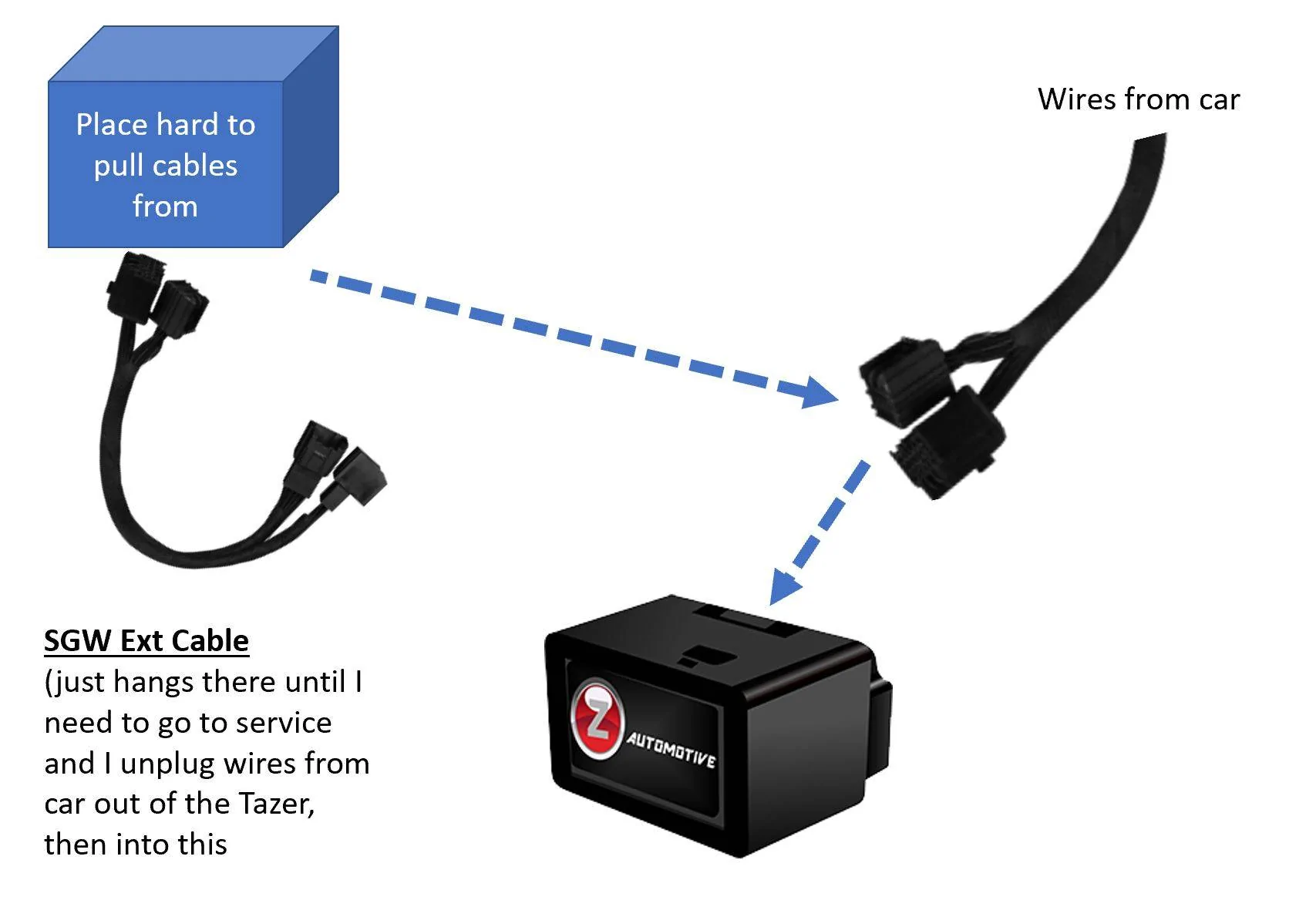

OK....so I got finally got the damn plugs out (with the help of dry spray lube) and the SGW extension cable installed....now I have a new problem.....the Mini Tazer module doesn't work...is the module LED light supposed to go on when plugged in to the SGW cables? Mine doesn't and I can't get it into the "menu" state...I've watched Youtube video's and nothing works....very frustrating to say the least....

Yeah, it lights up right away…. Did you use the SGW correctly? For me the SGW is only used when I remove the Tazer and go into service. It basically hangs up in the dash. So the plug doesn’t need to go all the way up into the dash, it goes into the SGW extension.
Crap, I just reread what I wrote and it makes no sense… I wish I had a picture.
Edit [added picture] OK, I did this in 2 minutes with PowerPoint (DON'T LAUGH - I'm trying to help): Is this how you are set up?

The Tazer light definitely turns on when updating with the USB cable. Then it's plugged in to the cable ends that where plugged in to the hard to reach spot....actually the only way it can be plugged in. NO light turning on....I'm starting to wonder if something wrong with the SGW cable...however everything seems to work in the Jeep as far as I know. Not sure what SGW system does...
Have you looked if any Pins were bent removing cables. Bent pins want connect correctly. Just to make sure you are not using the SGW extension with Tazer ?

The Tazer pins are male...none are bent...the extension cable when plugged in the hard to reach connector has male pins, so Tazer can't be plugged in to that. The other cable ends that where plugged in to the hard to reach connector are female pins, this is plugged in to the Tazer. The wires look ok, but I'm wondering if something got messed up when pulling on the cable to remove it....?
