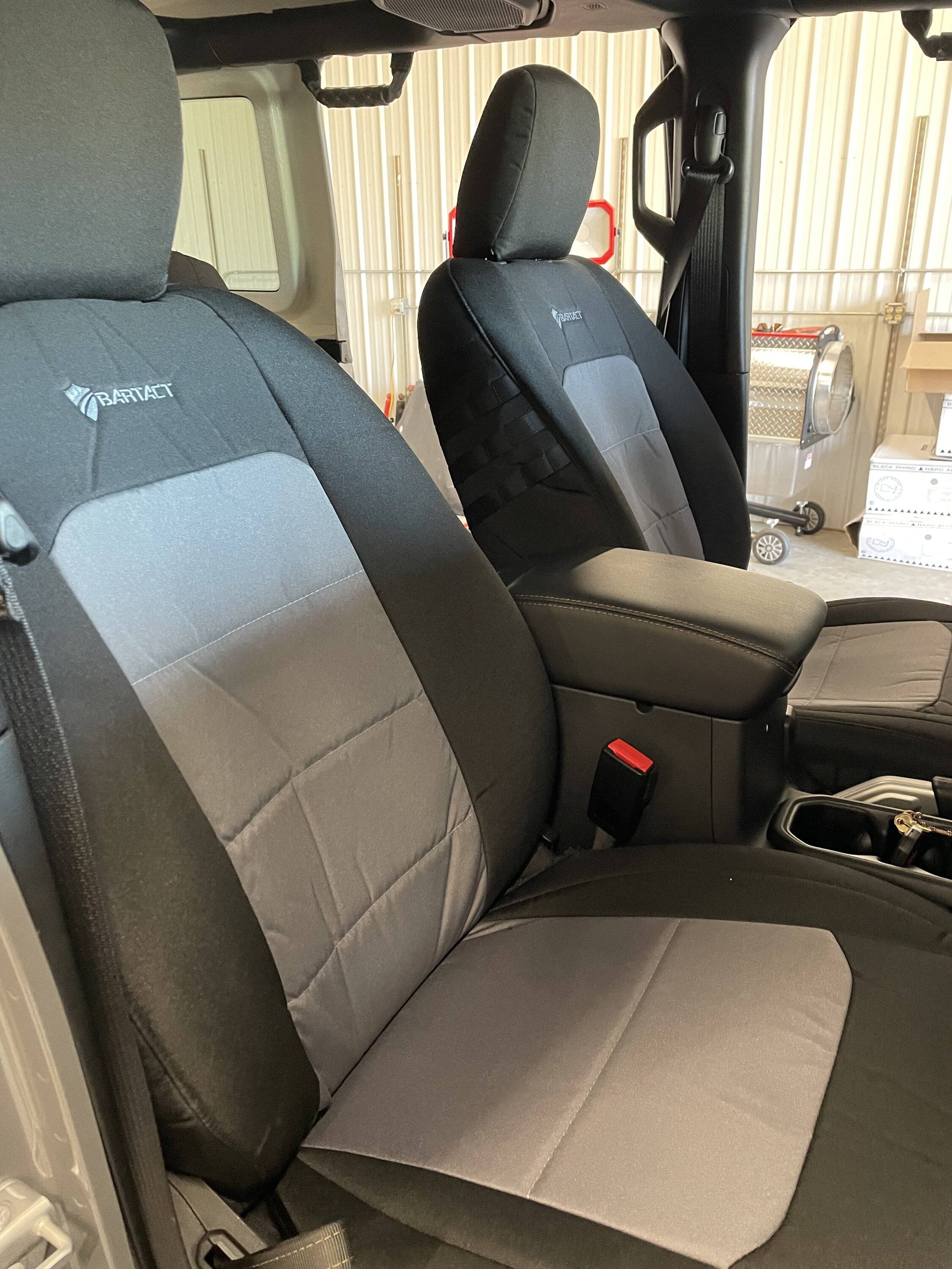

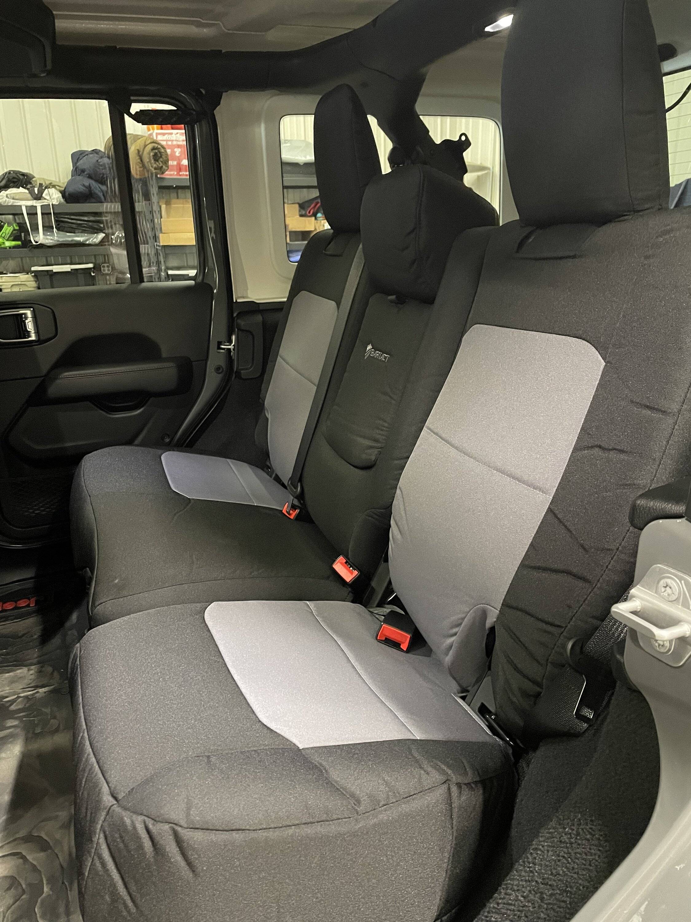

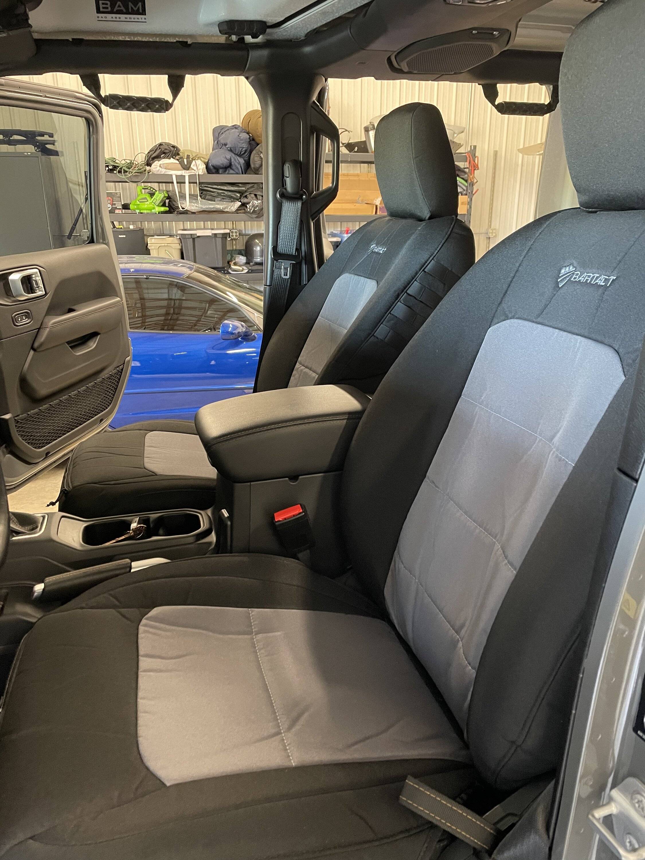

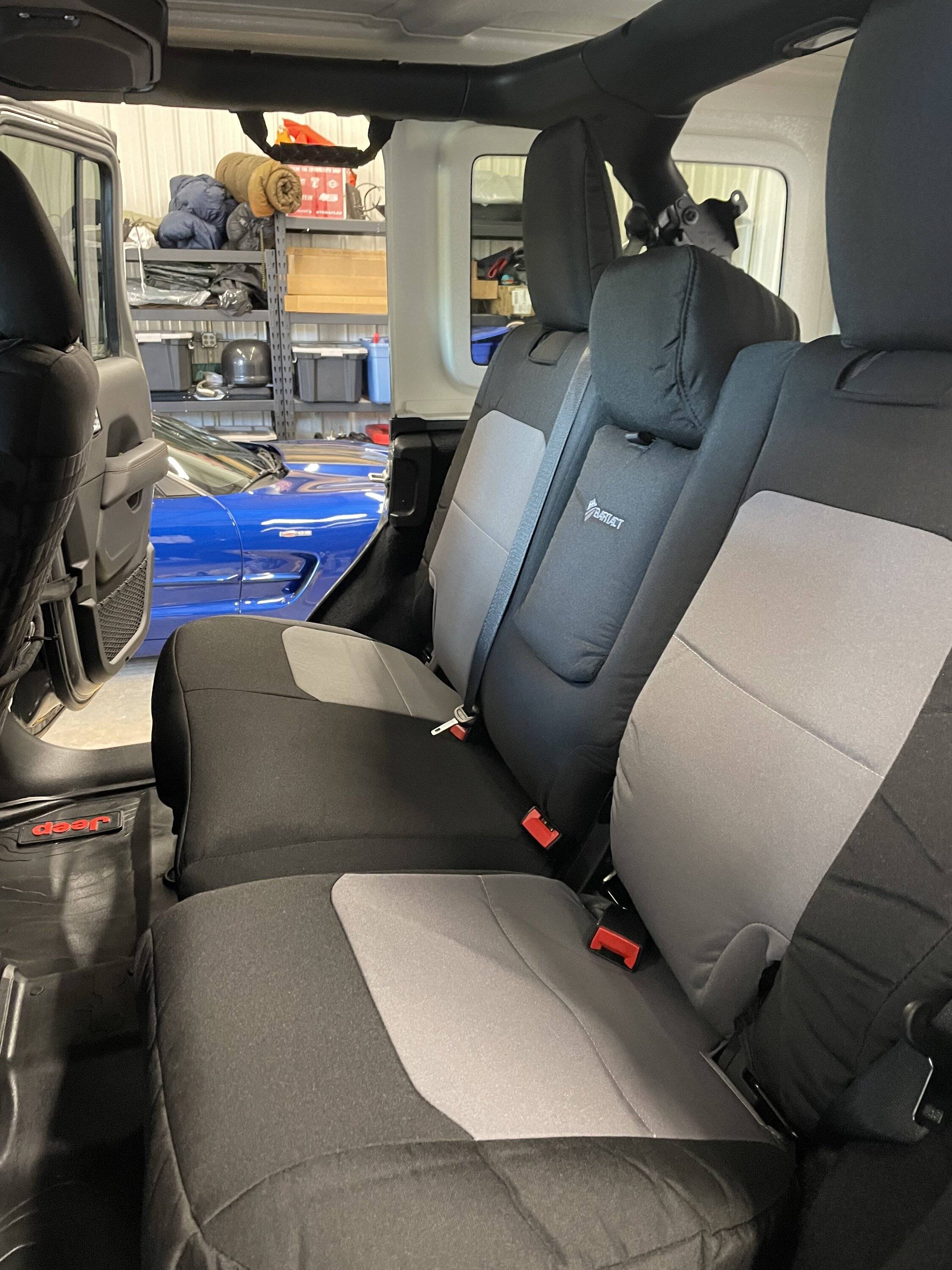

Amazing how much easier these things are to work with in a warm day!
For those that read this in the future, wait for a warm day or make sure you have a heated garage!!!
They will def need some tightening up once they get some seat time. Thanks for the feedback everyone!
