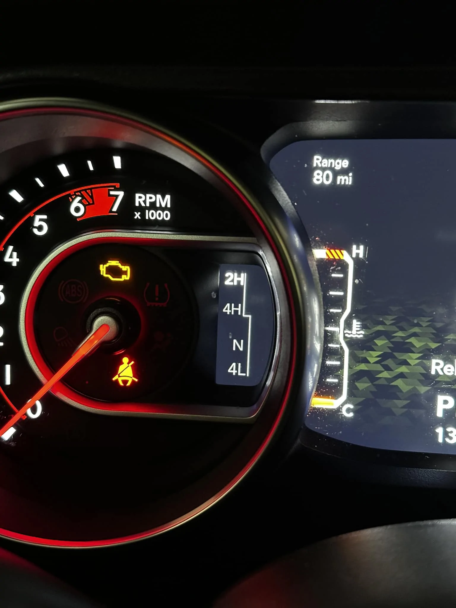

Woke up the Atlas today and Tazer new instructions that require you buy a non 392 transfer case module and have lastest rev 11.4.4. Worked perfect as I was changing axles with air locker 60/14 bolt East Coast Gear supply as well.
This is from Tazer as the instructions for this are not in lastest sheet online so Z Automotive emailed them and been great to work with.
"in the Tazer menu, then "perf" and then to "set transfer case 4 low."
Hold the left arrow on the steering column and pull the high beam stalk towards you and press the cruise cancel button. On the screen will show FullTCase: Yes, select it to change it to "no" and then follow with a full reboot and 2 sleep cycles, u would do this after getting the atlas transfer case and dtcm."
i worked through by changing one item at time and did reboot and sleep cycle as well each time, first was transfer case, next was transfer case ratio then turned off lockers as i run Switchpro for compressor and arb lockers, Somehow during this something turned on FAD, so had to unselect that
So no test drive yet as driveshafts are coming but all warning codes turned off and dash and offroad pages show 2H. All transfer case modes show correctly

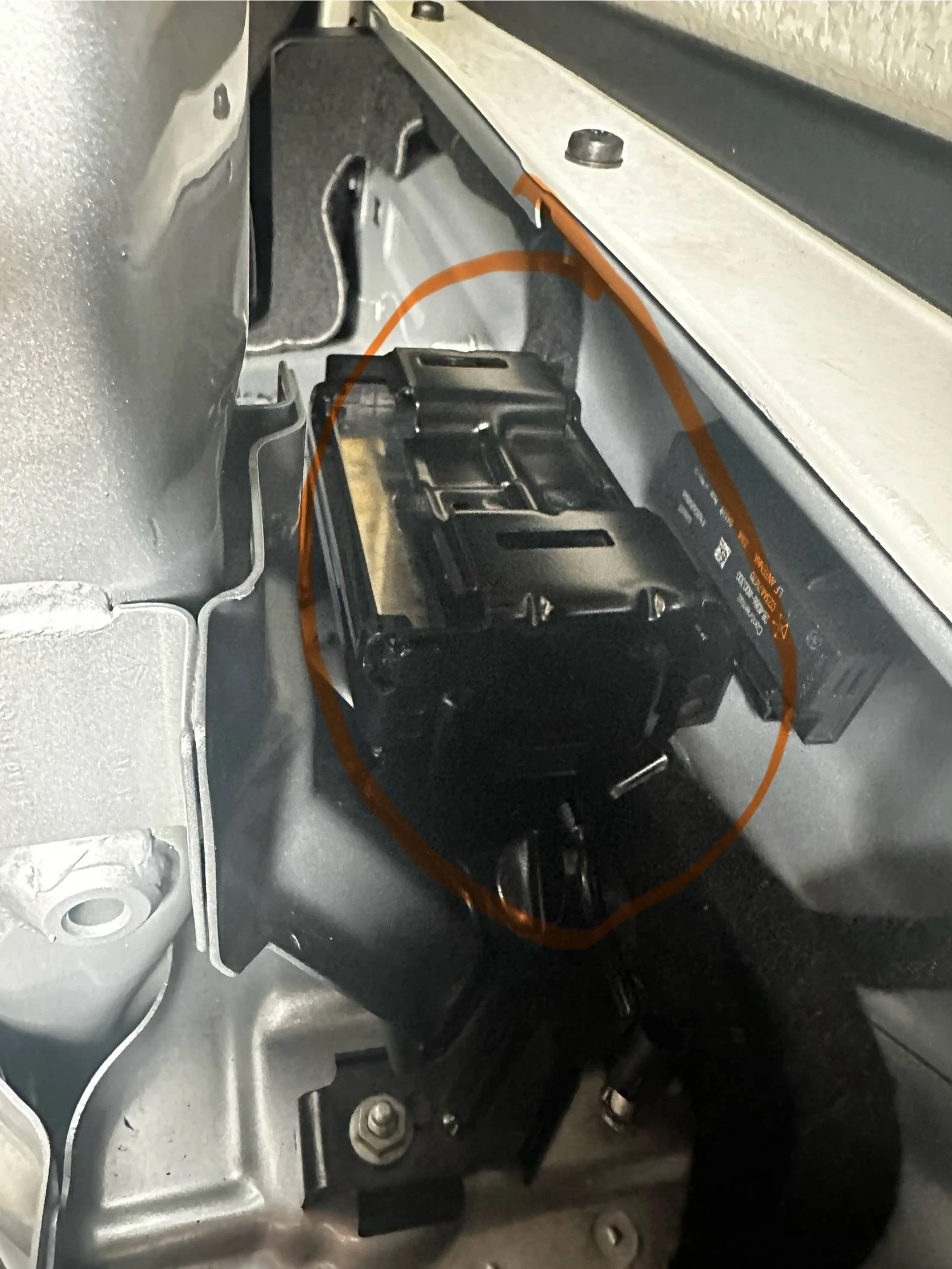

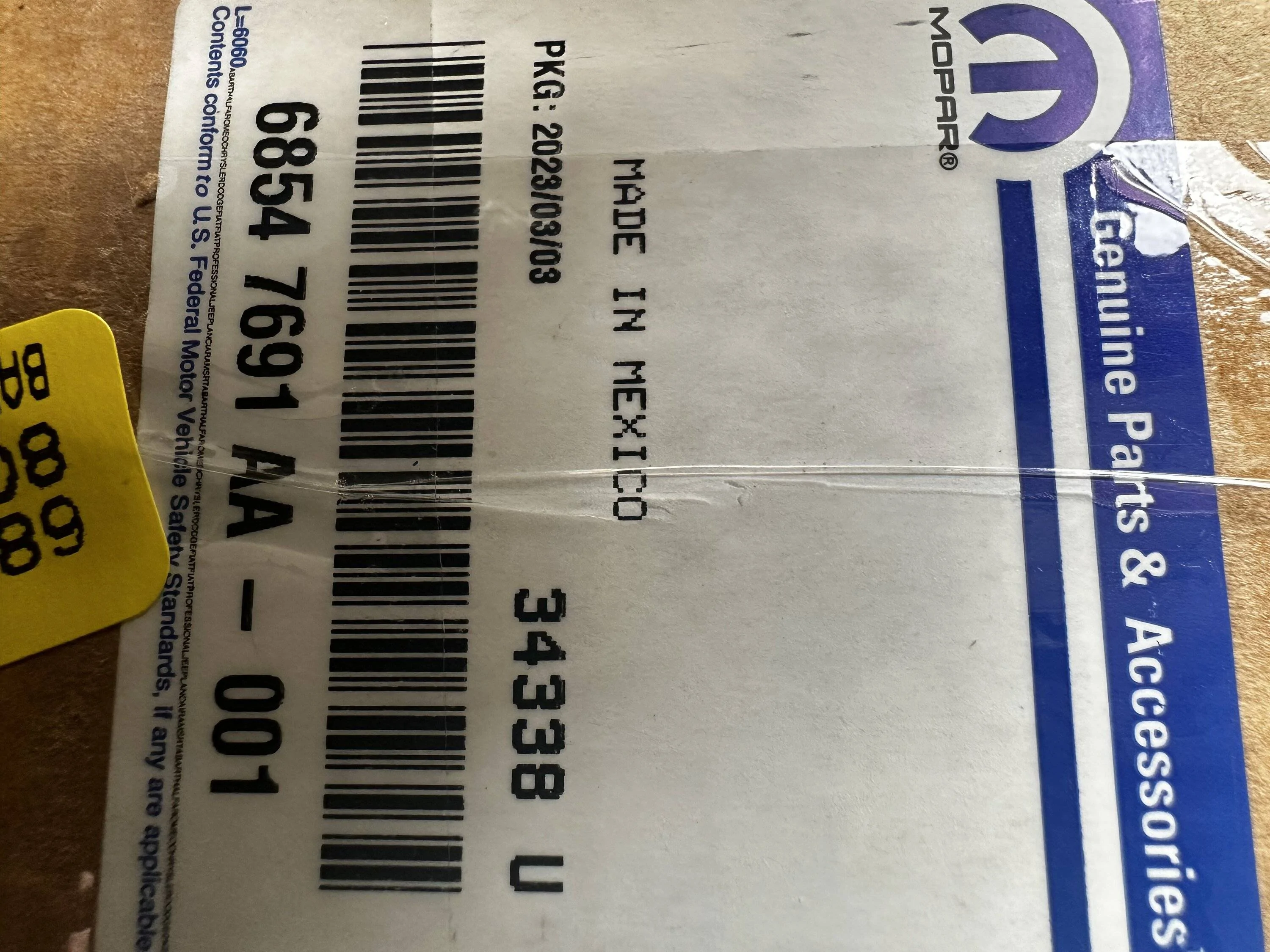

the last pic is of the DTCM (transfer case module] thats mounted in passenger rear between roll bar and the top, Just get 3.6 with lockers for your year 392

Do you have the service 4wd light coming on still?
No it was still on that’s when went back seen FAD had got turned on selected it off all good
