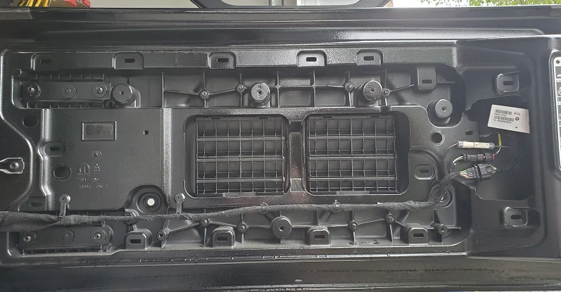

Gate frame is rectangle shape, the spare is hold by the spiderweb of little ridge.
Does make senses to reinforce that portion of the gate as the gate itself look to be really solid

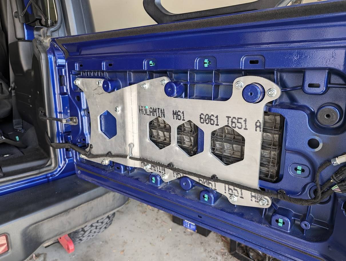

You might be interested in this:
Finally got around to installing Under Cover Fab's tailgate reinforcement bracket. Couple things:
  • Enlarged 2 of the hinge holes closer to the middle of the vehicle
  • Clearanced a small area in the middle/bottom
  • Didn't use any of the hinge spacers or outer lower spare tire mount spacers
  • drilled some additional holes for the wiring harness clips
  • Ordered different bolts & painted to better match OEM look
https://undercoverfab.com/jeep-jl-j...inner-tire-carrier-reinforcement-bracket.html
AnnDee4444
Jan 14, 2019
54
5,529
7,954
'18 JLR 2.0
This is pretty nice internal reinforcement as a alternative to the external one.

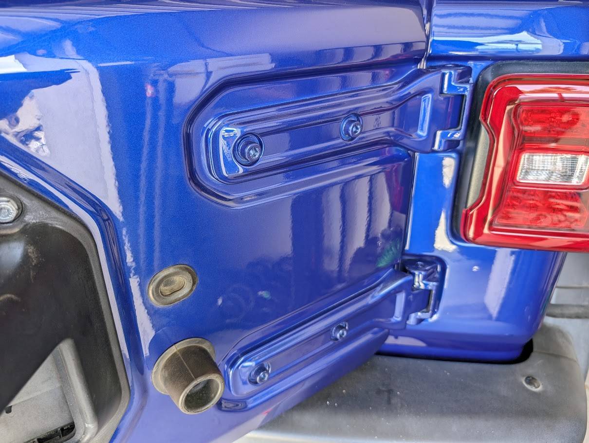

Did you replace the bolts (breaking the paint) ?
Yes because the stock hinge bolts are not long enough. The kit comes with all the bolts needed, but I didn't like the standard hex-head bolt that was included so I sourced some stainless allen head bolts & washers and painted to match. I couldn't find any stock looking torx head bolts that were long enough with the required taper, but these are close enough that nobody will notice.
