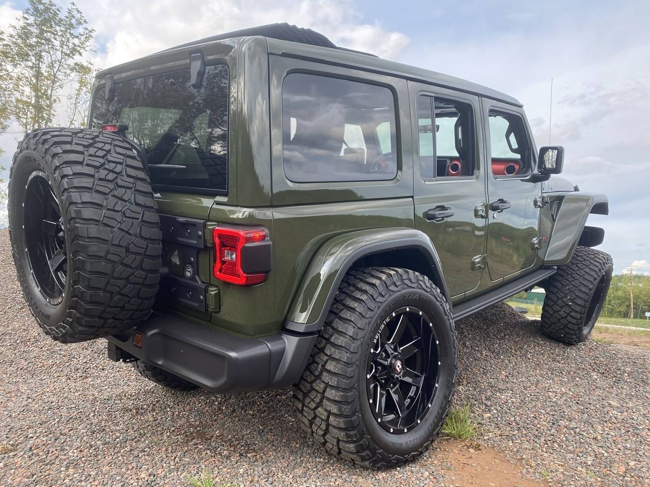

I opted for the Hinge Gate Reinforcement from the factory when I ordered the Jeep. It must be a Mopar product. It’s been holding my 325/60R20 perfectly fine with the OE tire carrier. I have -19mm offset (4.76” backspacing) with a 10” wheel, so it’s away from the carrier a bit.
Heres the best picture I have of it…
Jeep Wrangler JL Tailgate reinforcement Help!! 28418C2A-CF66-48C9-B244-EF5713E5C1E8
From the above angle it doesn’t appear the third brake light doesn’t shine above the tire, but it does.

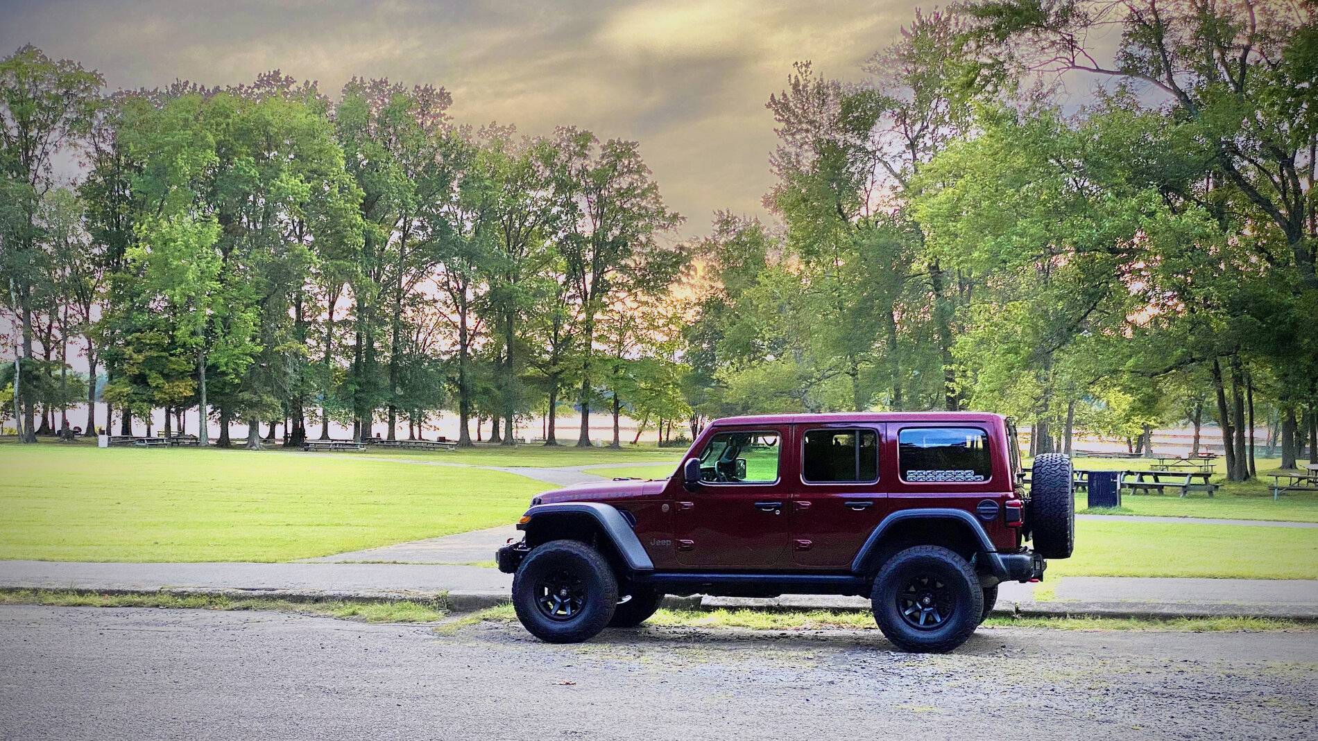

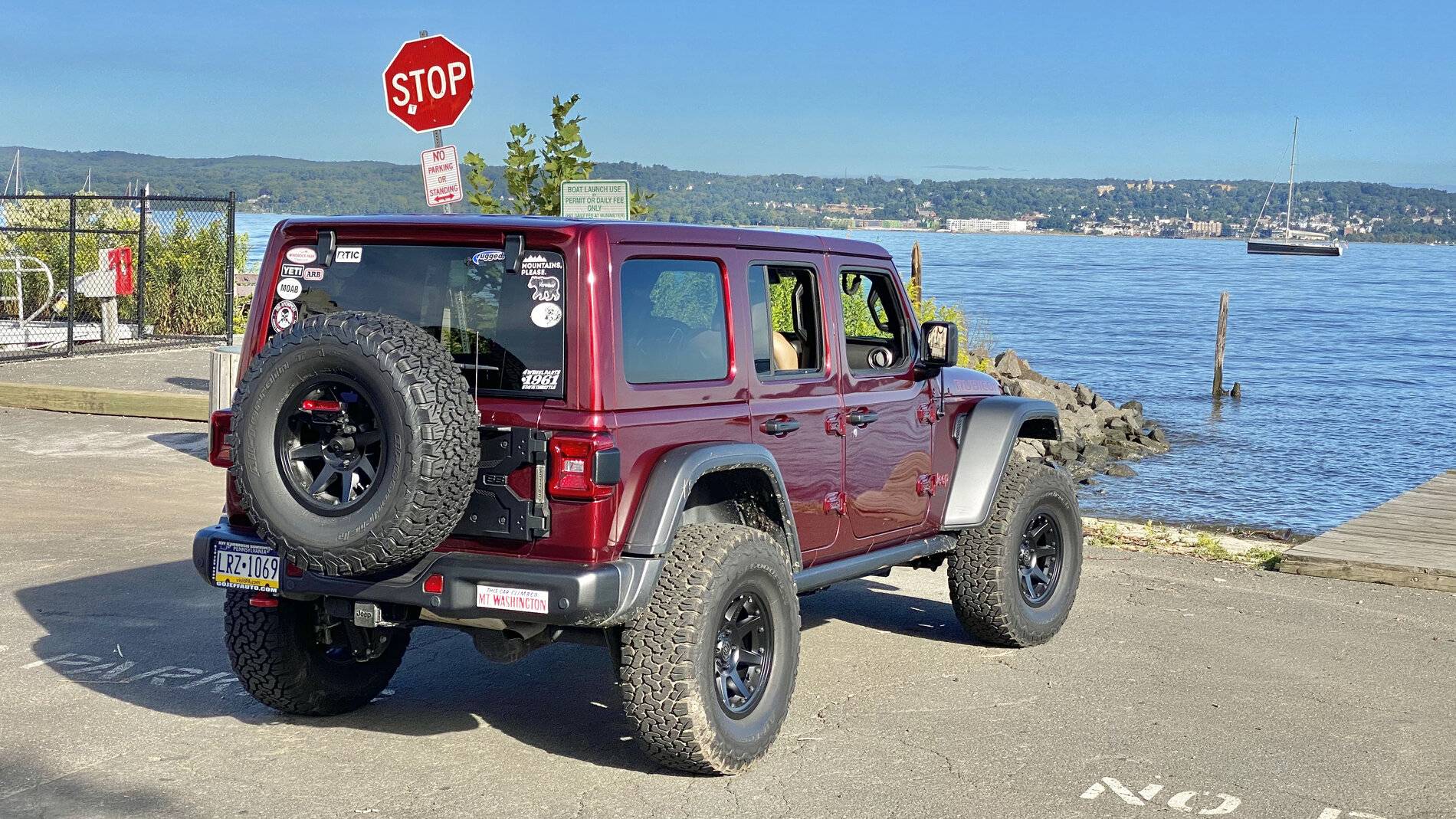

I spent weeks looking at tailgate reinforcement options. My requirements were (1) solid support of heavy wheel/tire, (2) two antenna holes, and (3) no droop. :)
I ended up going with the Smittybilt HD tire carrier (7743). Several thousand miles, solid, very happy.
