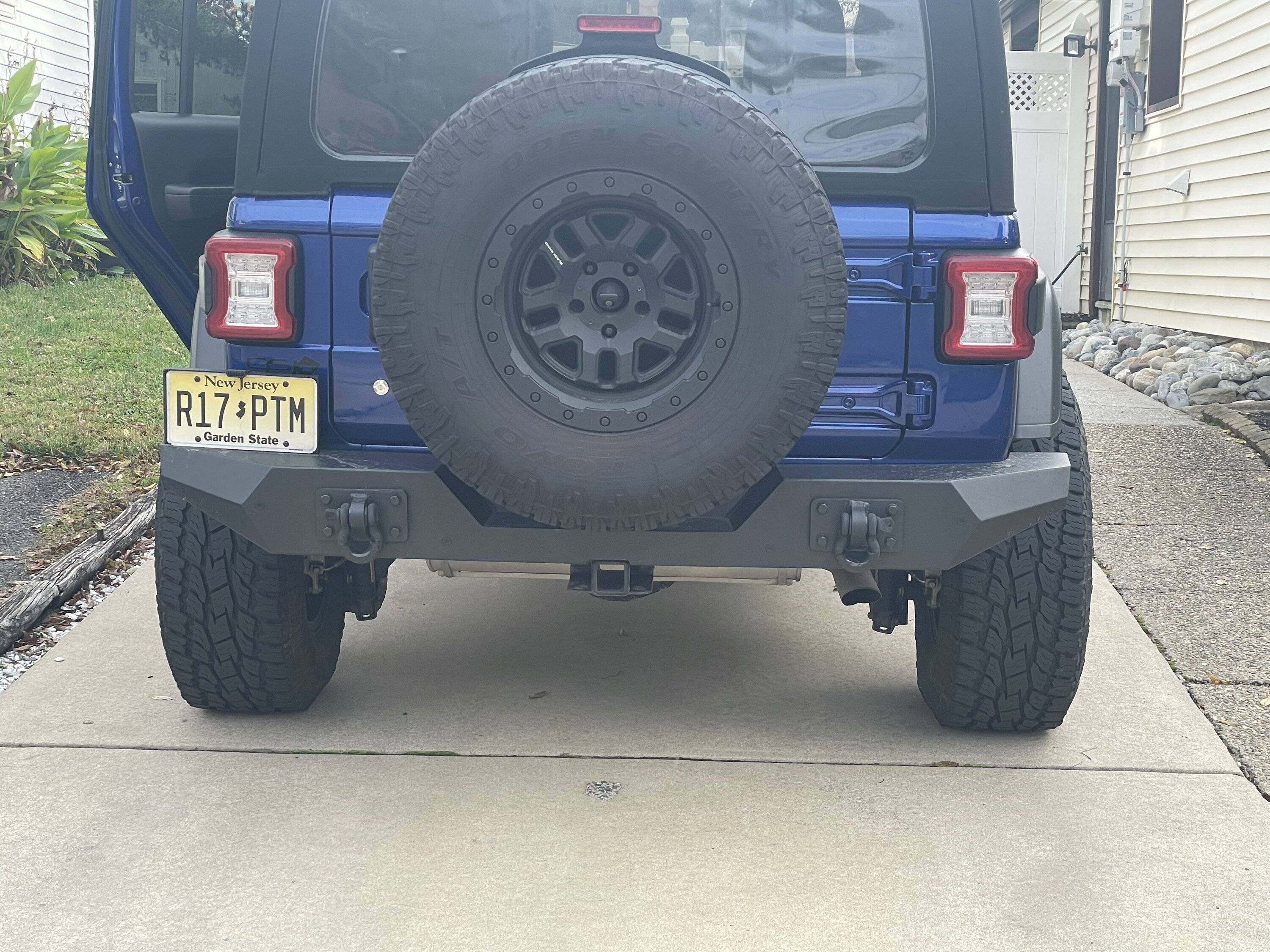

I have been running a Black Rhino Barstow and Toyo Open Country ATII on my stock tailgate for 45k miles. I wheel on the rocks regularly. Only thing I have done is extended the bump stops so they are snug against the tire and put on the latch block. No rattles or sagging to this point and still closes like the day I got it.

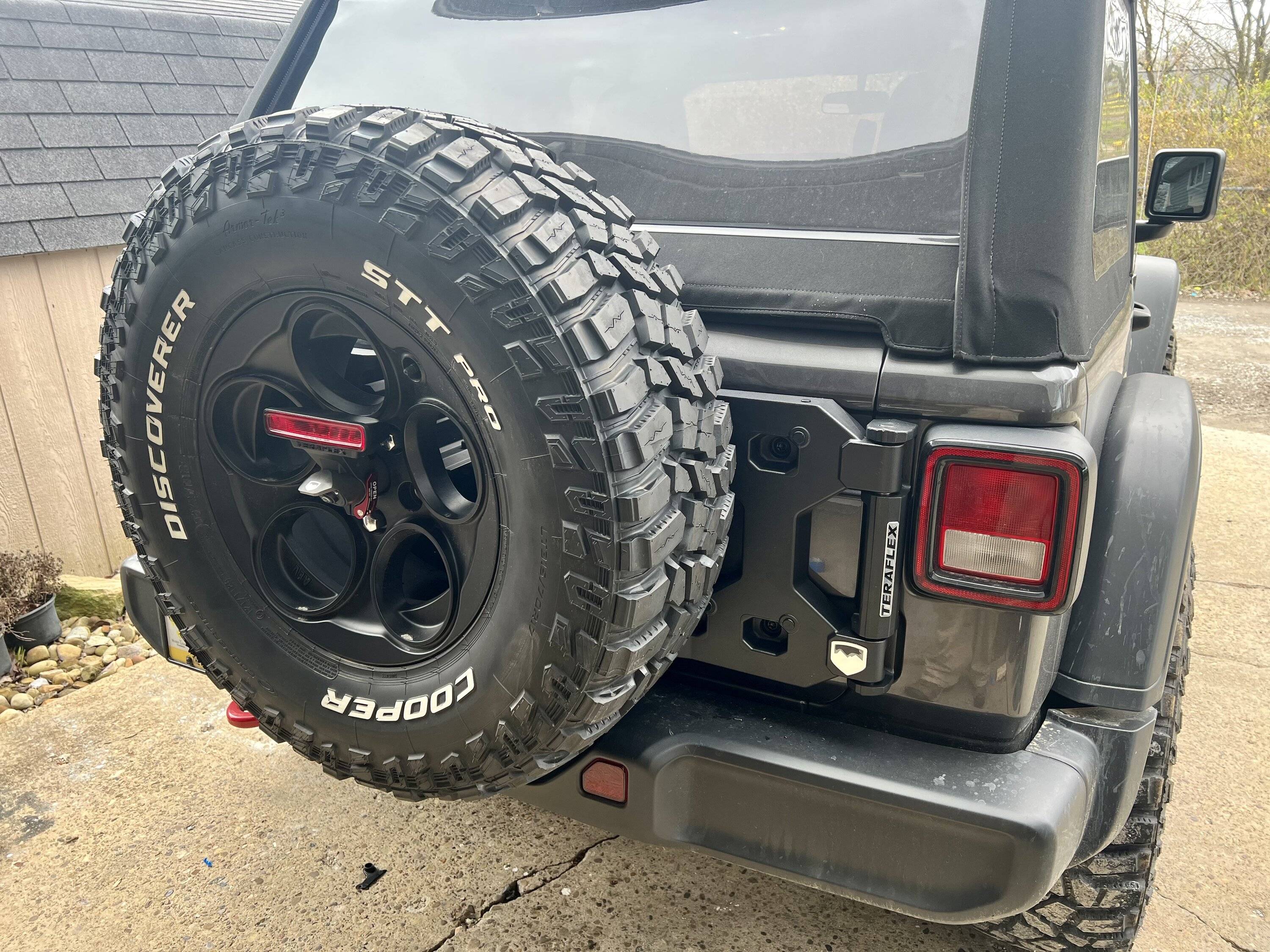

Another +1 for the Teraflex Alpha HD tailgate reinforcement (and tire carrier). Really well made, stiff but not heavy for what it is because it's aluminum, straightforward easy install. I like that the spare tire rests directly against the Alpha HD without the bumpers/spacers. The tire seems better supported when held against the entire top and bottom of the Alpha HD. My understanding of how the tire's weight can damage the tailgate is when it's allowed to move at all on the mount, and the OEM style that supports it by a few spacers seems insufficient as a tire gets bigger. Mine is only a 35" KO2 but I like to hang a bike on there too. I have a tailgate table but it's a lightweight aluminum AAL VersaTable
I regret ordering the OEM optional tailgate reinforcement. The black OEM reinforcement piece I removed was a pitiful excuse for reinforcement, especially considering what they charged for it. Please tell me that OEM option upgrade includes reinforcements inside the tailgate too. Tell me something that makes that option money seem worth it. The OEM hinges I replaced seemed like nothing special, much smaller than what came on the Teraflex.

I like my TeraFlex.
I second that.. I have the teraflex alpha HD carrier paired with the hinge reinforcement.. love it.. rock solid

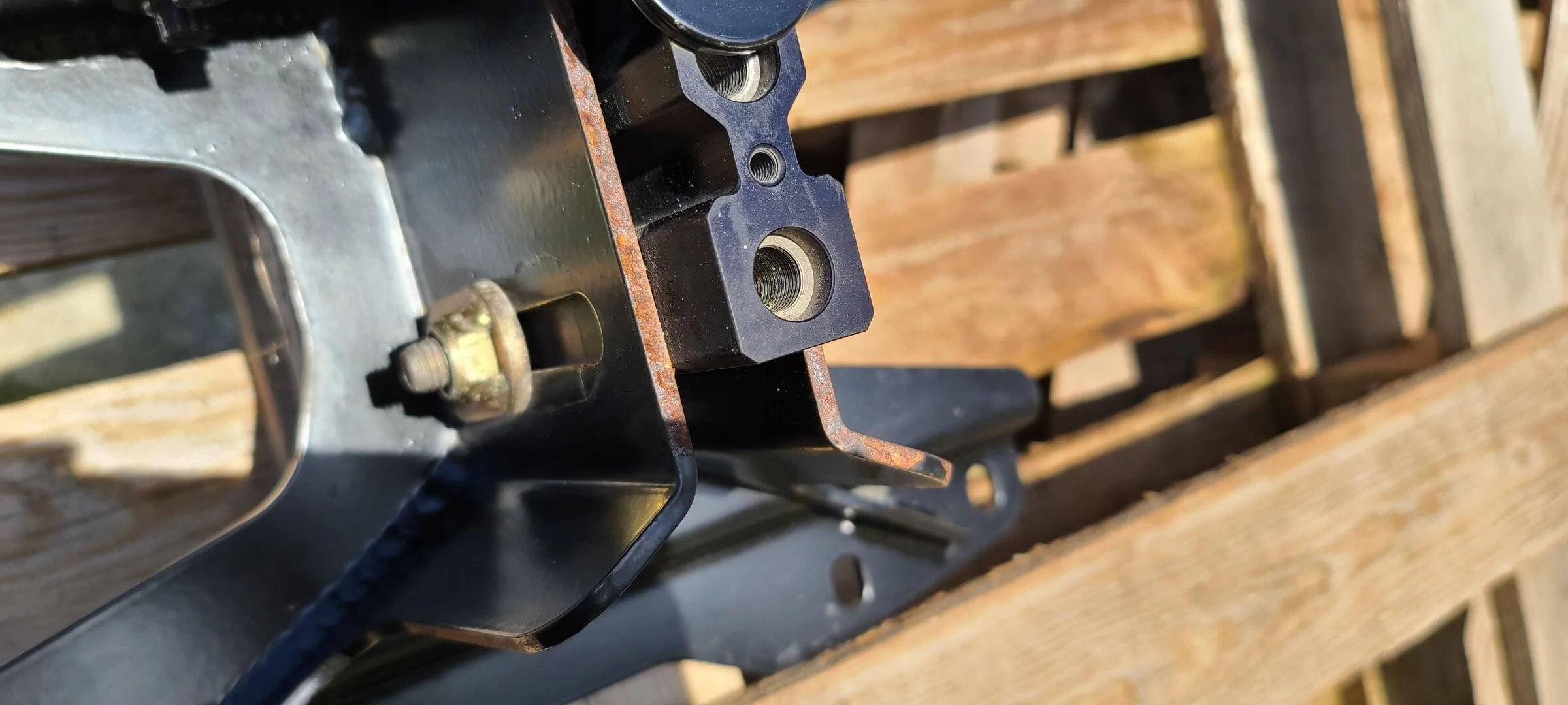

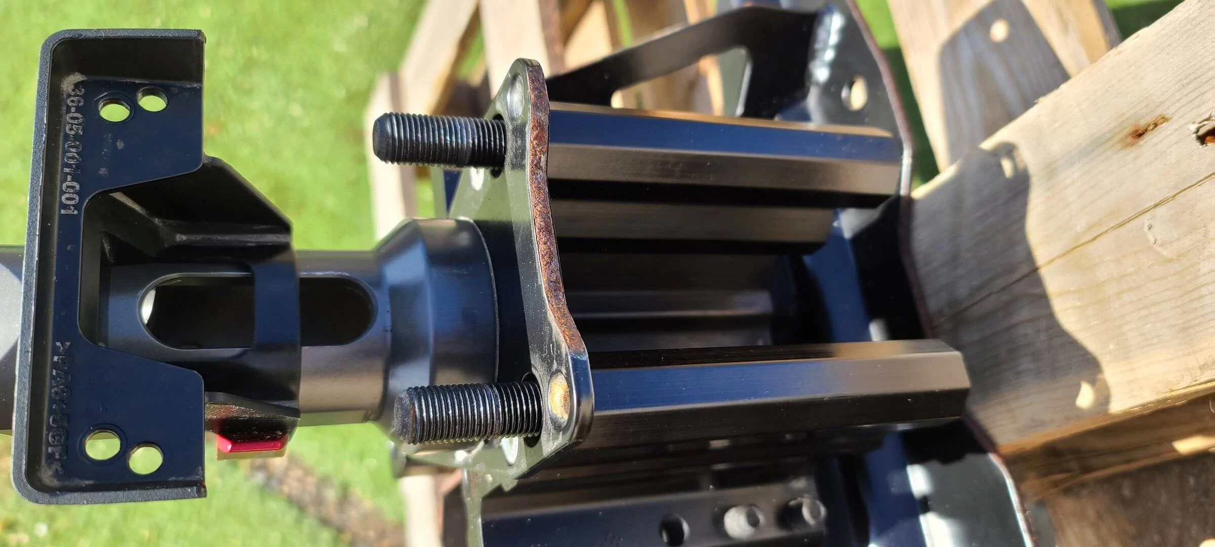

Before switching to the Cavfab Elite hinged carrier, I had the stand alone Teraflex Alpha HD carrier on my Jeep for about a year and a half. The finish was peeling off all over the carrier, starting at the edges and slowly working in from there...

I don't think southern new york winters are quite as vicious as those in MN.

Oh wow. That's not good either.

Like the other poster, I had to find a reputable powder coat shop to finish the Cavfab carrier that replaced the Alpha. And boy did I find a great company that does amazing work.
According to what the shop told me about properly prepping parts, powder coat does not like sharp corners. They don't need to be fully rounded off, just dulled with a flap wheel. Teraflex didn't do that with my carrier, but the shop didn't skimp on that prep time. 2 years later, and the Cavfab still looks fresh out of the oven.

Little touch up on those edges and looks great. Ask me how I know ?
