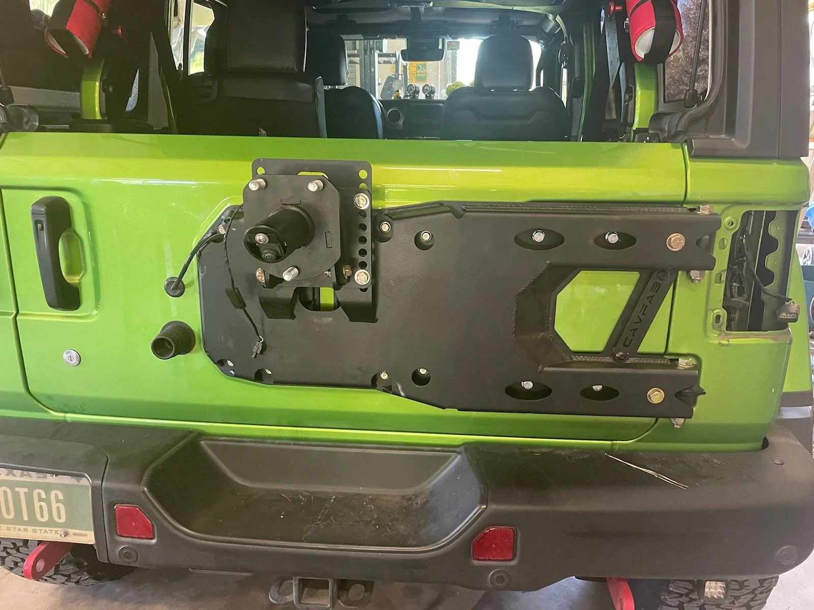

The issue is not the tailgate itself, it is the fact the hinges that do not go far enough across the tailgate so there is not enough support and over time it will sag and rattle.
Even the Mopar kit is marginal at best. There are plenty of threads on the forum that discuss this. If you think you will ever go past 35's, then buy once and cry once and go CavFab. I have been very happy with mine--no rattles, sags, or issues.

Second the CavFab, what a beast. Heavy but closes like a bank vault. Just did washboard road test, 100% pass. Dead quiet

Cavfab, get it, set it, forget it. No shims to adjust and more stout then the Teraflex.
The only downside is you need to get it powder coated but that ended up a good thing for me as I got to know a great powder coat company that I have used a few times since.

Living in MN I'd be worried about the entire inside getting coated. At least the Teraflex won't rust.
