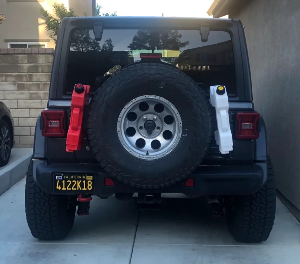

I ran a 35" tire mounted to a heavy wheel with two gas/water cans attached to the spare tire down a lot of bumpy off-road trails with no issues with the stock gate or hinge. Jeep will never say that beyond what they provided as stock is "ok" and the internet (especially tailgate support vendors) will use scare tactics to make you worry about it. One other thing to note is that the JL design is a lot better than the JK design and JK owners have been running heavy tire/wheel setups on their stock gates and hinges for 18 years.

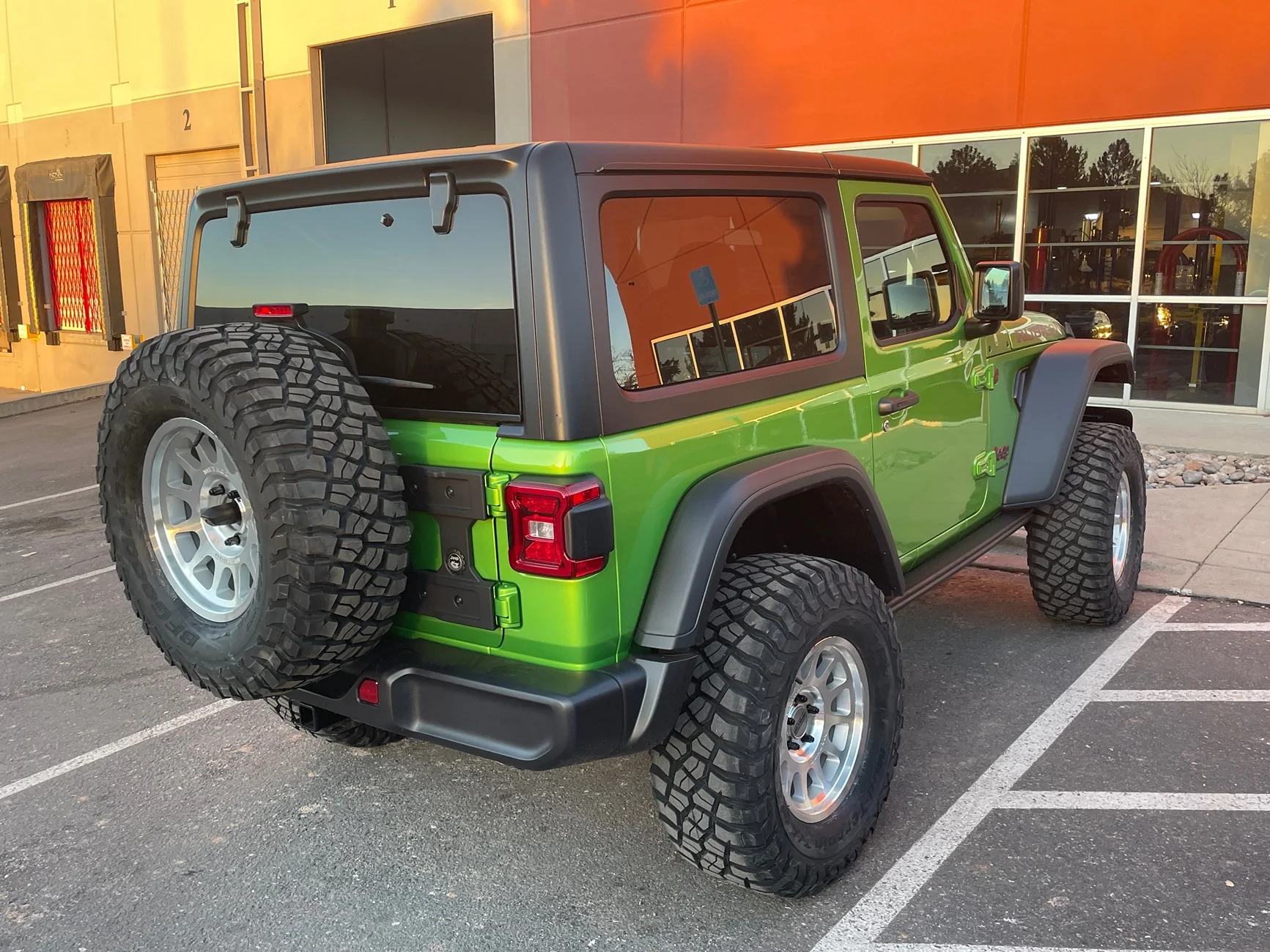

Currently, I run LT315/70R17 (E) BFG KM3 + 27x8.5 703s that weigh in around 93 lbs. I will be going to an LT37x12.5x17 (E) + 703s that weigh about 104 lbs after completing the required drivetrain mod's.
I installed the tailgate reinforcement, but not out of an abundance of concern hanging 35"/703s off the tailgate. Never had any issues with my 2018 tailgate and 35's. I did it for a little peace-of-mind when I put the 37" combo back there, however false that "peace-of-mind" may turn out to be.
