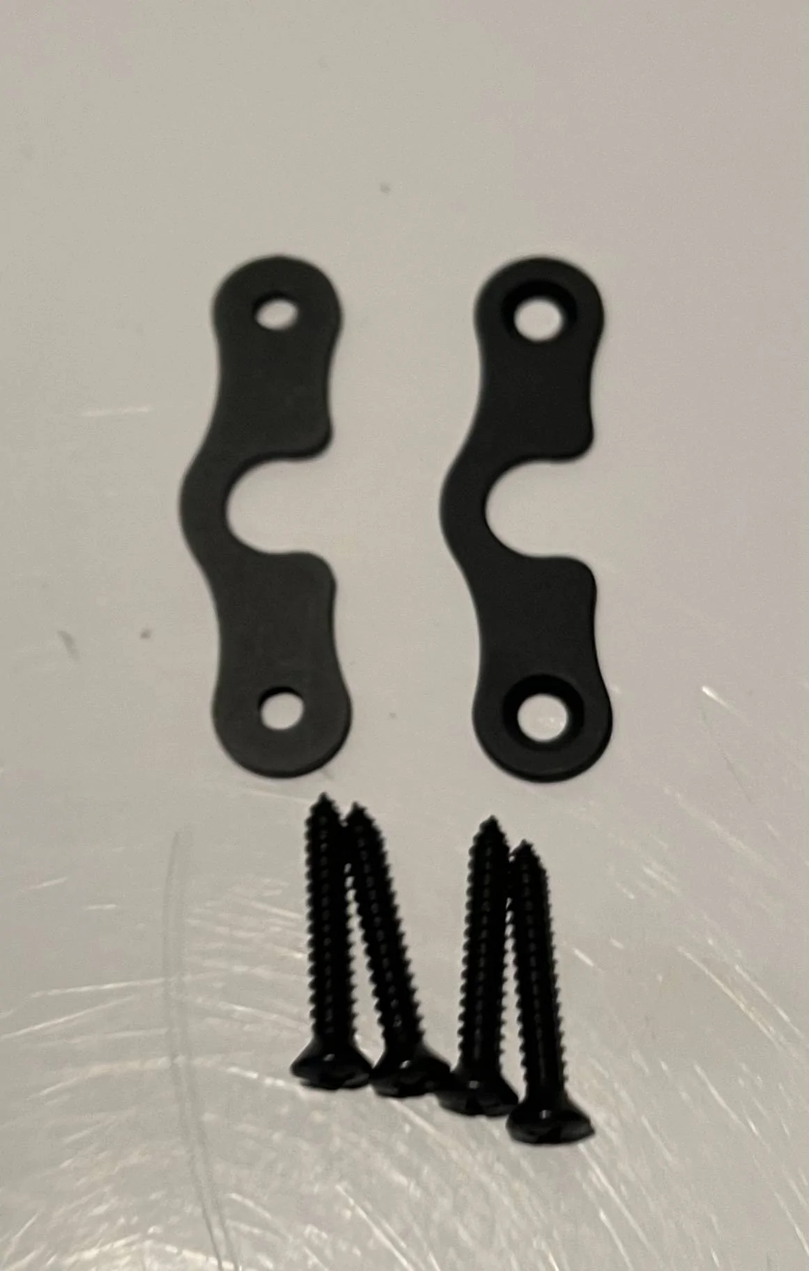

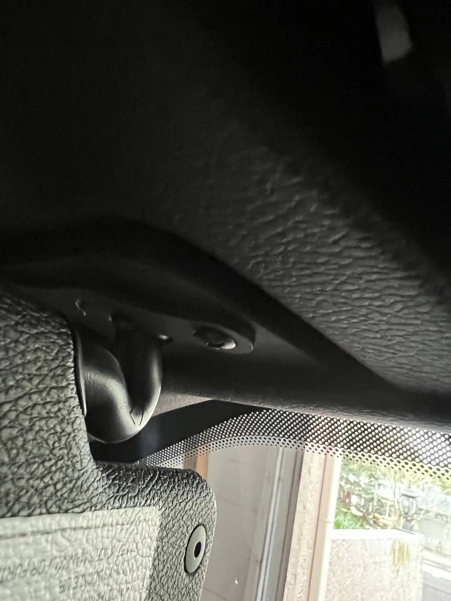

I just installed the aluminum clips from Taccom which I ordered thru Amazon. It took about 15 minutes to do both sides.
HONESTLY TO ALL … The Taccom metal double screw is the way to go!!! DO NOT get there single screw Delrin one as it flexes (I originally got this one and returned for the metal double screw design)
ALSO the other reason I recommend Taccom clips is because as a former aftermarket parts designer (BMW E46 M3 parts) Taccom is the original designer of this product. They came up with this solution for their own personal jeep and when the demand increased for one, they started to sell it. They are a US company and not a Chinese knockoff!!! There might be cheaper ones out there now, but you aren’t saving much compared to getting the original!
