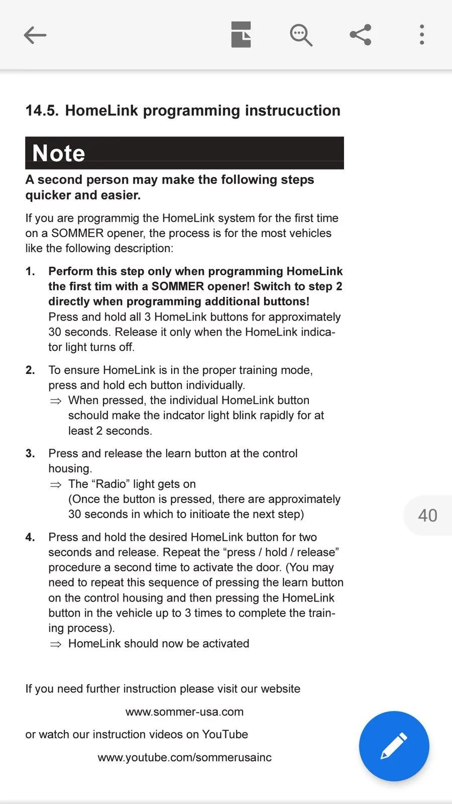

Just thought I would add this, I have a sommer direct drive opener. I ended up finding the instructions for home link in the sommer manual. It was a little different than any other instructions I found. I had to hold ALL 3 buttons down for 30 sec until the light went out completely. Then push button 1, then learn on the opener, then I think the button 1 again once or twice. I am glad that I was able to download the instruction manual for my opener that had these instructions specific for Homelink because it was not like any of the videos I had found. It works now

This is from my manual for MY opener. I started at step 1 since it was the first time i used homelink. Worked first attemp .
