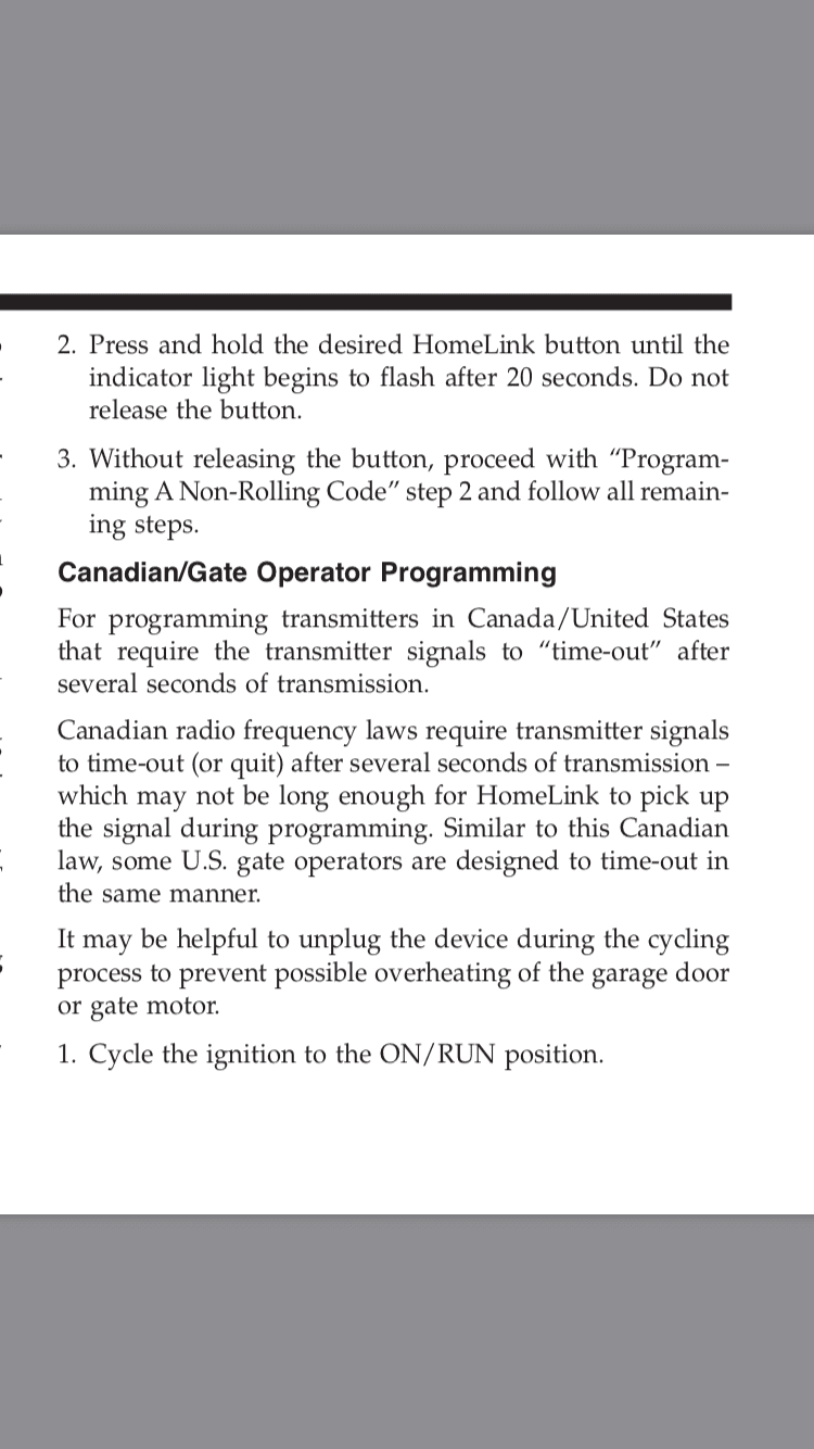

The video instructs you to hold the homelink button and handheld transmitter button at the same time until it programs. Which did not work for me. And the other way of pressing the learn button and the. Pressing homelink for 2 seconds x 3 times which also did not work. The third way in the manual is holding the homelink button and pressing the handheld transmitter for two seconds over and over until it programs which finally worked after about 45 seconds of doing it. It says it is for Canadian openers which makes sense because my opener says made in Canada on it even though I live in Florida...
Thanks for the info!!! This way worked for me as well! I’m in N.C. Greatly appreciated!
