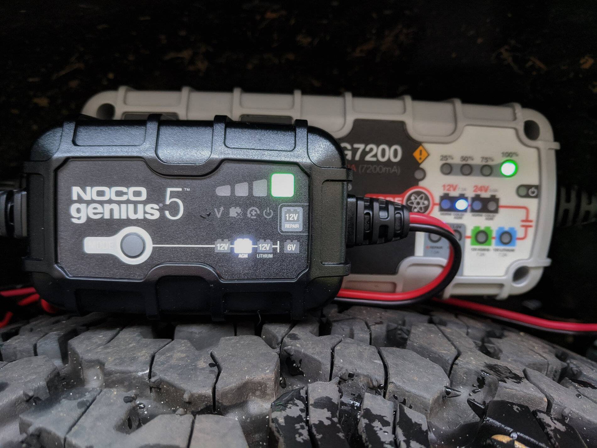

Since our Jeep is only used intermittently - we charge the aux with a NOCO5 and the main with a NOCO7200. This way both dissimilar sized batteries are smart maintained optimally and de-sulphated separately using the Repair mode. Dealer has load tested and both 2018 OEM batteries are fine and holding a proper charge. We never have a ESS problem. Each battery holds a different voltage when measured with a multimeter - which is expected.
As posted before - more than likely Stellantis put in dissimilar sized batteries to simply cut costs - and it seems hooking them up in parallel has created a battery lifespan problem. Generally dissimilar batteries should never be connected in parallel - and charged up together. Since one will drain the other and then die prematurely. Just is not a good idea and is a piss poor Jeep design.
For those concerned of a dead aux creating a non-start problem - test yours by disconnecting your aux neg lead. Your Jeep should not start on the first press - then start on the second press with a ESS disabled dash message and icon popping up. Ask your dealer to flash the necessary bypass code to enable this. Otherwise a dead aux might leave you stranded without a bypass.
We have 2 CTEK and 4 NOCO smart chargers with multiple batteries hooked up 24/7. All batteries are fine and engines always start first crank - even after sitting idle for months at a time over winter. Keeping batteries properly smart charged and de-sulphated is definitely key to maximizing our battery lifespans. PITA to separate on the Jeep - but it is what it is.

Can hook the maintainer to main battery only to maintain both batteries?
Rhinebeck01
May 9, 2018
169
12,679
19,169
Ormond Beach, Florida
Retired at 55 ..
@Pismo61
Yes, hooking up a battery maintainer / tender to the Pos and Neg terminals of the Main (AGM) battery alone, will do the deed for both the Main and Aux battery at the same time.
You will want to use a small amp output maintainer/tender since the little AGM, Auxiliary battery is only 200CCA and could possibly be damaged if you were to use a high amp output maintainer/tender.
So, with that said it is would be best to stick with say a 10 amp maintainer/tender that is designed to work with AGM batteries when you are maintaining/tending to both the batteries at the same time.
Also.... in regard to doing both batteries at the same time ....do not hook up/use a full blown battery charger rather then a low amp output battery maintainer/tender..
