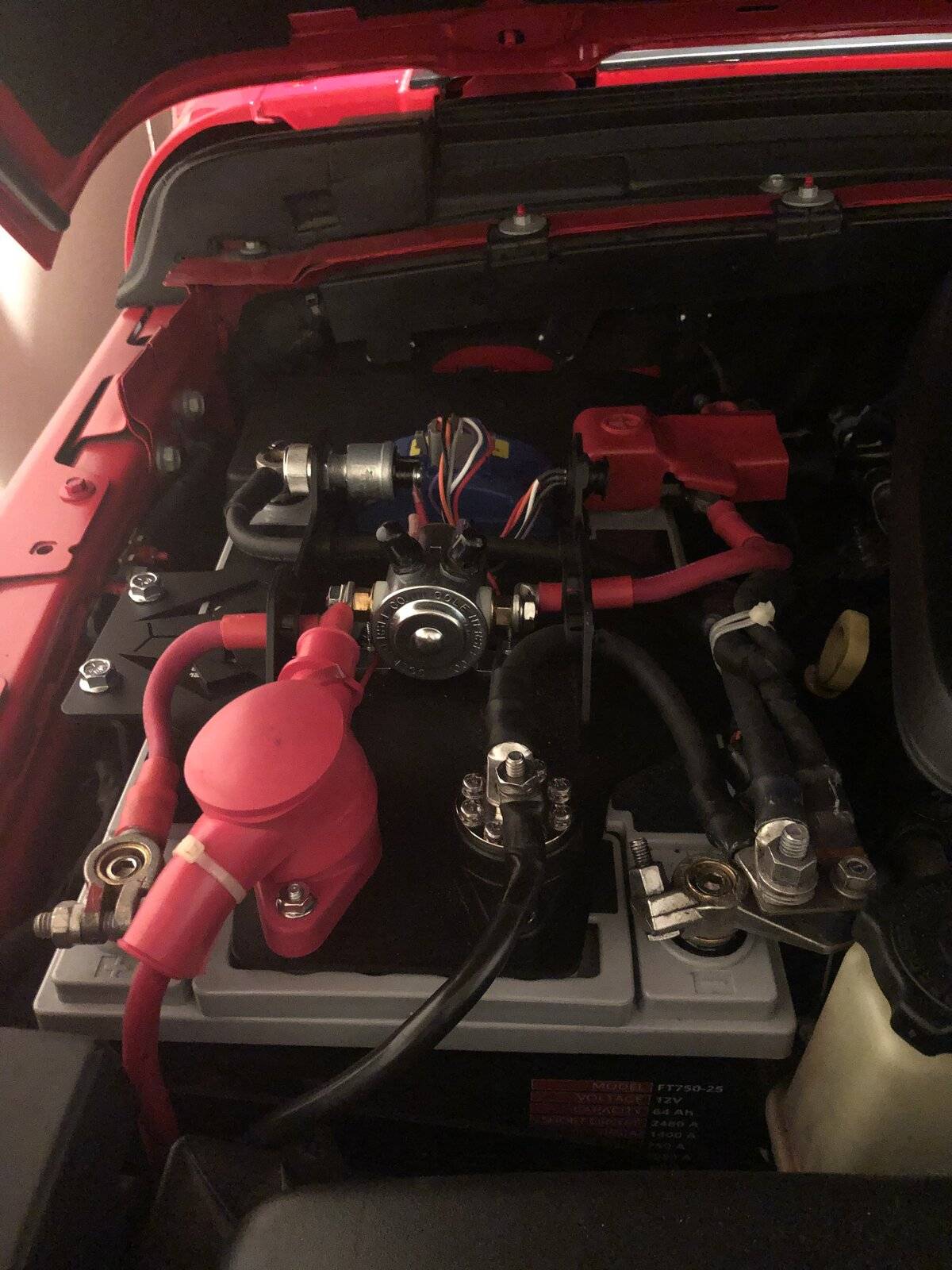

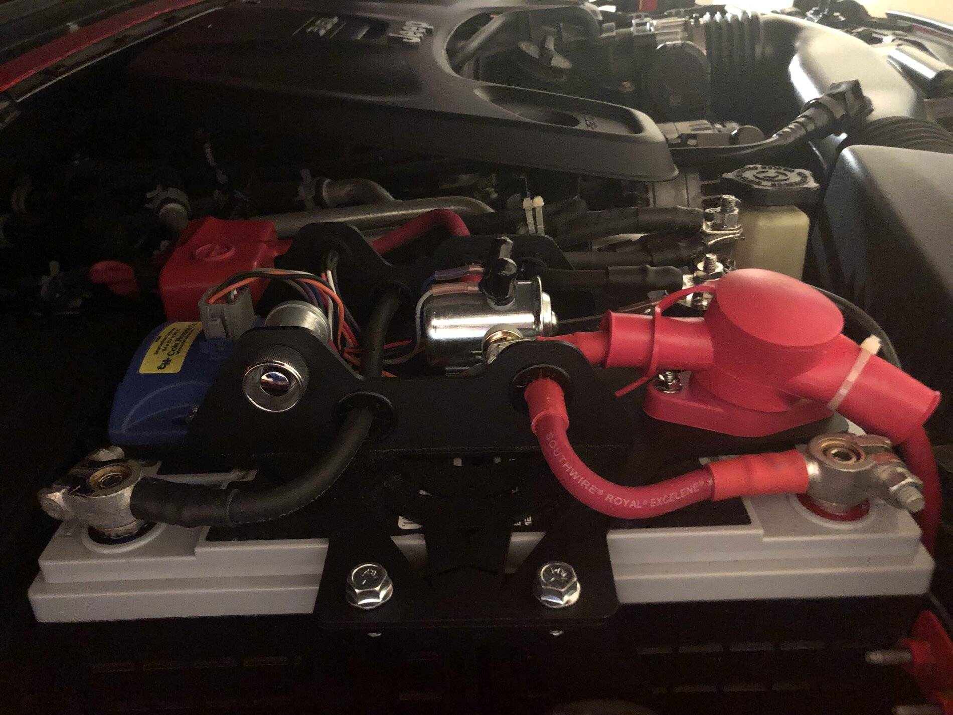

@willcasp i went with the Genesis system and chose two Full River 750 batteries, this system suits my power needs and so far has bailed me out of a no start situation once and it was my fault but glad it was there.
You can read about it here https://www.genesisoffroad.com/ It’s not as cost effective as a simple fused jumper but you basically remove the ESS battery and original battery tray and battery then and connect everything back with new batteries ( Factory ones can’t be used )and Shane and his group with Genesis Offroad make the kit pretty simple but I was not comfortable pulling the PDC to get to the ESS battery out but you have to remove it to get the tray out so I had my favorite offroad shop here in Houston do the work for me and also had some other things done.
The system consists of a new battery tray and then two group 25 batteries that you choose and then a completed top tray that is preassembled that goes on top and it consists of a Cole Hersery smart relay and heavy duty solenoid and boost button, I won’t bore you with how it all works but Mike at Genesis and I have exchanged lots of info on design and correct operation as I had some initial concerns on the power draw of the solenoid and relay.
Heres my setup and it’s been working 100% with zero issues and the JL smart charging system is working as designed, I was doing weekly charges as I had concerns on the batteries being pulled down but now I only charge/recondition bi-weekly or if it’s going to be parked for 4-5 days and my voltage metered directly at the batteries with them isolated has never been less then 12.6 but be advised that with this system ESS becomes somewhat inoperable after (6) consecutive cycles and won’t reset until you cycle the ignition, this is the fault of the JL programming because if it sees the same voltage (6) times in a row during ESS events it assumes there’s a problem so it disables ESS but I dislike ESS and run a SSS mod to disable it so I never see this error but have tested it several times
